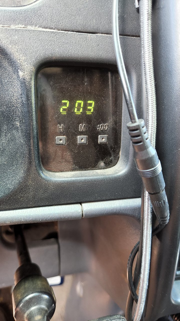

    Like many that I have read about here, my clock mostly has not worked - displayed. Now the weird thing is, lately, it has mostly worked. At the time, the electrical change was wiring up my wireless, backup camera and monitor; and maybe changing the license plate light wiring for the @4xinnovations bumper.
    Will enjoy while it lasts. :D

    Have you ever had it out? Jiggle the wiring connector?
    I had to buy an assembly from eBay finally because I couldn't stand not having a clock in the truck somewhere, and haven't had any issues other than it resetting every so often when the battery dips.

    I haven't, probably should check that. Thanks!

    No affiliation, but I removed my clock that was experiencing the same symptoms and sent it to a gentleman on eBay who repairs them for $16.50. He repaired mine in 2019 and it has been working great ever since. The repair comes with a lifetime warrantee. If you haven't already done it, the clock is very easy to remove. Turnaround time was very quick.
