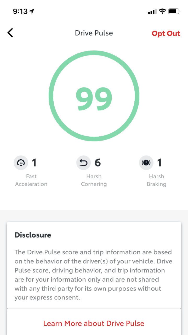

    Check out my driver score. Yeah I drive like an old woman
