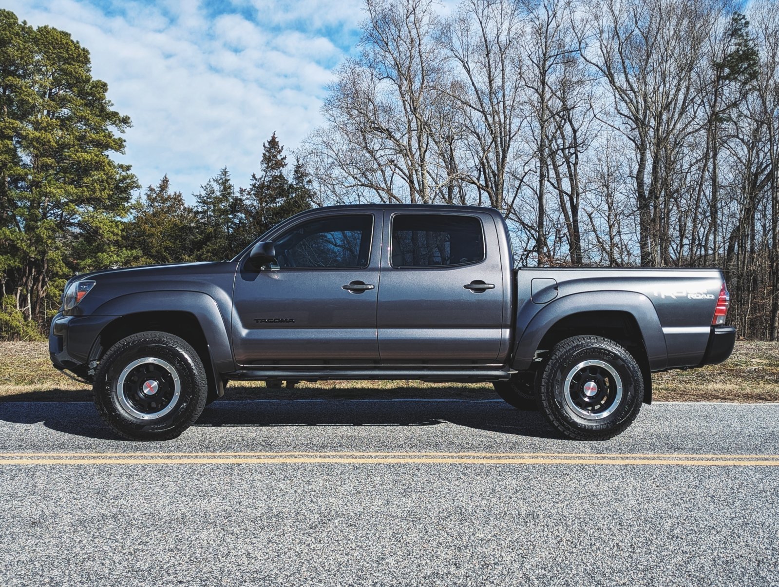

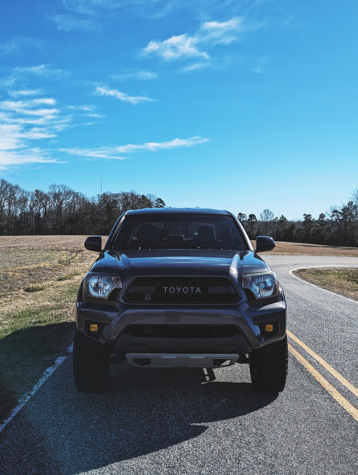

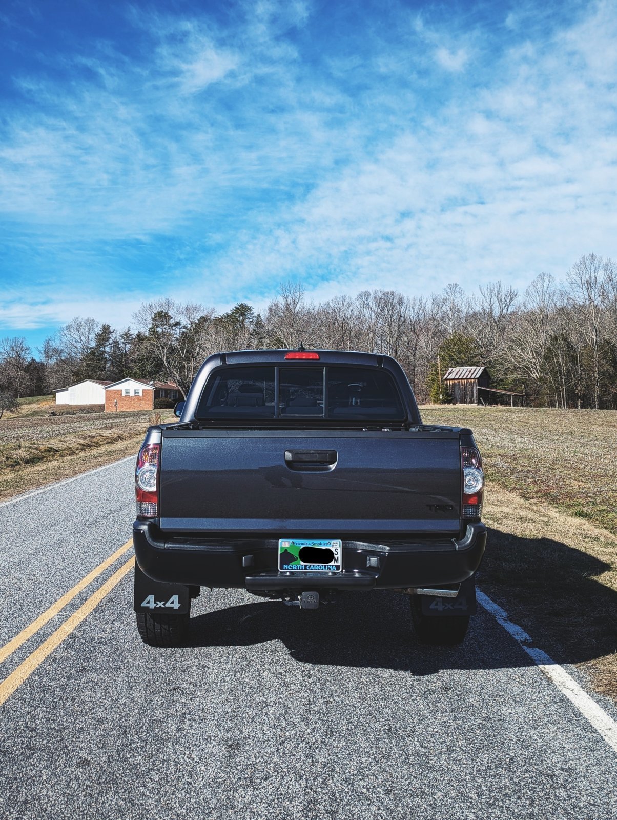

    Attempting to upload some recent pics from my phone. Hopefully the resolution comes thru well.
    131k miles, still happy.
    New Yokohama Geolander G015 tires in LT265/75/16. My new favorite All-Terrain. Superb road manners and wet weather traction, as well as one of the lightest weight 10 ply tires in this size. I'd love to write a more comprehensive review on these eventually because I feel like these tires often get over looked.
