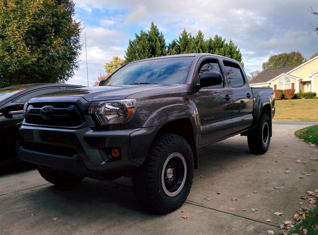

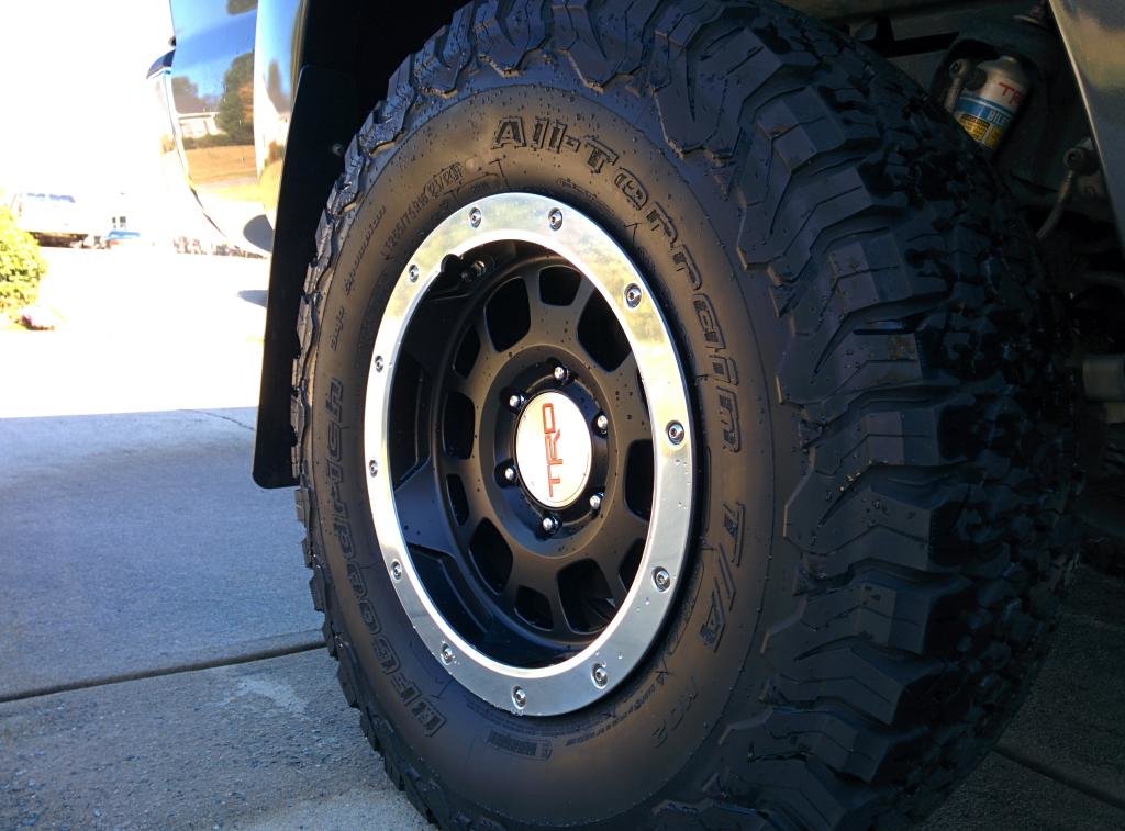

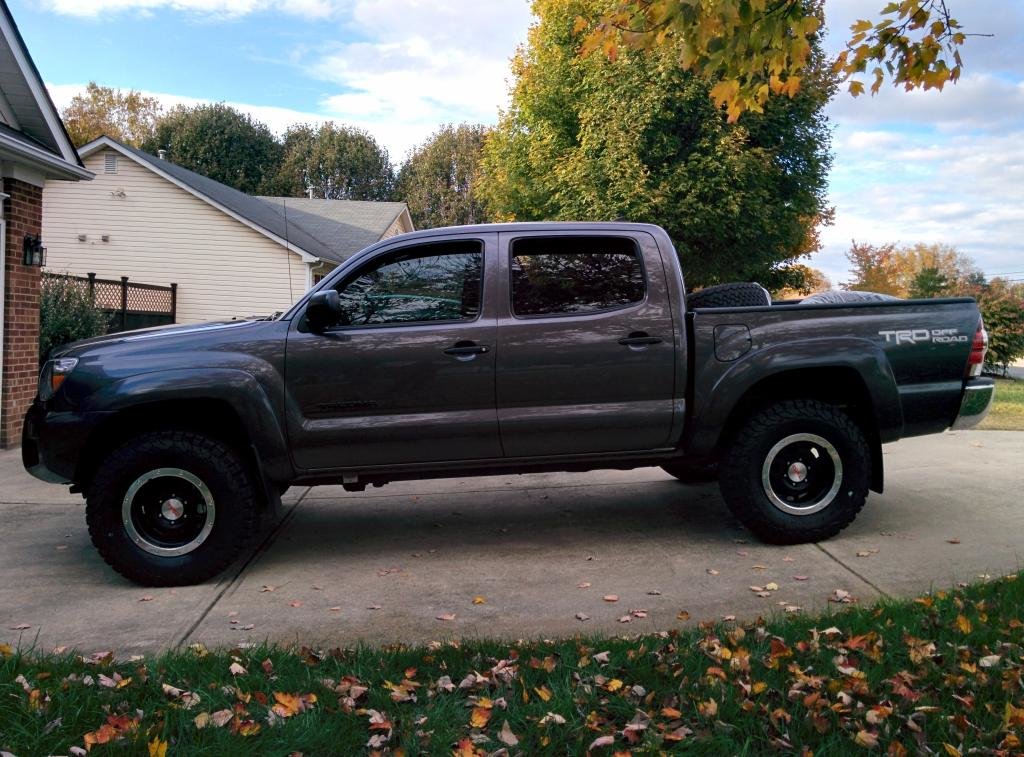

    Here's a few quick pics from after I had my new tires installed. BFG All Terrain TA KO2's in 265/75/16

    Did those new tires change your MPG?

    Great looking truck! I might have to copy a few things off you.
    Where did you get the color matched grill from? This chrome one looks like crap on my MGM truck

    Yeah, 3-4 mpg's maybe. I haven't really been keeping track. I know I increased roughly 15lbs per corner going to these tires from my stock Rugged Trails. The KO2's in this size are only available in Load E.
    Thanks!
    I got the grill from these guys, best price I found.
    http://parts.camelbacktoyota.com/partlocator/index.cfm?siteid=214329

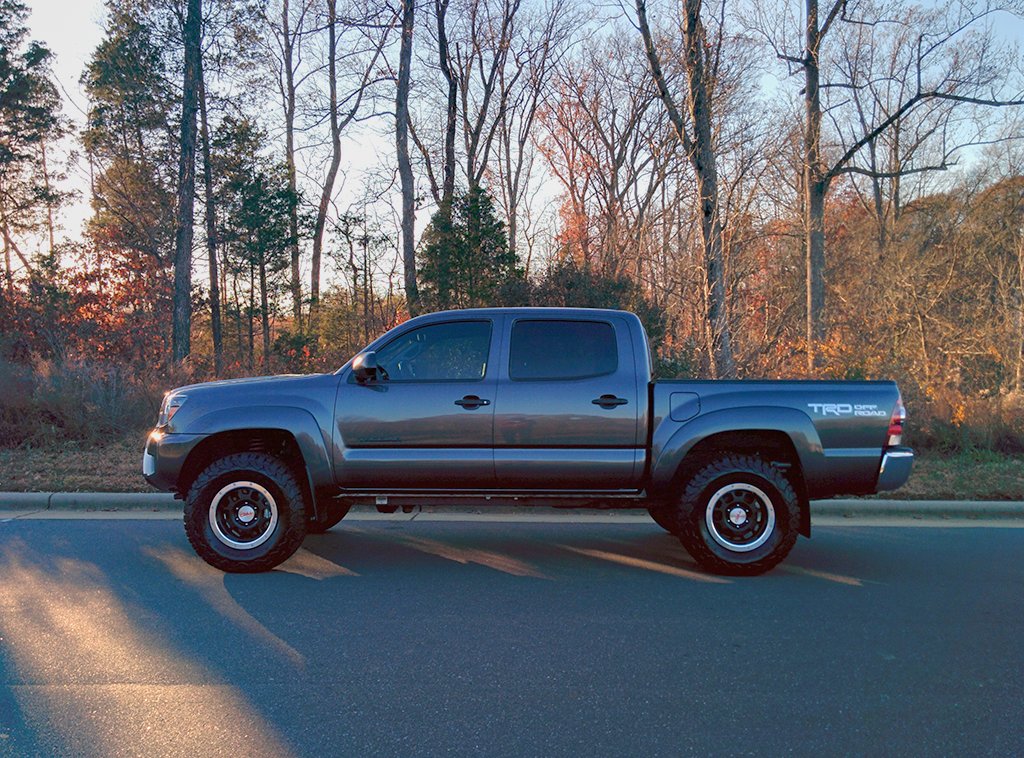

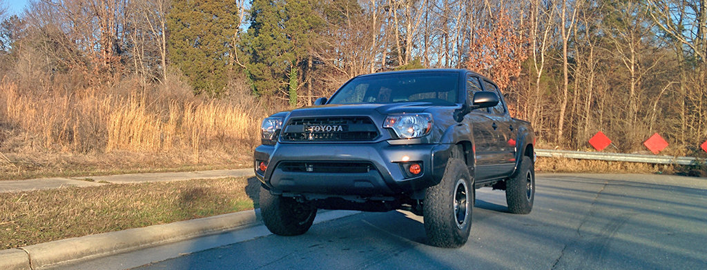

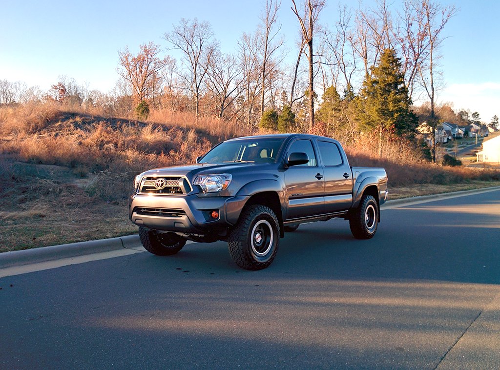

    Washed everything up real good and went up the road for a couple pics. Sun was in the shot on a few of them.

    Looks great! Do the TRD beadlock wheels have a different offset than factory TRD? You don't have spacers do you? They seem to sit out just the way I like.

    Thanks! No spacers here. Not sure if offset's different than the stock wheels.
    I checked Ebay real quick and found the TRD beadlock's are 16x7.5 10mm offset, while the stock TRD Offroad's are 16x7 30mm offset.

    any trimming needed to keep the bigger tires from rubbing? thanks

    Stock wheels are 5.5" backspace, I think FJ cruiser and TRD wheels like yours are 5" backspace.

    Thanks! No trimming. I only occasionally touch the inside of the front mud flaps if I'm turning almost full lock at speed and hit a bump.

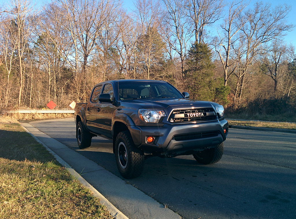

    Did you install a Pro grille yet?

    Yeah, Just haven't gotten around to taking any good pics.
    Got this one from the other night when the fiance and I were screwin' around at a car meet.

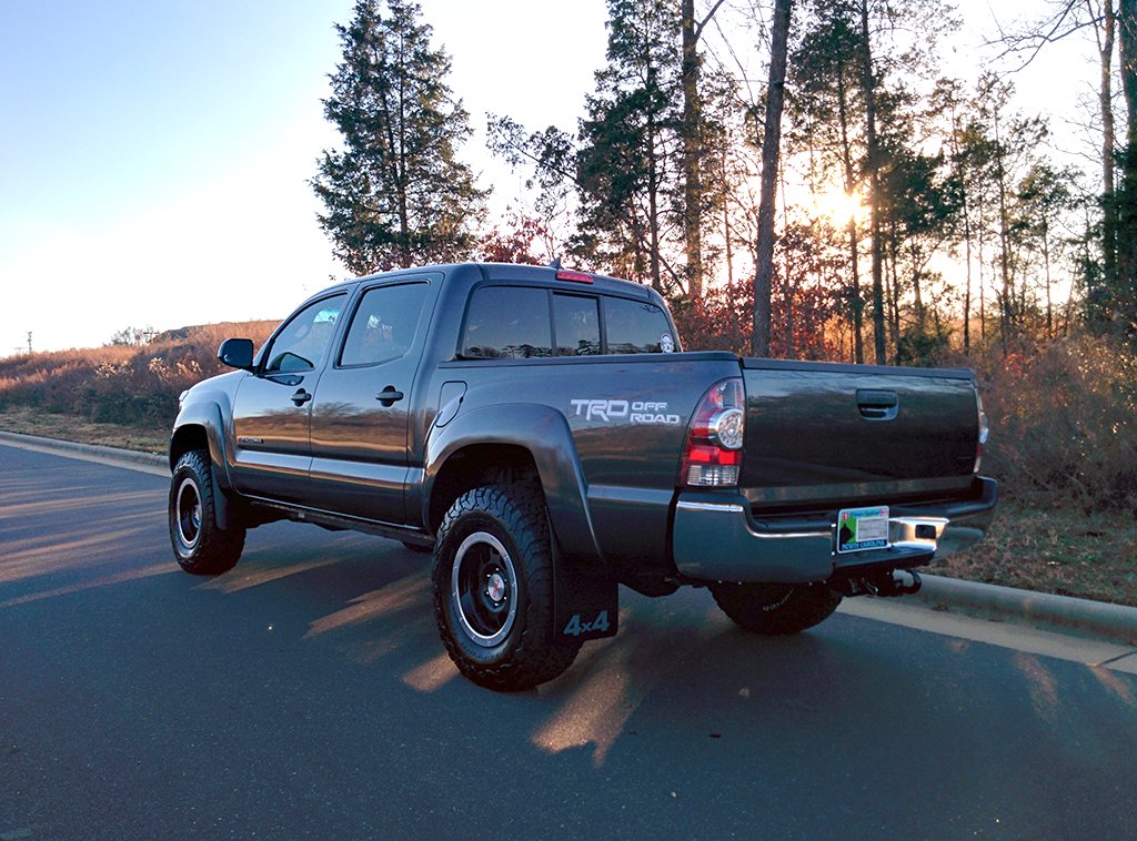

    Snapped a few pics yesterday after a wash. They aren't the best. By the time I get done washing it the sun's starting to set.

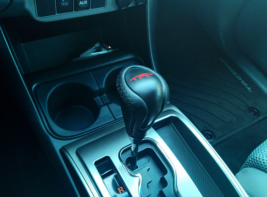

    TRD Shift Knob the fiance got me for a bday present
