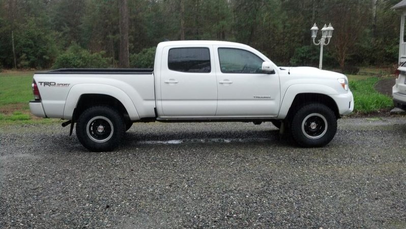

    Thank you all for your help and inspiration. I got her done today and it is perfect. Next up TRD Pro Grill, Black badges and if I can get the courage BHLM. How easy or hard is the grill insert? I am thinking that a may plan to do both the BHLM and that at the same time.

    The grill insert isn't hard, just takes patience and some clever use of tools for the clips.

    On another note I have taken a measurement on my lift now that it has settled and I am not happy with the rake. The front is coming in around 22 from center hub to fender the rear is 24. I am debating o having them add the 1/2 spacer to my driver side and put the 1/4 on passenger side in hopes of getting the extra 1/2 inch or getting a 1 inch block for the rear.

    Give it all some more time to settle out.
    You did the AAL in the rear right? Did you remove your overload leaf? If so, you can add that back into the leaf pack for some extra height. Being a long bed you have a little more weight back there than I do.

    What are your measurements upfront , center hub to fender?

    I am 22 inch center hub to fender in the front. The rear is a 1 1/2 block and measures 24 inch center hub to fender. I don't think blocks settle out. I sure hope the front does not settle down much more.

    I just quickly measured mine. Front center of hub to fender is about 22 inches, with the drivers side maybe 1/8 inch lower than passenger.
    Rear measures about 22.5 inches center hub to fender on drivers side and about 22.75 on passenger with a mostly full tank of gas.

    Thanks for the measurements. Now I need to decide what to do to adjust this rake a bit. They are offering to make the adjustments. I think I may put 1/4 inch spacer on both sides to net extra 1/2 and change 1 1/2 inch block to 1 inch. This morning I had my original tires/wheels in the bed and it sat down 1 inch and it did look much better at 23 inches. What other options is there just to net 1 inch up from stock in the rear besides blocks?

    You can do an AAL like I did, which settles a little over time
