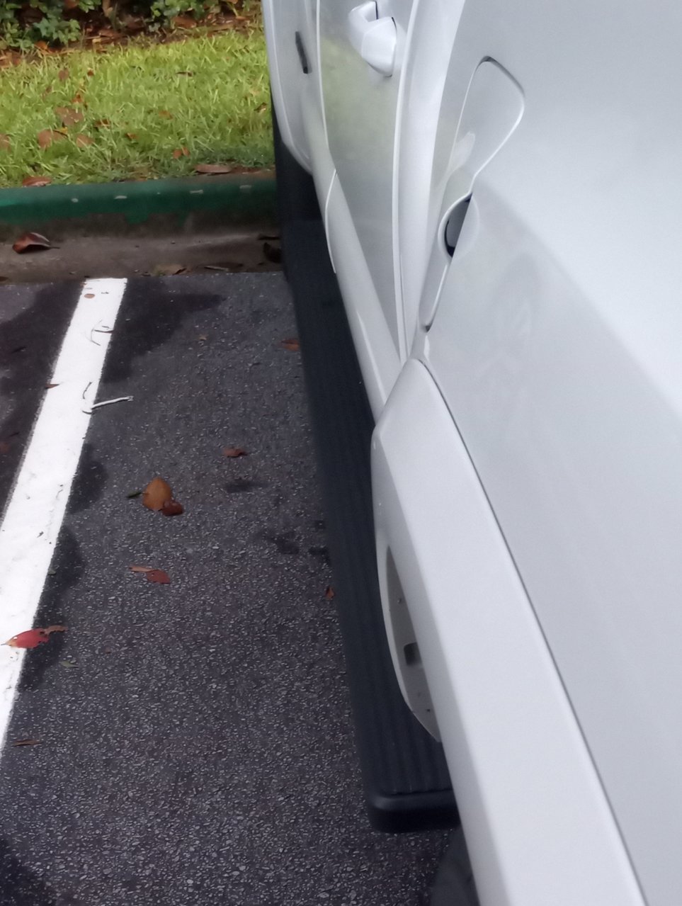

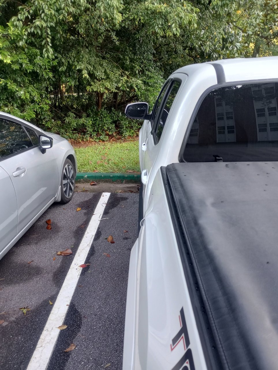

    They need to extend past the midline (fattest part) of the door. Taco doors are not flat, neither are other cars'. Sliders or running boards need to extend far enough out to stop the bottom of their door before middle of their door hits yours.
    )_( kinda like that.
    Pics added

    Good pics! Thanks

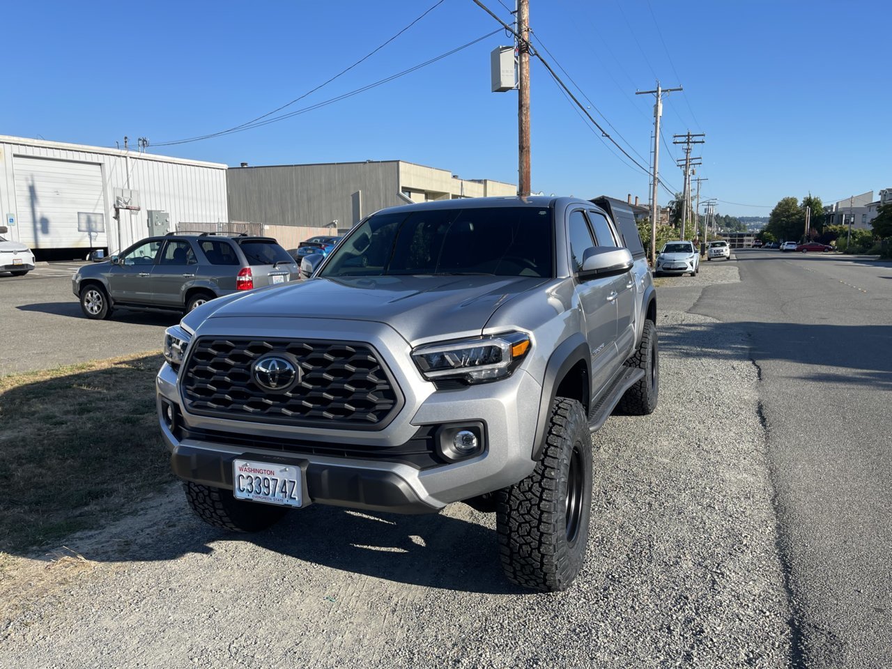

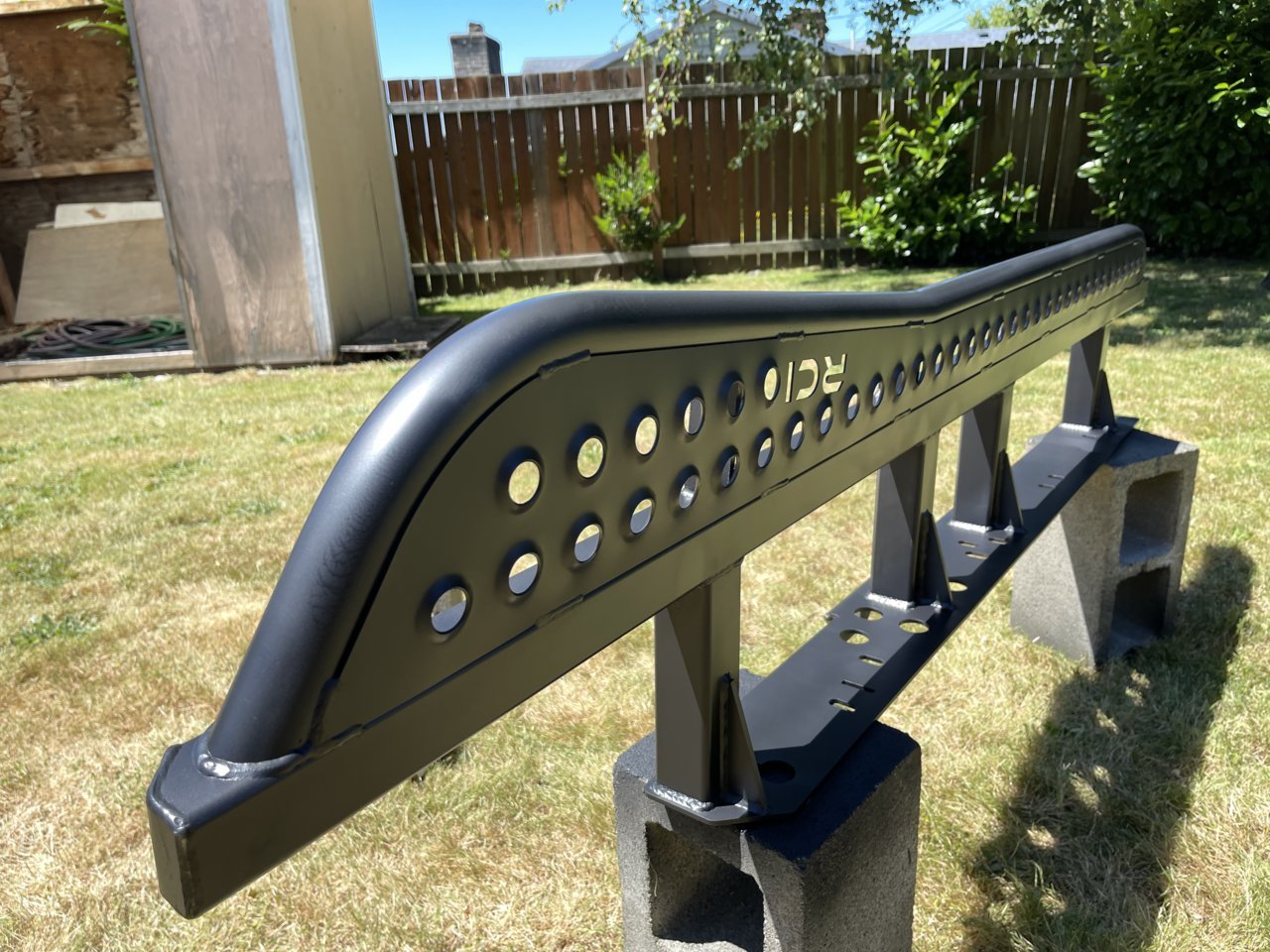

    I got, and would advise getting some 5 degree RCI sliders. Don’t PC sliders. That’s a waste of money and PC won’t touch up well after it gets used and scraped up. I just cleaned them up and used Steel It paint. No primer needed. If you need to touch it up, just sand down the area, and hit it with a few coats of Steel It. It’s not super cheap, but neither is your Tacoma or door dings.

    X2 on the Steel-It paint or your rattle can of choice. The powder coating just won’t hold up in this area and will look like shit if you try and touch them up.

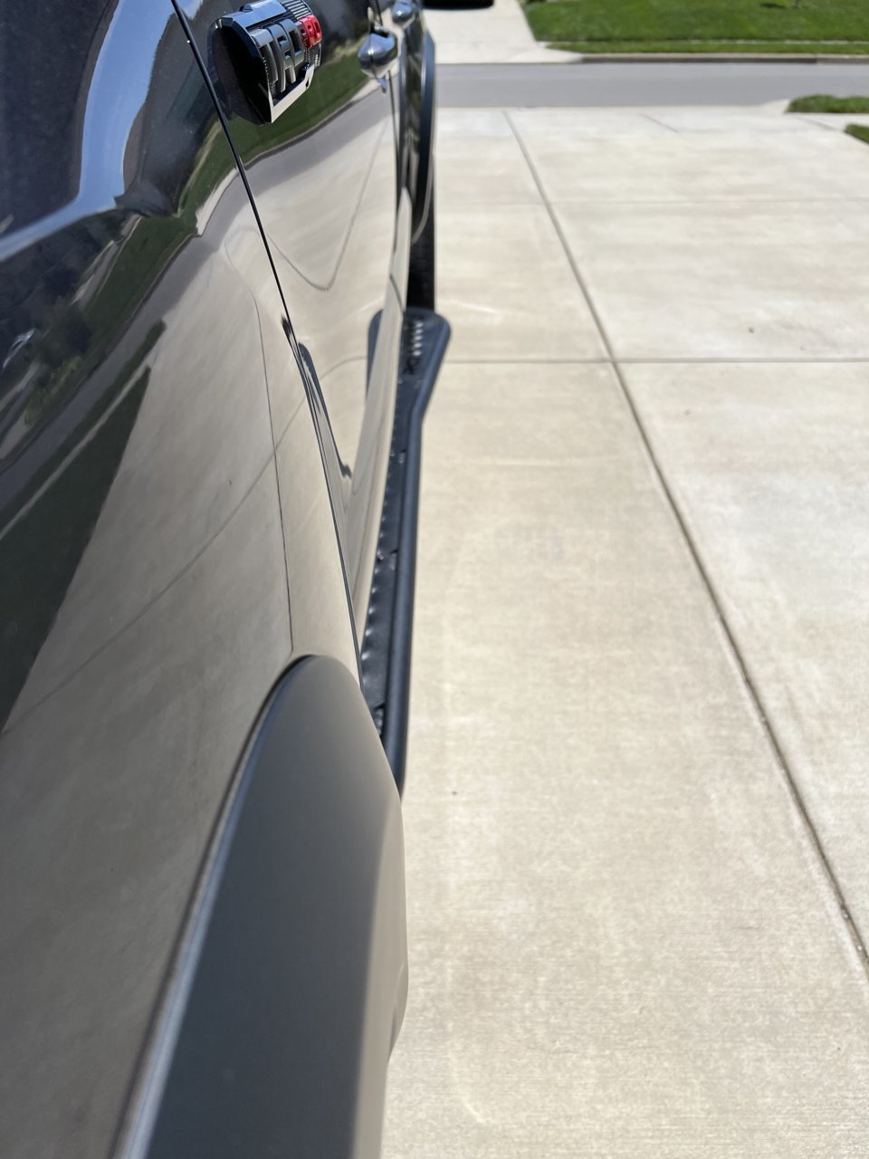

    I agree with having some good sliders. I think they work well against ‘neighbor doors’ in parking lots and when you are out on trails. 20230704_075213_Original.jpg
