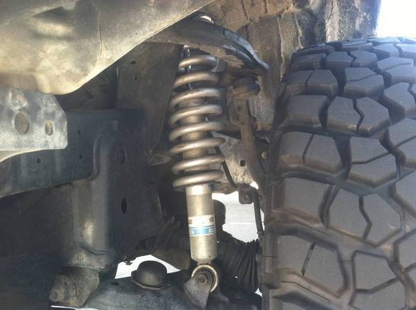

    A much better idea if your just looking for a leveling kit is to buy bilstein 5100 shocks for the front. They have height adjustments for 0" of lift 1.25 and 2.5.
    Here is a picture of my truck with a 3 inch lift all the way around and 31" tires. It's a bit much, but looks good with the 33s I have now

    And finally, this was my truck on 31s and the bilstein 5100s I mentioned

    Ok so with the bilstein 5100's in the front that gives to 2.5? What did you do in t he back? And did you run 31's the whole time or could you fit anything bigger under there?

    I could have fit slightly bigger tires but I don't know by now much. For the Rear I actually bought a new leaf pack.
    There's a ton of options for the rear though. You could buy lift shackles, blocks, add a leaf and so on. A set of AALs isn't too expensive and is a good option.
