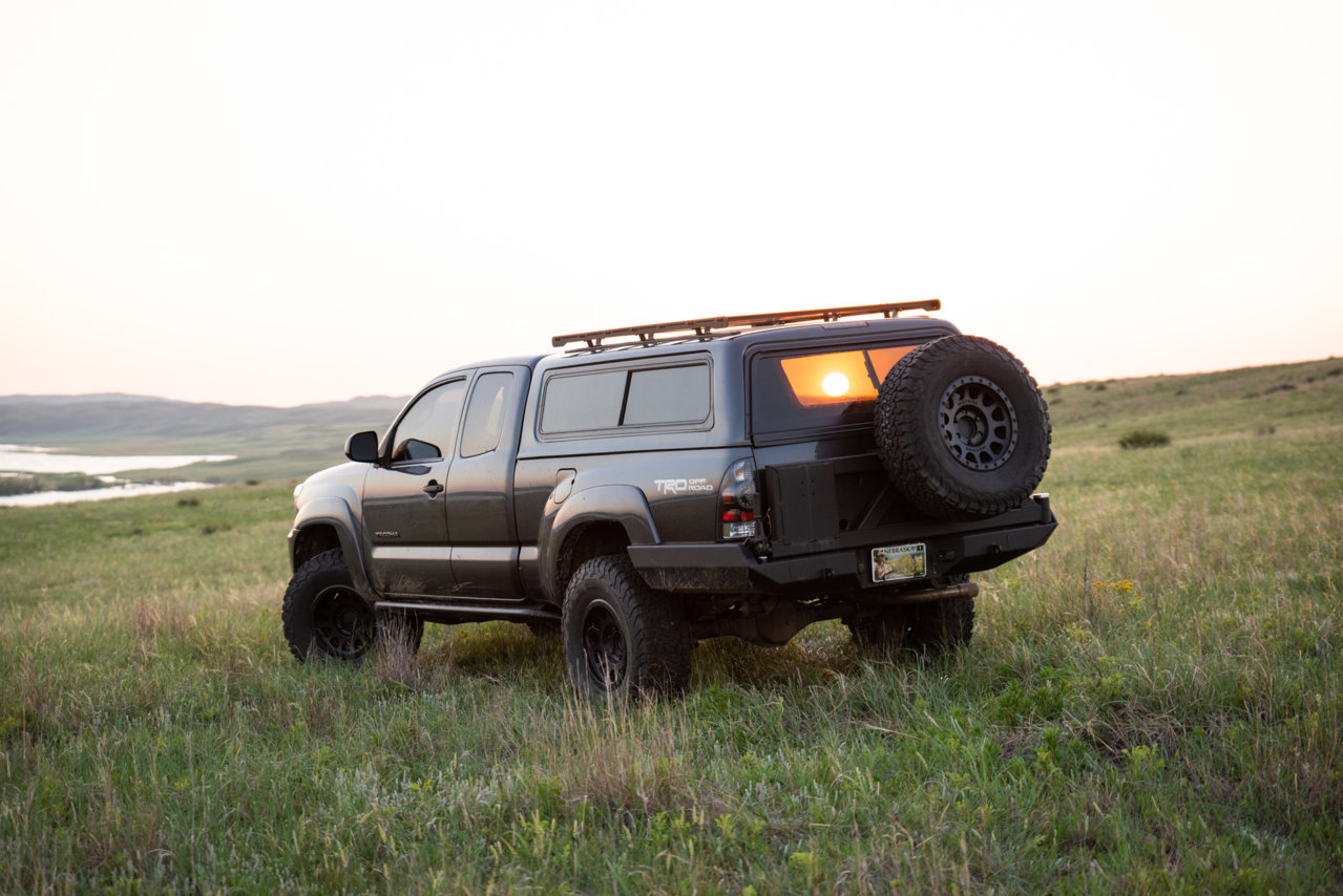

    Random photo from Weston Pass in CO earlier this year. I'm curious what this view looks like now that a fire went through the area.
    Still waiting on the front bumper.

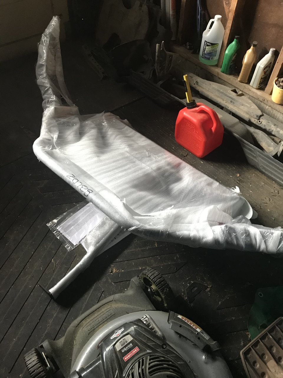

    BraskaTaco

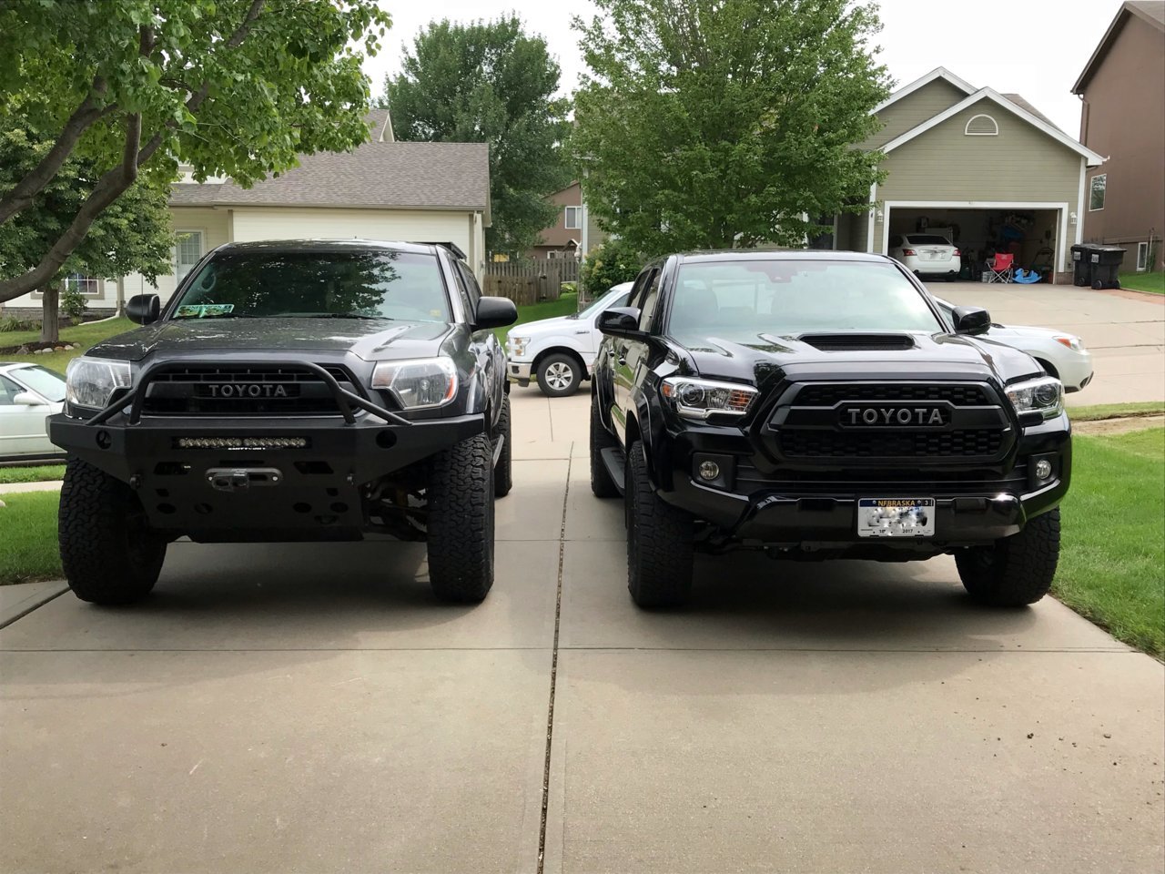

    It’s on!
    Quick cellphone shot parked next to my buddy's 3rd gen.
    Super happy with the way the bumper looks and how clean it is. I was a little surprised to see no bracing or gussets in the wings and hardly any in the body, unlike what I've seen posted by Demello of their bumpers. Thankfully I'm not doing wheeling that will really bang it up, but I would put this into consideration if I were.
    The bolts on the factory sway bar mounts gave us issues. The welded nut inside the frame broke on both bolts on one side. We were able to fish one out and use a long socket extension to tighten it, but couldn't get the other. Hopefully this won't cause issues when winching, and doesn't indicate my frame is already dying inside :anonymous:.
    The hardware that comes with the Smittybilt X2O will not fit the Factor55 fairlead or the bumper. We had to drill out the holes on the bumper and fairlead just a bit and run to the hardware store to get longer bolts (We realized the bolts weren't long enough after we had already drilled). No biggy.
    My Squadron Sports aren't installed yet since one of the mounts that came with the OEM kit seized up. We tried everything and couldn't get the bolts out. My buddy is going to work on it this week and try countersinking new holes. Hopefully it's salvageable and I don't need to buy a new one.
    I was going to mount my license plate on the bumper but it looks like there's no way to access that inner portion of the bumper from the backside when the bumper is mounted. I don't really want to have to remove the bumper just to change the plate in the future, if needed, so I'm gonna leave it off. There might be another solution I'm not thinking of like mounting a holder of some kind there.
    All in all it was a nice way to spend a Saturday. Not sure what's next! :D

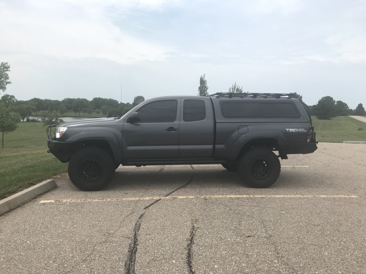

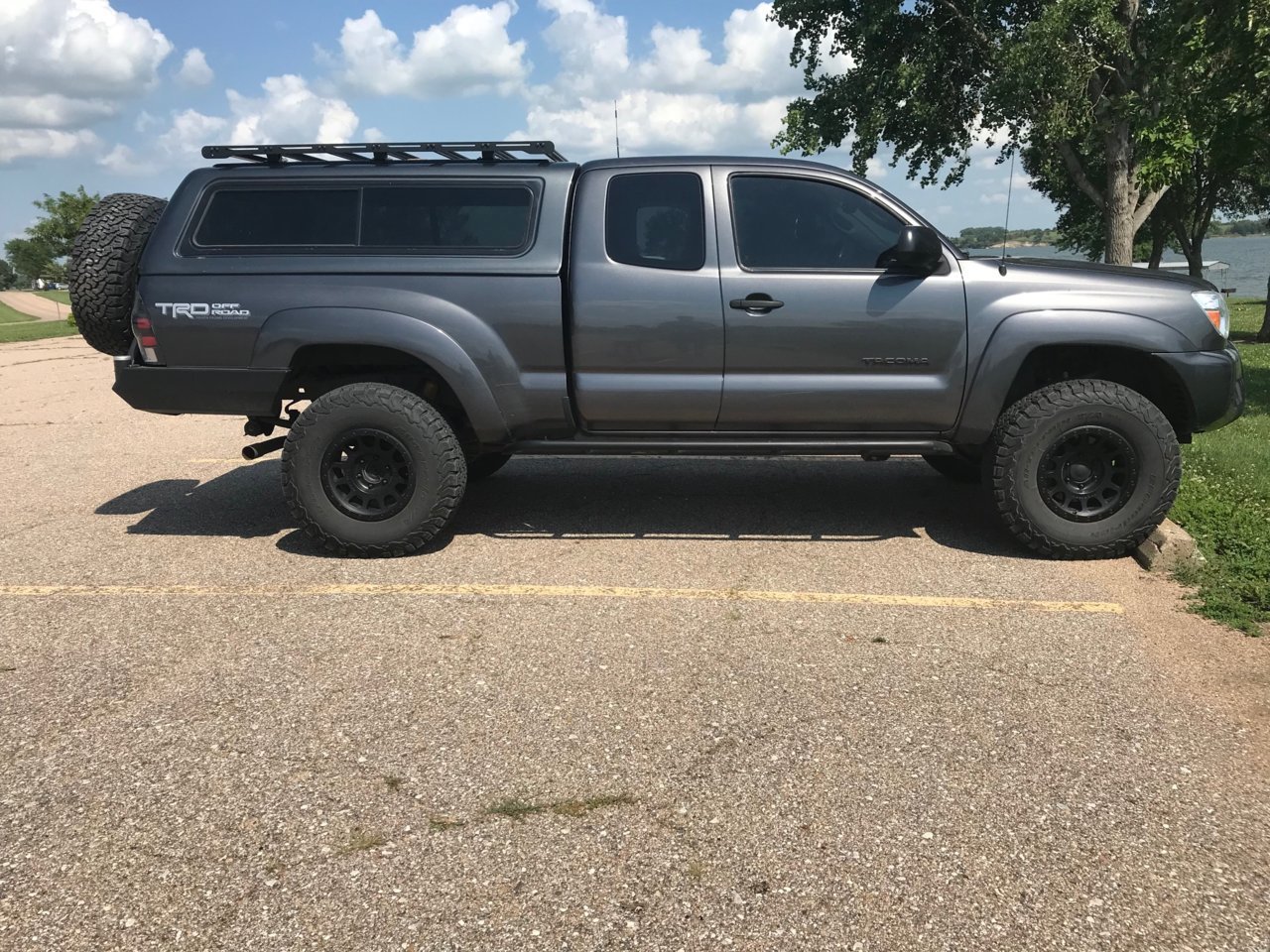

    They don’t seem to have lowered all that much. My driver’s side has always been a bit lower even with a 1/4” spacer, here is how it sits from both sides now:
    I can’t decide if I want to throw on a 1/2” and 1/4” spacer or just leave it for now.
    (I think my iphone lens fogged up from the humidity, sorry for the terrible pics.)
    If you’re going with an ARB bumper, I think you’ll probably want 886’s. That bumper is ~100 lbs more than my aluminum pelfreybilt if I remember right.

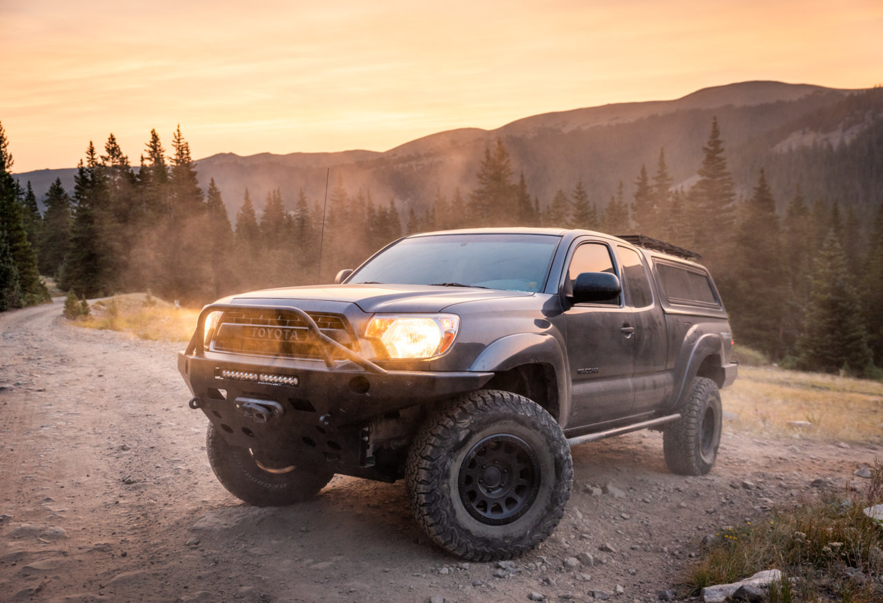

    I’ll have more to share but here’s a first edit from this last weekend in Colorado.

    Oldbusparts Well-Known Member

    Thanks dude. I’m definitely happy with it and the bumper already proved useful a couple times when scraping over rocks. I’ll dump a bunch of photos sometime later in the week.
