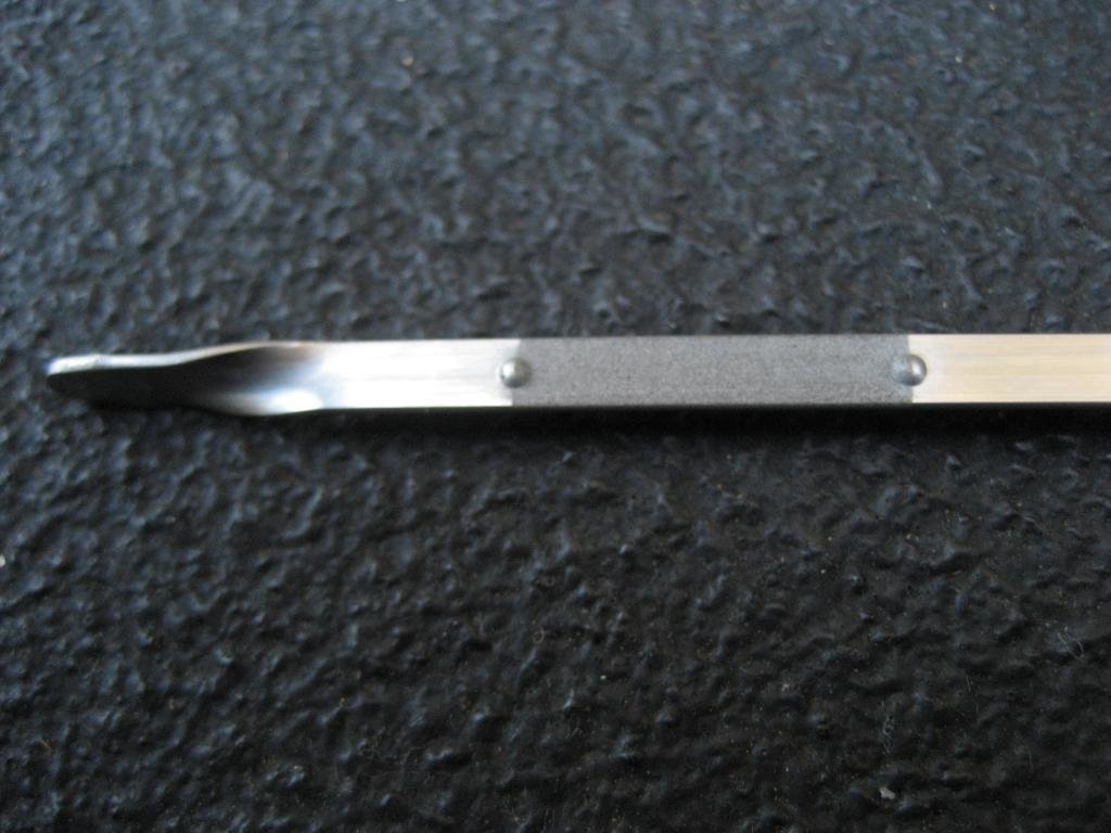

    I taped mine off and sandblasted the area between the holes. I'll post a pic of it tomorrow. :)

    Takes about 10 minutes to tape it off, sandblast the area between the dots, and clean it. :thumbsup:
    I NEVER wonder what the oil level is. :)

    Thanks for the picture! I have been struggling with my wife's 07 Camry dipstick, and now my Tacoma dipstick is just as bad. Don't have a sandblaster, so I'll try the sandpaper method.
    Anyone have an idea how much different it will read between a hot and cold engine? Maybe someone with a sandblasted dipstick can check for us? :D
