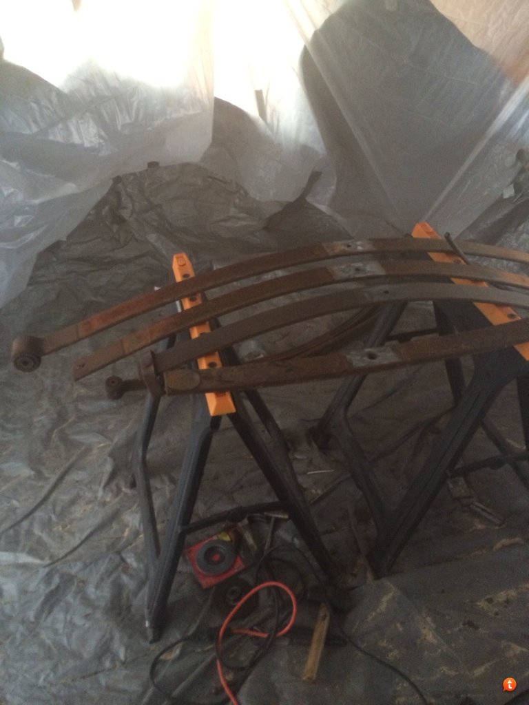

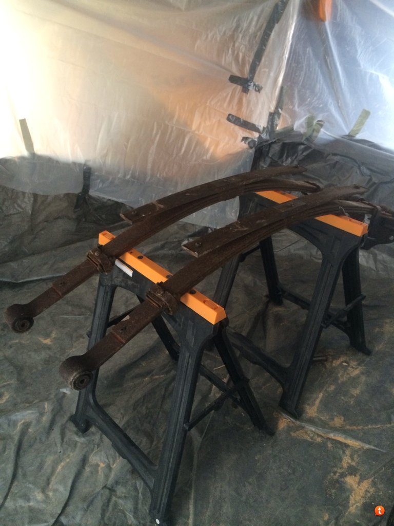

    Ugh, cleaning up chevy springs is messy business!
    Rust grinds off fairly easily with a wire wheel, gonna go at it with a flap disc later this week. Figure I can take my time refurbishing these bad boys because I can't put them in until I'm riding the motorcycle as primary transportation.

    What made you decide to go with chevy springs? Price?
    I saw a thread a long time ago on them and believed people were doing it for towing right?

    Chevy 63" springs flex pretty well for the price. Plus side is you can put more weight in the back of your truck without it squatting as much.

    Yes, mostly price. I got them for $60 which is hard to beat, granted there us other cost that will be associated with them (bushings, center pins, hangers, etc.) but it should still be much less than say a deaver leaf pack.
    The chevy 63" springs flex like crazy because they're so long, supposed to ride excellent on the street, and can handle a lot of weight as they're from a half ton truck.

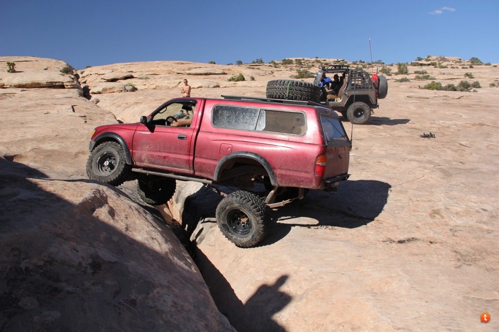

    Here is mine on the golden crack in Moab. ga3etera_16e55e2fd7d2853fd489e8f641d1602f22bb2587.jpg

    Sweet :). My springs are softening up real nice like with the extra weight I have been adding. I might take on this project in the future. You should load the bed a lot and find out how much they hold.
