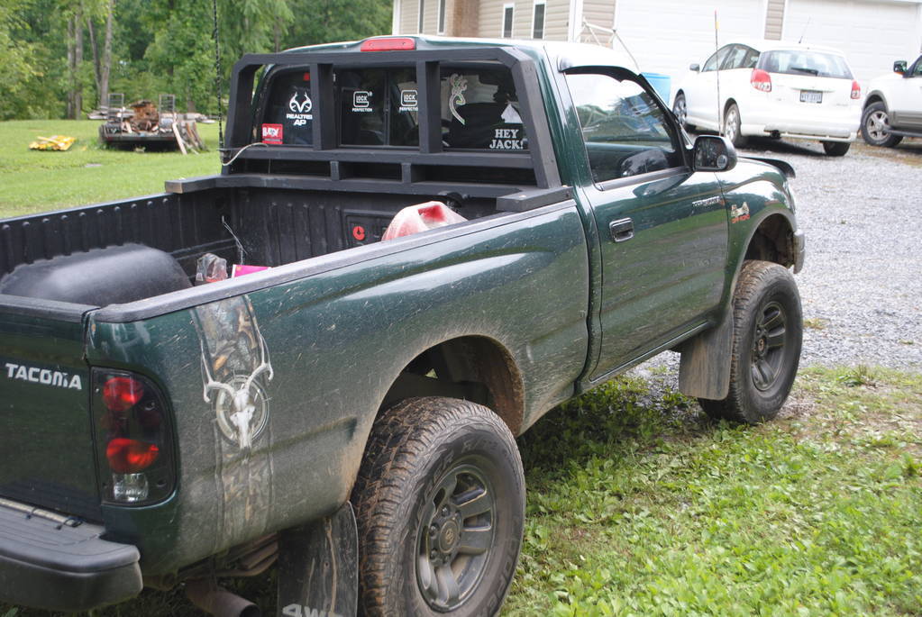

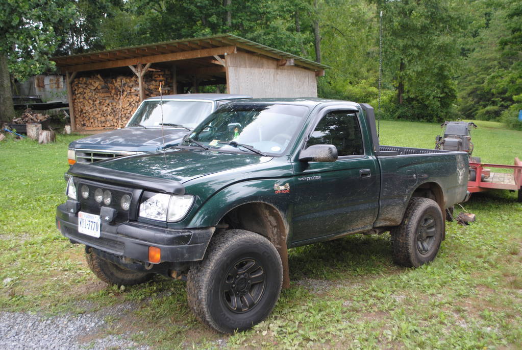

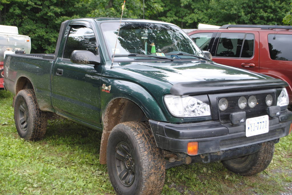

    My 2000 2.7L single cab taco.
    2.5 DAYSTAR suspension and shackle lift
    265/75/r15 Cooper At3 tires
    rim spacers
    stock rims painted black with gold trim
    Deck plate mod
    Grille Mod with lights
    TRimmed front bumper
    Custom headache rack Made from 2x4's

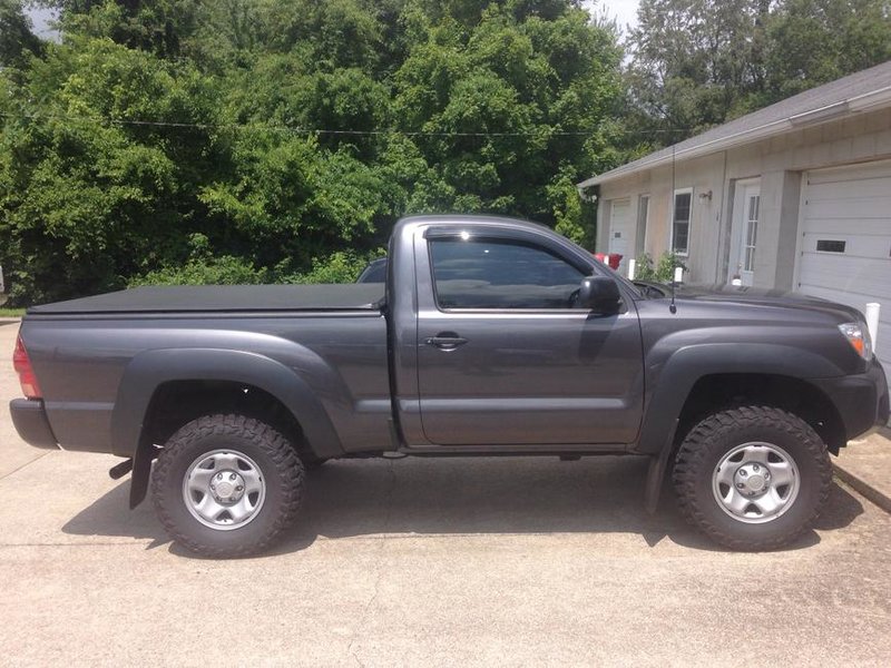

    Got my lift installed last night. 5100s set at 2.5 up front, 1.5 AAL out back. Just need an alignment. I don't think it looks hugely different but it feels huge!

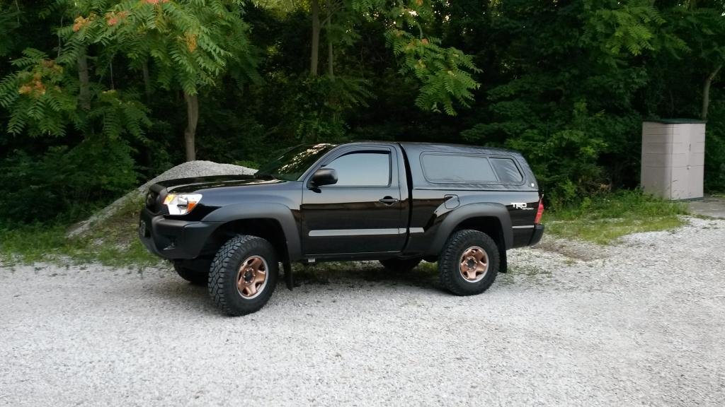

    I'm thinking about a cap, what are your guys thoughts? I like that I could have secure storage for some stuff and be able to mount things out of the weather.

    Looks great man

    Why not run it at the highest?

    Because with stock UCAs you won't be able to get caster right without trashing camber settings. Some LR UCAs will be the cheapest route to some good aftermarket UCAs that will allow you to get enough caster back so it doesn't drive all twitchy and not wear tires from camber being off. Caster off will not wear tires but will piss you off the way it handles. Mine are set at 1.75" and barely has enough caster to not be completely annoying but is still noticable. I have some fresh LR UCAs fixin to go on and some sub 5k 4 leaf packs to replace the weak ass 3s out back. Still staying at 1.75 tho, not going bigger on tires this time. 31s are big enough.

    I had my billies at 2.5 on my other reg cab and the guy was able to align it perfectly

    What shell is that? It matches perfectly awesome truck. Also how did you do the wheels?

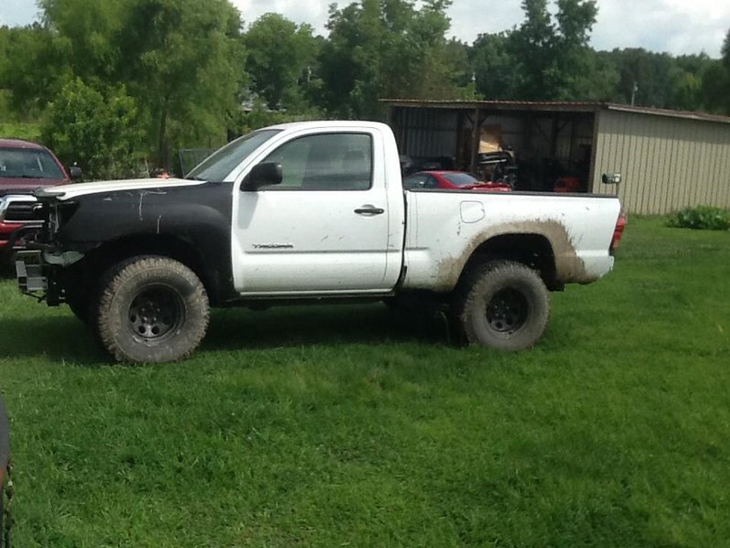

    Here is my tacoma that i pay 1750 for it only has 40,000 miles on it what do you think guys

    looks like the frame or bed or cab are tweaked....body line looks off, it needs front end parts, paint etc....may have been a total?! or theft recovery?! or it needs a motor?! lol....and its a 5 lugger

    sweet deal though
