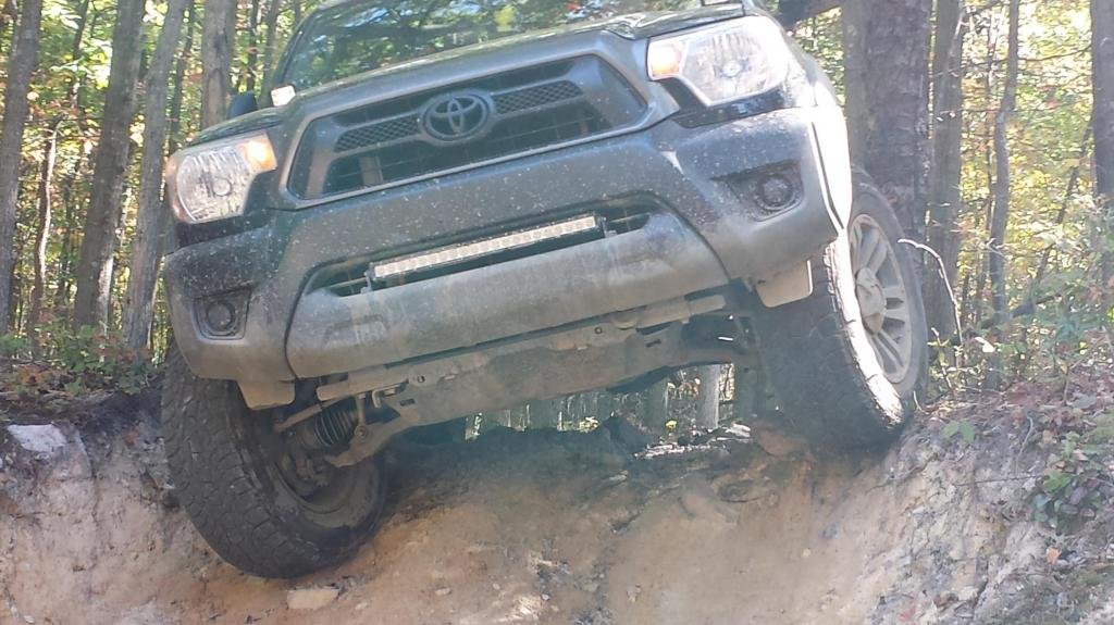

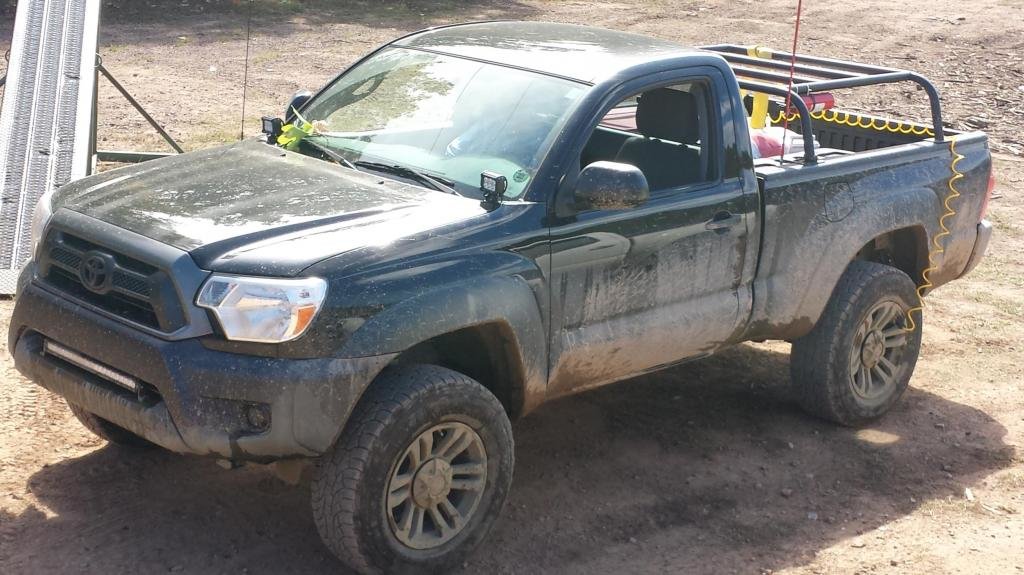

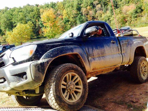

    a little single cab porn for you guys from big dogs

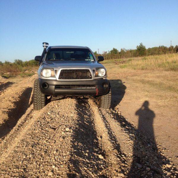

    I pulled this 20 feet lol.

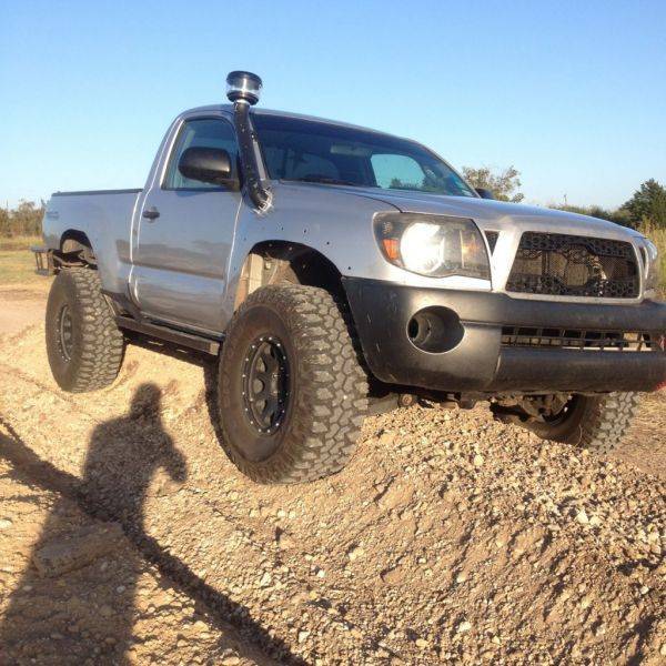

    I was wondering when I was going to see a snorkel on that thing... looks good!!!

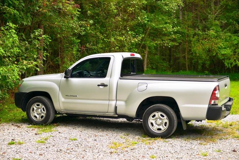

    My first Tacoma. 4 cylinder, 5 speed. It is very basic (only option being the rear slide window). It is used as a DD to and from work each day. Keeps the mileage off the fast cars...
