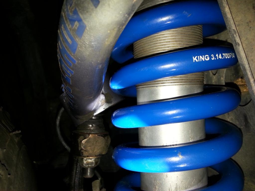

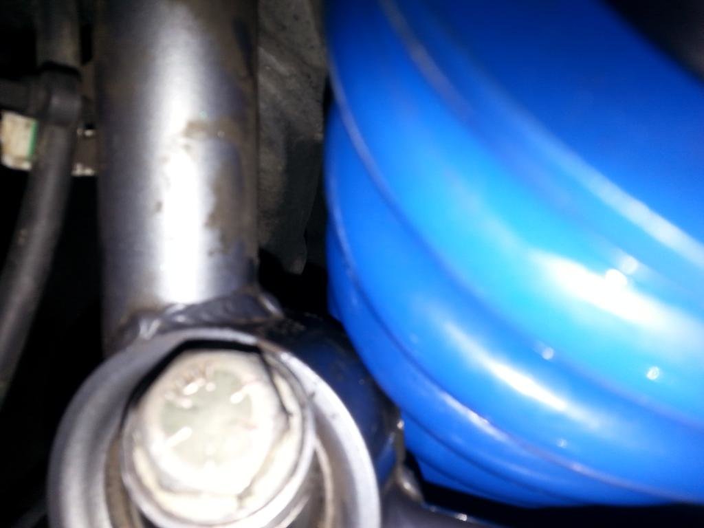

    try taking a little bit of preload out so the uniball cut droops between the two coils.

    There is no preload on it. The diameter of the springs is the same as the old ones. Thinking about doing a 180 on the coils.

    Had this issue when i was Mid travel. I did that too, turned the spring until clear. And if needed run limit straps. Yeah when I swap those springs for you I was like
    "damm these the right size they are huge" they were. I guess King upped the sizing on the springs.

    Fucking huge man. Spun them 180 and it worked out great just need an alignment now

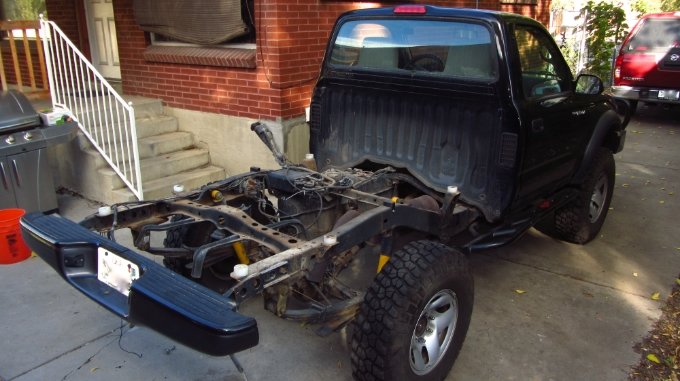

    So...what my truck looks like right now...
