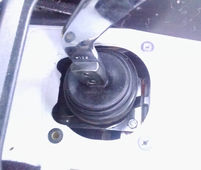

    I guess I get to update this post with more pics - since I had to fix a loose shifter today. I used blue Loctite when I assembled it, but discovered that I made a simple bonehead move and installed the Hurst lever opposite the serrations somehow. Dumb move and I'm sure that was the reason it loosened up. It went back together with red loctite this time just to be sure.

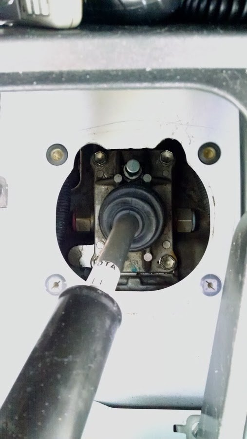

    So the above pic is the stock assembly with the boots removed and the body opened up a bit to access the stock mount bolts. This next pic is with the unit installed. Sorry, I didn't take it all apart for you guys...:rolleyes: Note that the base is steel and not as thick as the stock aluminum part, the installation instructions are clear in that you MUST use the supplied (shorter) bolts. You can just see the serrations I mentioned, the CORE part has matching serrations for a good solid grip - this time.

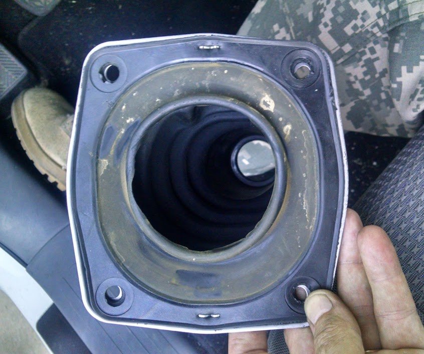

    This is the stock boot, modified in the alternate way so that it fits snugly over the CORE assembly.

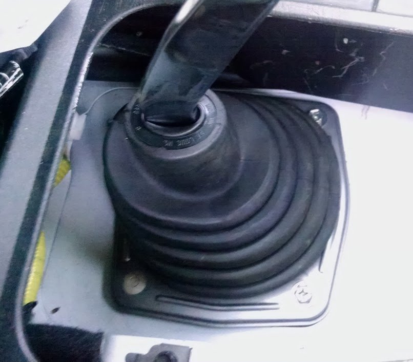

    Here is the boot installed, note the grommet CORE supplies to make it fit the Hurst lever.
