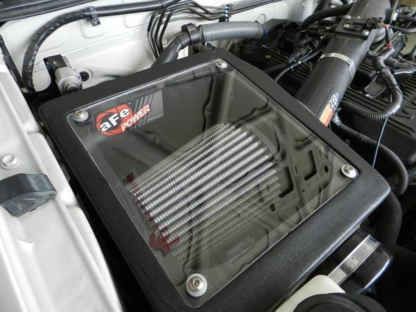

    Question! I am looking for a solution to my problem! Below is the volant CAI. Where is this sucking in air? Is it using the stock location?
    I am still unsure of the cause of my engines troubles but i do know that it has been starved of air due to sucking up dust from the stock location (even with the new liner). So the next truck part I am buying (other than the pricey cost of fixing my engine) is going to be a way to get clean air.
    I have two options.
    1.) snorkel (ugly but with pre-filter will keep the air clean)
    2.) CAI
    Obviously the snorkel is the better option but the CAI is low key and would keep my truck beautiful!

    A CAI is noisy, makes the truck slower -fact, and sucks up a lot of hot air from the engine unless you get one that routes in front of the radiator which then puts you at risk for dust, dirt, mud, etc.

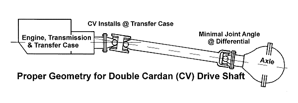

    Drive shaft slip yolk. Mine does the exact same thing. My plan is to have a custom shaft made with a cv joint and shim the pinion to point directly at the case...there are several threads about it...the single cabs are very sensitive to lift it seems. Search around you'll see...

    If I cared about noise I wouldnt have modded my truck so heavily :laugh:. I know they dampen the power but it is a small amount for what is gained. The snorkel is likely the winner but I want to cover all my options first.

    So 2nd gen regular cabs don't come with a double cardan drive shaft?

    Nope my '12 doesn't.
