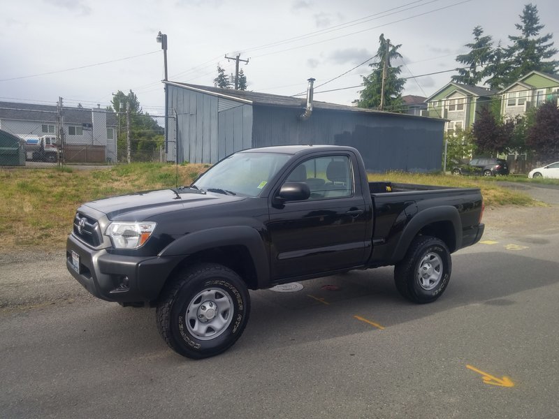

    Thanks, Kick! This height works really welI for me, and aligned with no issues. I went with OME N182 because they were about an inch or so longer in full extension, and just slightly shorter in full compression, compared to the bilstein 5100. That let me take advantage of a little more droop without having to modify my bump stops or brake lines. I picked then up from Wheelers on sale.

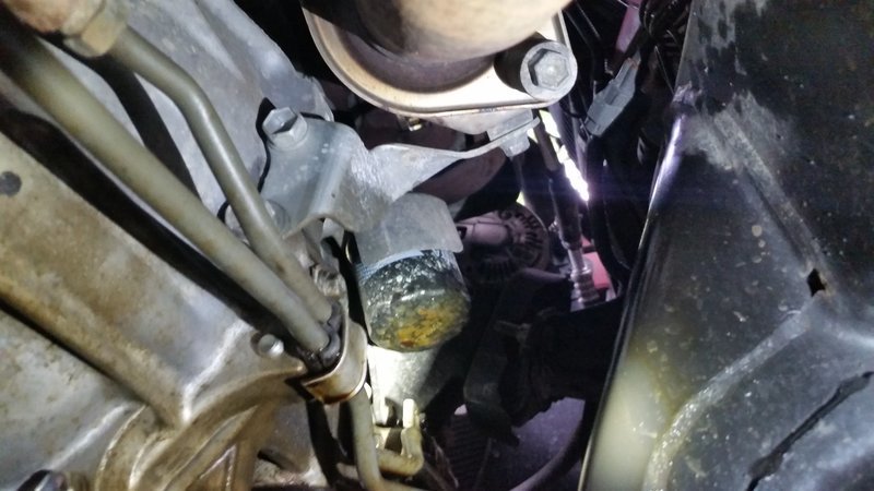

    I'm one sorry excuse of a mechanic. Lol:dancingbacon:

    What are we looking at/for?
    lol..

    That's me leaking oil out of my filter I believe. The oem filters are weak and I ever so slightly crushed it on the last oil change. My dumb ass forgot about it until now.
    In general I don't get along with this oil filter setup and end up looking like a dumbass.

    Yeah, that's not a good thing...

    are you threading that thing on by hand!?
    I always end up making a huge mess and cursing a lot when I do oil changes on my 2.7. The easy things never go smoothly.
