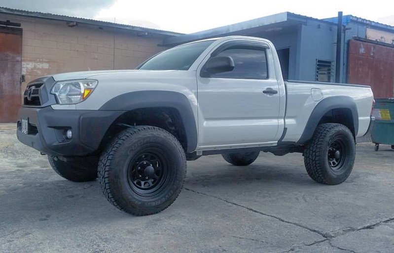

    Here's my junk... per your specs
    Front Billies set at 1.5 or whatever it is (I forget) and single Wheeler's 1.5" AAL in back w/5100's also. It's a good street-able combo. Ditched the sway-bar so it's nice'n flexy. Any larger tire would demand regear IMHO ...it's doggy enough as is. Good luck deciding.

    I love those wheels!

    sharp lookin rig T ross! did you put the tire on before the billies? howd it look then or are they a must? now my concern is the vibration in the rear after the 1.5 aal is installed apparently these last couple posts are not alone. theres a lot of chatter about people having to shim the axle n such matching angles to get rid of that vibration. im just not trying to take two steps forward and three steps back.

    Thanks! No I actually bought the truck with (and this is stupid) a spacer lift on the front only, nothing on the back (serious Dezert lean). So, I added the AAL's (don't do blocks btw) to get it level. I didn't like the idea of busting off my struts because of the spacers so I ditched them and went Bilsteins all the way. Also added Wheeler's super bumps up front. It's an economical and effective set up IMO. Again, these things are sensitive to lift, I also did the East Coast Gear needle bearing/bushing replacement in the front diff to kill the "drone" noise. Once you start down the rabbit hole...lol

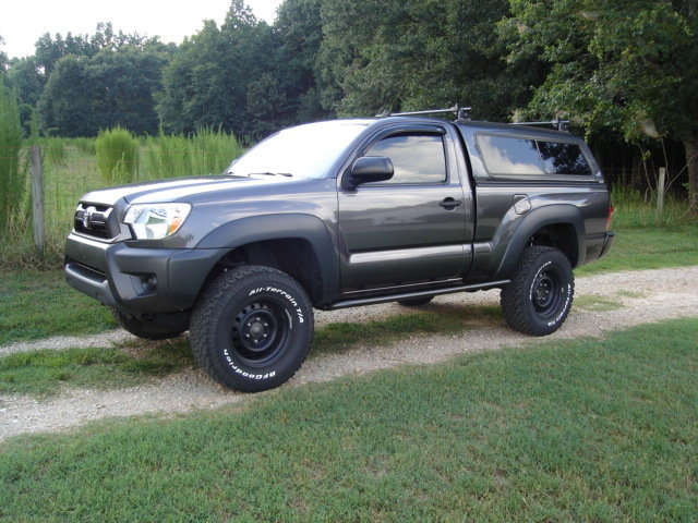

    interesting. ill probably just end up running a 31x10.5x15 duratrac or bfg all terrain on my stock 15s and not living on the wildside for now. i kno i kno im lame

    sogafarm
    sogafarm Well-Known Member
    Feb 18, 2015
    #148983
    397
    GA
    2012 tacoma reg cab spruce mica
    31" Falkon wild peak AT's, fat bobs lift, mud accents
    You've got the dream setup! Nice looking ride.

  18. Jul 25, 2016 at 7:38 PM
    #8838
    vrod671
    vrod671 The Okayest Member
    Nov 25, 2012
    #91817
    15,621
    Brandon
    2022 TRD Sport
    Stock
    For real...
    I love the campers on the regular cabs.
