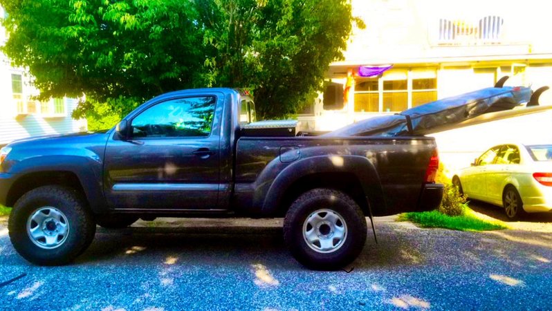

    5100s. eibach coils. 285/75/16 km2s. leer cap
    SUP doggies
    mahaloTaco, rcsteele, 671taco and 2 others like this.

    Trucks looking good!

    Time for something like these on days like that..............
    edit - uhhhhhh, just noticed the tool box...nevermind

    Yea I want to get ladder racks but will they work with a tool box? I have a cap for winter time and it has Thule racks on it.

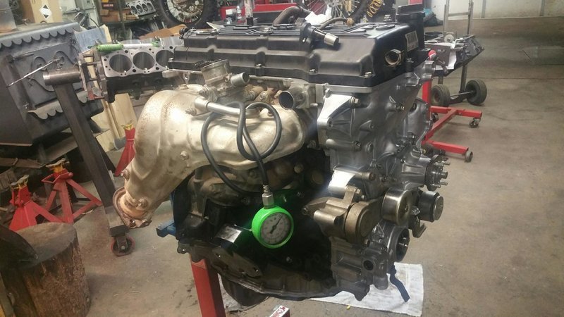

    Almost ready for the road...again...
    671taco, 802coma, weldertaco and 4 others like this.
