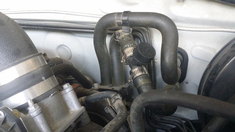

    T@co_Pr3runn3r
    T@co_Pr3runn3r XXXXXXXXXXXXXXXXXXX
    Jan 20, 2009
    #12767
    14,642
    08 RC Prerunner SR5
    My truck was going thru small bits of coolant for awhile before I stumbled onto it's secret project.........
    Was pretty well hidden behind the pulley........until it got like this. Never a drop on the ground. Replaced WP and found belt tensioner pulley was about to fry so replaced that too.
    Dalandser and Toyko Joe like this.
  11. Sep 6, 2016 at 1:28 PM
    #9031
    Dalandser
    Dalandser ¡Me Gustan Las Tacos-mas!
    Feb 19, 2015
    #149090
    17,674
    Anthony
    Downey
    08 PreRunner Regular Cab / 98 4x4 Extra Cab
    Empty Wallet Mod
    Yikes. Did you replace your water pump yourself? If so how involved is it? How many miles were you at when you found that issue? Were you overheating at all? Where should I check to see if that's happening on my truck? Sorry for the barrage of questions. Thanks for the info.
  12. Sep 7, 2016 at 5:06 AM
    #9032
    T@co_Pr3runn3r
    Jan 20, 2009
    #12767
    14,642
    08 RC Prerunner SR5
    Yes, changed it myself and my advice is to just up the coin for the oem. Nothing else comes with a gasket worth a shit. Fuck paper or paper with a bead of sealant which is all that is available otherwise. Even that tar paper type would be OK but nothing beats the rubberized steel oem gasket IMO. The pump itself might be OK but still, my oem lasted 140k and so did the antifreeze? so to me the oem was worth the extra money for peace of mind. Fluid was still pinkish but not good. No overheating. Look into the backside of the pulley to see if it is happening. Not too much of a bitch to change at all, just remove skids so you have access top and bottom. Getting the fan clutch nuts loose and properly tightened is probably the trickiest part. I also took advantage of the situation to install a flush/fill thing on heater hoses by firewall. Made me a hose to cram into radiator cap opening to route the water to the ground. MUCH easier, more effective and quicker to flush out system.
