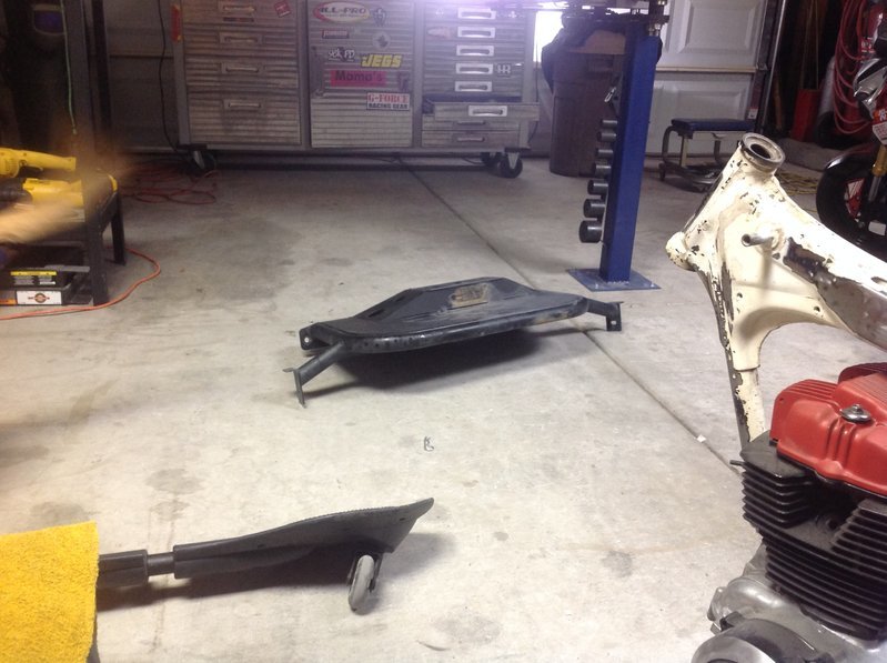

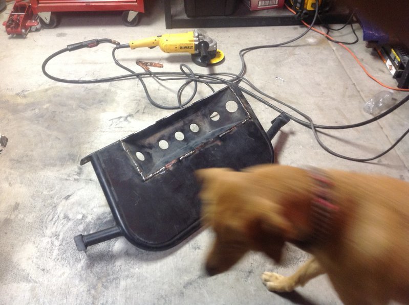

    After
    I went from outty to inny, on my all pro t case skid plate. The plate comes with a dropped section for the v6 exhaust cross over. This bump stuck an extra 2 inches down in the absolute center of the wheel base. It just begged for a high center. I was just going to cut it off but that would leave the whole plate with little structural support. So I flipped the dropped section and just welded it back in.
