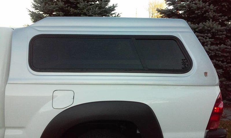

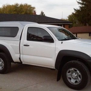

    In my experience the Access Cab and the Double Cab have the same exact curvature and will not fit the regular cab truck; the fiberglass caps will bonk or bash the cab. If you space the cap away from the cab you can make it work but you end up looking funny. This is how an extended/double cab cap looked on my truck, second picture I have it spaced back away from the cab so it didn't hit the cab when driving on a bumpy road.

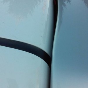

    I found this side view if you look at the curve not matching the cab you can see why it is a great idea to wait it out! :thumbsup:

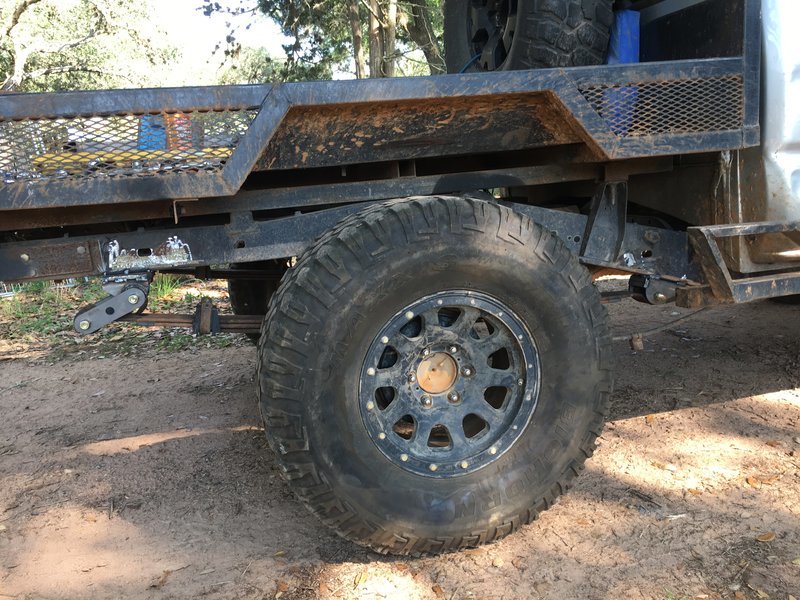

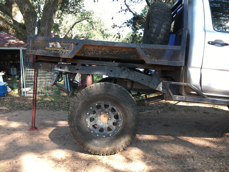

  10. Jun 6, 2017 at 6:25 PM
    #9870
    weldertaco
    weldertaco Mr.13%bodyfat
    Dec 16, 2014
    #144371
    13,299
    texas
    TrailRunner
    4wd to 2wd conversion
    Money isn't a problem in the swap. I've got $200 in it so far with the leafs and swap kit.
    Don't know how much shocks are gonna cost cause I don't know how much wheel travel I'm gonna get yet but I'm more than likely gonna go with bilsteins so they'll be cheap as well.
    PintSize likes this.
  11. Jun 6, 2017 at 6:34 PM
    #9871
    PintSize
    PintSize Crossthreaded & torqued down
    Jun 16, 2016
    #189793
    2,532
    Texas
    2011 2.7L 5 spd RC 4x4
    Not bad man, I think the 14" Bilsteins will be $200-220. I figured about $500 in parts then welding costs would be too much money for now so I went with 3 leaf AAL with 11" stroke Bilstein 5125's in case I decide to go with bolt on shackle flip later.
    For shock relocation you might want to go the route @Rattletrap66 did to save $$
    https://www.tacomaworld.com/threads/a-different-approach-to-rear-shock-relocation.461500/
    RedSki7 and Rattletrap66 like this.
  12. Jun 6, 2017 at 6:40 PM
    #9872
    weldertaco
    Dec 16, 2014
    #144371
    13,299
    texas
    TrailRunner
    I got a flat bed. So shocks will be going wherever. Through the bed is fine lol gonna get as much travel as I can out of the leafs.
    Still cheaper than a set of all pro expo leafs :anonymous:
    PintSize[QUOTED] likes this.

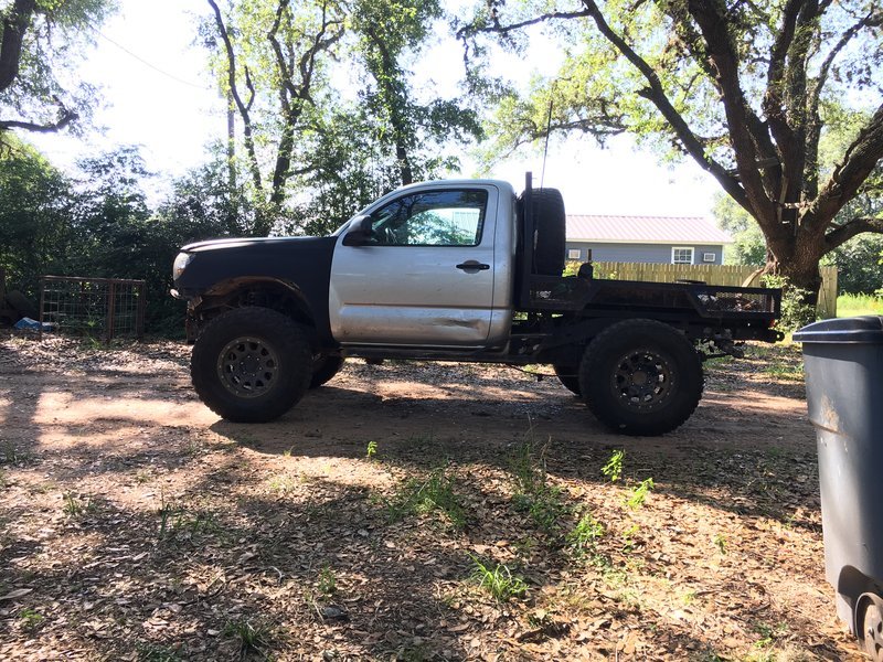

  18. Jun 7, 2017 at 3:54 PM
    #9878
    weldertaco
    Dec 16, 2014
    #144371
    13,299
    texas
    TrailRunner
    $200 later and a day of work...
    From flat ground to straight droop, I have about 10" of travel.
    I gotta cut the front mounts tomorrow and center the wheels better which should help the rear angle a tad too. But it's not bad for the first attempt.
    Nickkos taco, overado and tacoburrito like this.
  19. Jun 7, 2017 at 4:38 PM
    #9879
    RedSki7
    RedSki7 CRF | TRD | PBR | 802
    Sep 17, 2016
    #197485
    90
    Hollis
    Vermont
    06 AC V6 TRD OR 6sp | 02 RC 2.7L SR5 4x4 5sp
    Duck Tape, Zip Ties, & Spray Paint
    That's AWESOME!! Did you custom fab the bed?
  20. Jun 7, 2017 at 4:54 PM
    #9880
    weldertaco
    Dec 16, 2014
    #144371
    13,299
    texas
    TrailRunner
    Yes sir. About to cut it up too so I can fit 37s lol
    RedSki7 likes this.
