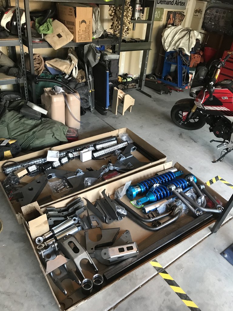

    I'm not looking to be the best at ripping or crawling I just want to be able to do a little of both and have fun. I've been following my buddies around the desert for almost a year and a half now to include a solid axle fjz80 locked front and back an 85 pickup with sas and dual t case of coarse locked front and back and the other side of the spectrum is my buddies 1st gen tundra on 5100 with svt shocks in the back. Other than one other dude in a 4 runner I'm the only one running open diff. There has been a handful of spots where I can't do what they can same with the guy in the runner. I would venture to say that with 4link and long travel and lockers I should be able to keep up with both ends of the spectrum that much more.

    Ifs yes, crawling meh?

    That was purely to show that solid axle isn't always king of crawl and I'm not saying tc kit is on that level but an sas on your average taco is not on the same level as a full blown rock bouncer. Independent suspension tech has come a long way in the last two decades and should not be discounted. Sas is a solid option (pun intended) but it is also old tech and has some limiting factors. Ifs isn't without its downfalls either. Any truck that's long traveled or sas is cool in my book. The total chaos kit is stout, call them up and talk to Nichole. Ask her about the truck that stuffed one side into a concrete barrier at 90 and only bent a uca. Come down to Tucson and come wheeling (be a bit for me gotta install all my new parts and I'm still waiting on my rear axle) we would love to wheel with any Toyota and there is always a cold beer in the cooler for you. Then we can supplement our debate with experimentation and find out the truth. That being said my buddy with the sas pickup has dual t case and way more ground clearance and can articulate like a cat so he will always out crawl me if I can pick an easier line and not take the bypass I'm happy.
