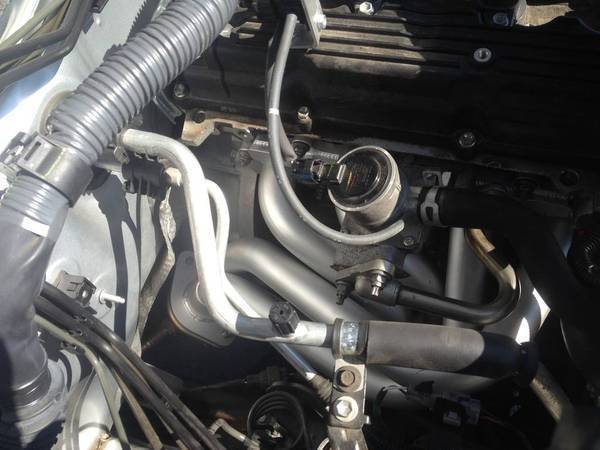

    Put this in today. Niiice

    How was it? Looks good.

    It's a new LCE.

    nice little increase in low end torque, definitely worth the money.

    Was the install easy, or a bitch? Were you able to do it alone or did you have help?

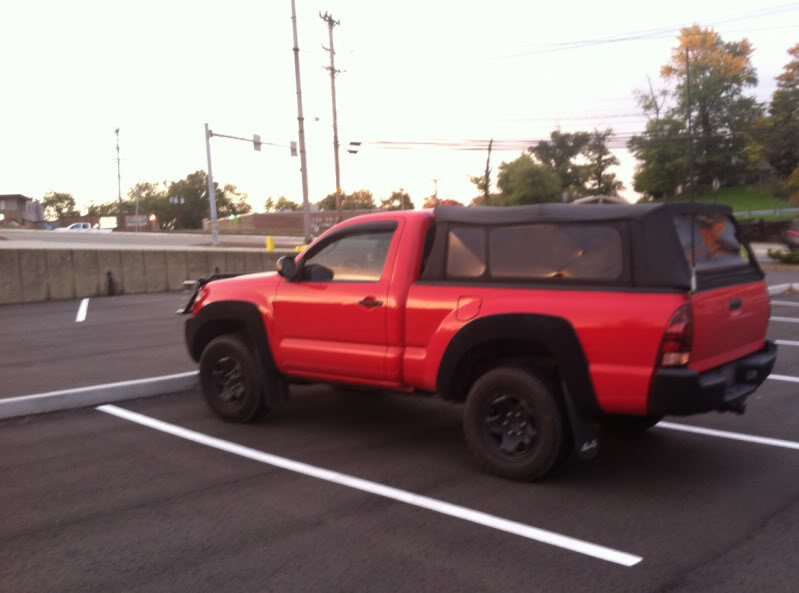

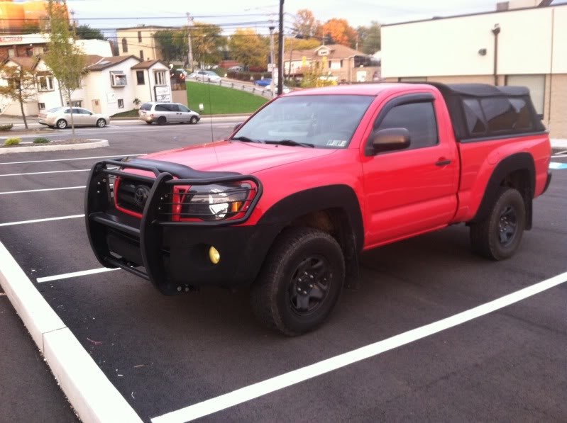

    i havent posted any pics of my truck for a while. kinda crappy, i was on a job site. hard to see my bedlined bumpers and fender flares too

    Definitely easy. Took a little bit of time, but you can do it all with a ratchet & some wrenches. The hardest part of the install was loosing the damn spring bolts that collect the header to the exhaust piping, that was a bitch. I wish I had a power or torque wrench, that woulda made it easier. But so far it's money well spent. I noticed a significant difference in stop and go traffic.. not as much of a struggle.

    Cool beans. Good-lookin truck too.
