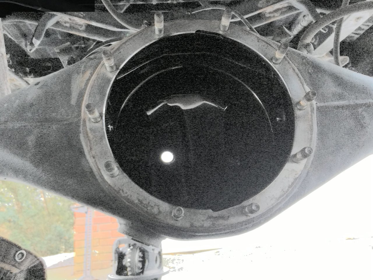

    Yessir I have fully built diffs from ECGS with fresh Yukon gear and axles 4.88s! I am regretting not having them install arb front and rear but I they were not in the budget :(

    Super stoked! Can't wait to get them in and past the break in period and then see what the truck can really do!

    4.88s are in! Just got back from the first Drive...night and day!

    @overado hell ya dude! how hard was the install? what was your total cost? i keep telling myself im going to keep this truck forever so i plan on doing these things to it but i still need to find a bigger truck for the girl and dogs.

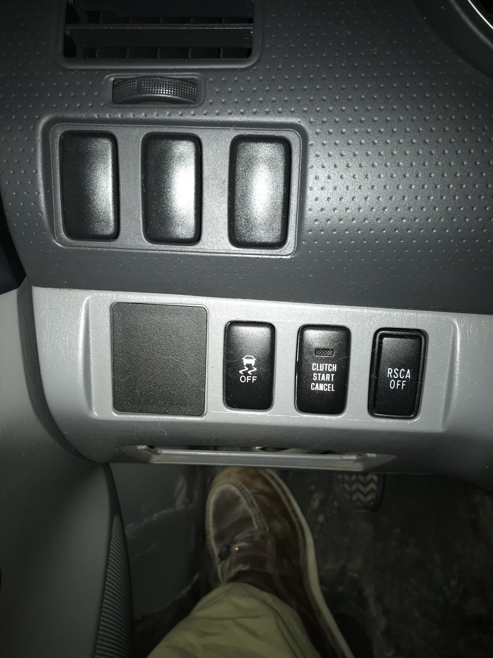

    Did the black headlight mod and finally installed my intermittent wiper switch today

    Where’d you get the switch

    eBay. $80 which was the cheapest I’ve found

    For the record, lots of toyota switches work with the Tacoma. For example, my switch was from a 2012 tundra (looks exactly like the one above). The one in my girlfriends 09 corolla is the same switch that I pulled out of my tacoma (no intermit). Look around and you can find pretty good deals on one. I think I paid around $40 for mine.

    I got mine out of a 08 camry for 5 bucks at a junk yard, then took the old switch back and said it was the wrong one..(technically, it was the wrong one, they should have never been installed), got my money back.

    The front diff is a wicked pain (probably only because I did it by myself) and I ended up having to cut the head off one of the bolts that connect the clamshell to the ADD tube. The rear it's simple and quick probably took me an hour and half not including the rtv dry time
