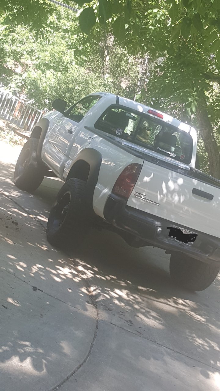

    I would like to know as well. What tire size and lift is that?

    What s your location, that's my exact truck!

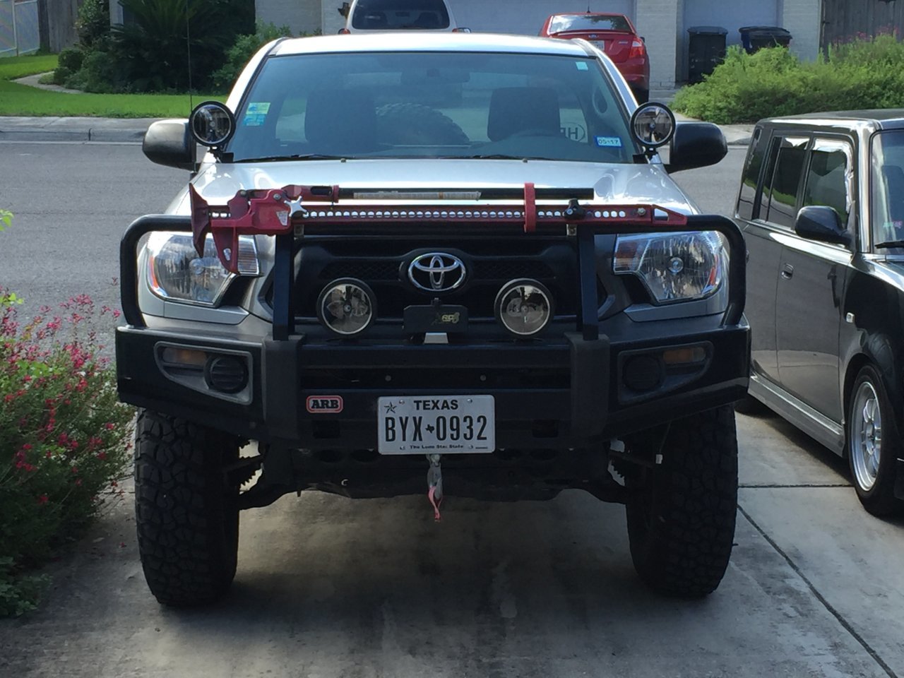

    OME 855 front with nitro chargers, Dakar +/+ rear leaf pack, ARB front bumper with 8000 lbs. winch,CBI swing away rear bumper with tire carrier and 2 fuel can carrier,
    255/85 16
    OME 886 and nitro chargers up front
    Dakar leafs and nitro chargers out back
    ARB bumper
    XPS 9500 winch
    CBI ditch brackets
    CBI trail_____2.0 rear bumper with swing away and duel can mount and spare tire mount

    ?? And your not regeared ?? With a 4 cylinder..did you remove 5th gear or is it a slush box??

    Sorry, yes I regeared to 4.88:1, before regear it was a dog on the highway
    It’s also an automatic

    How do you like the lift kit? Decent ride? I want my truck setup like yours at some point. How much lift do you have overall?

    Honestly, it’s stiff, reminds me of riding around in my grandfathers 65 stepside. But it’s able to haul pretty much what ever I want with no squat or sag. Had 1200 lbs of scrap steel and it sat level.
    The kit I bought was made for the extra cabs and double cabs so it came out right at 3” and hasn’t changed much since, I expected it to settle but it really hasn’t.
