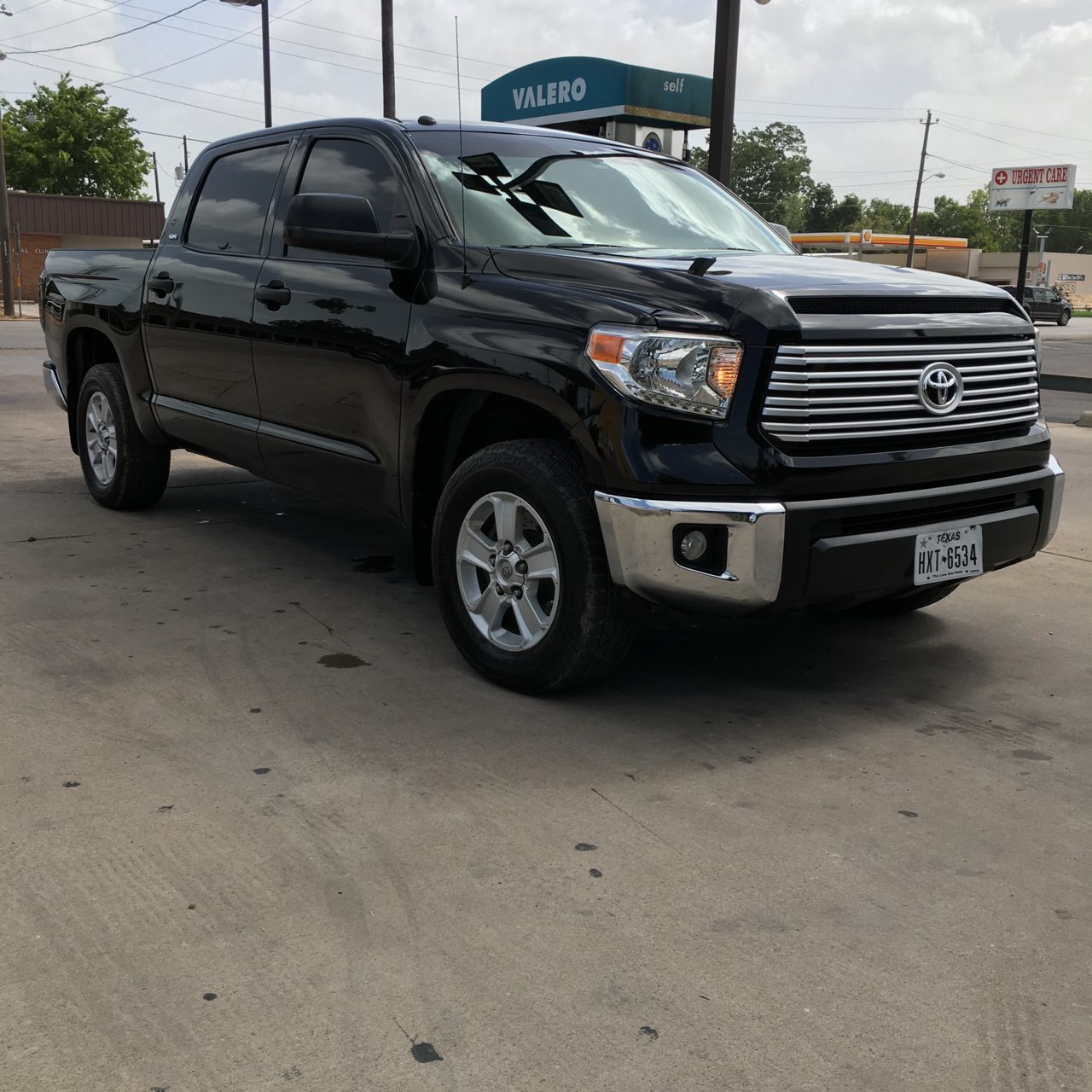

    Big boy. 5.7 and cabin space for days. Hate every bit of it. I miss my single cab.

    What a beast! Love it

    I hate it lol I can’t wait to ditch it

    I want mine to look like that. Sick truck!

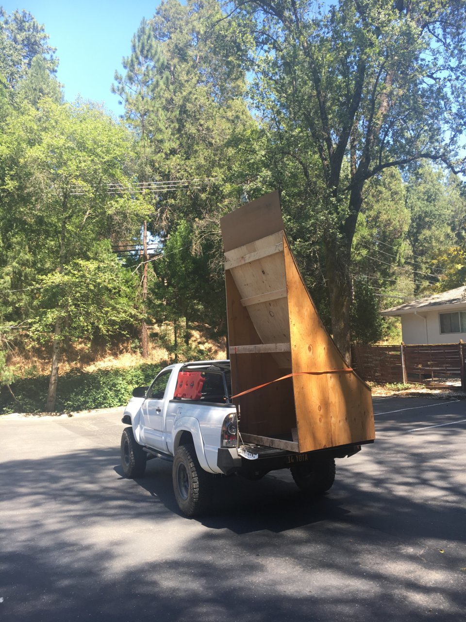

    Free Craigslist find of the day:D So convenient having a quarter pipe in the driveway!

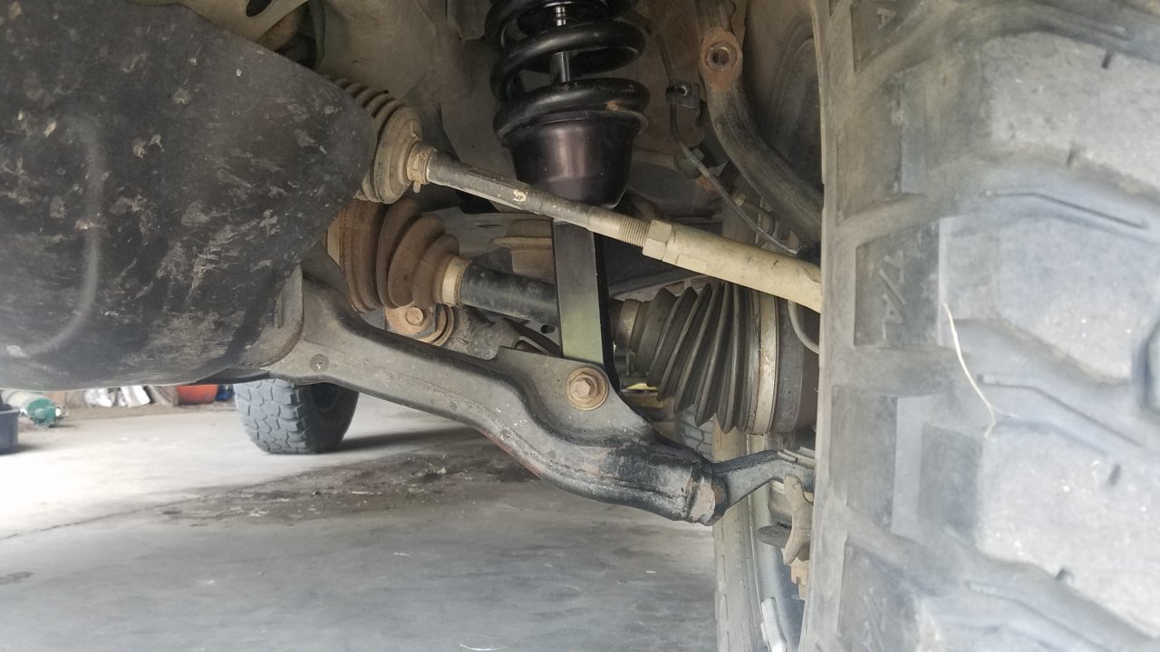

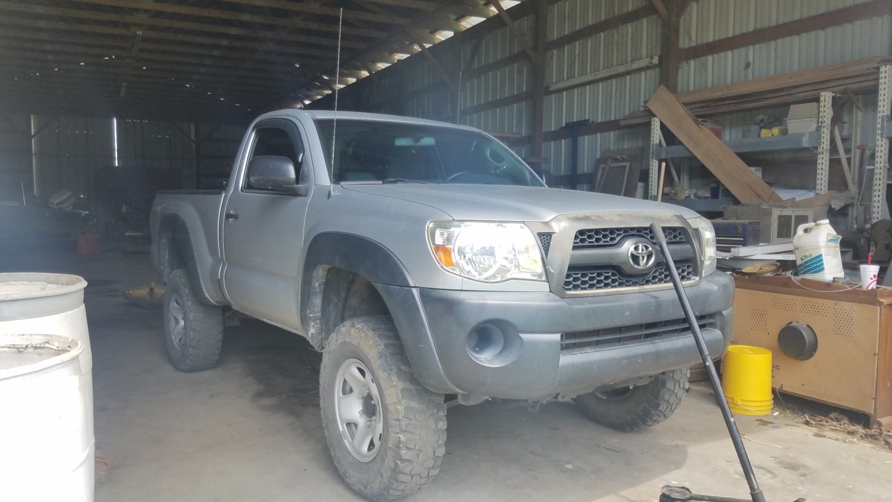

    What were y'all stock hub to fenders measurements for 4wd models?
    Putting in a lift and trying to get it dialed in and I don't have oem measurements.
    I'm at 24" hub to fenders and I'm worried that's over 3". Edit: I dropped them down to 23.5
    Also, I am running expo leafs in the rear, they are sitting at 26 and 27" hub to fenders which just seems super tall.
    Anyone running them on our reg cabs?
    Pic at 24" up front.

    You're up there, it'll settle a little but IMO, you're too high - how do your CV's look?
    Stock is around 20(front) and 22(rear) from what I've read.
    Mine was purchased with a shitty spacer lift, no first hand measurements unfortunately.

    Same here, bought it with a spacer lift. CV's were steep at 24".
    I set it back to 23.5 and will drive that for w few days.
