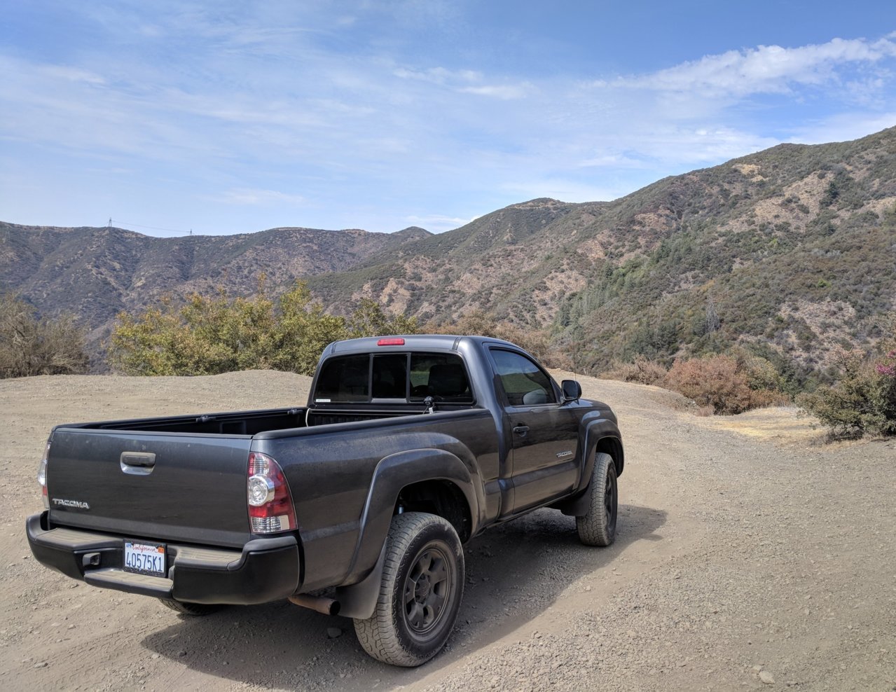

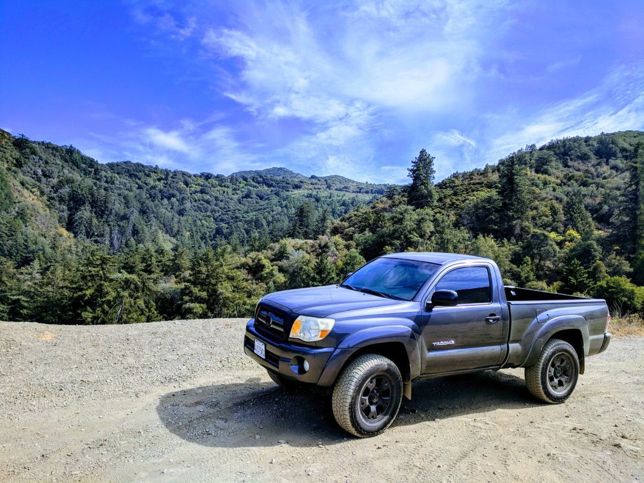

    Went out yesterday for an afternoon trail to test out the mild Eibach lift I installed recently. Handled much better than the trd sport struts I had before.

    Nice. Looks great! You happen to know your hub to fender measurement?

    23.5" in the front. I am running SPC UCAs also.

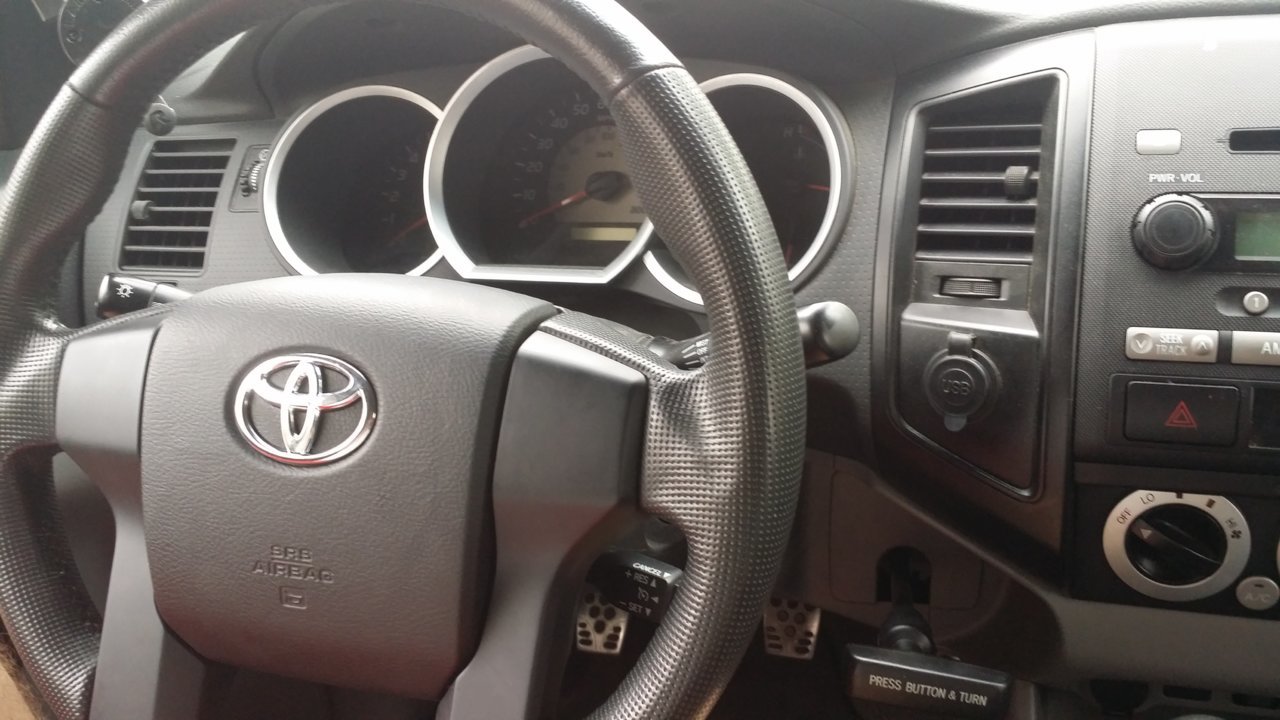

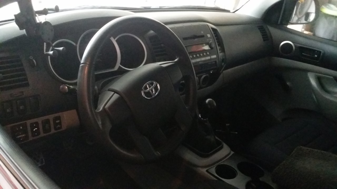

    I swapped in a 2013 wheel. Had the controls but opted for more blackness and retaining simplicity since blutoof already in place on left of dash............

    I have SL 265/75r16s and it still lost the nimble feeling. I think the problem is the higher center of gravity more than the additional weight.
    Edit: nevermind, I see you meant compared to bigger tires while regeared. Weight savings will definitely still help acceleration and mpgs.

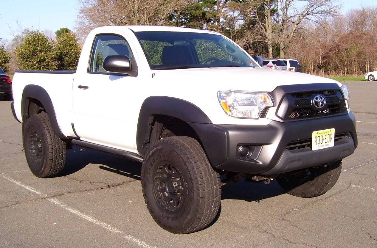

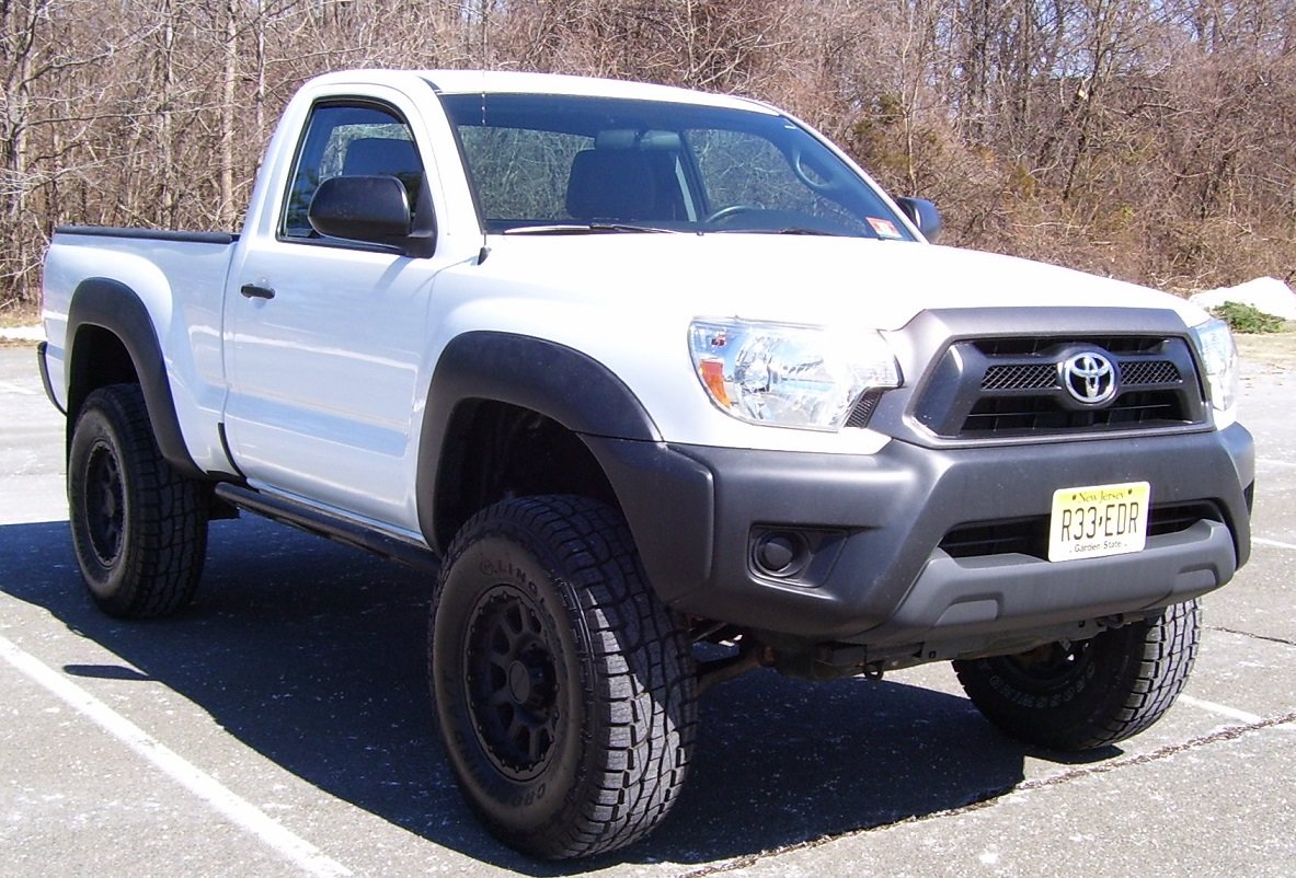

    Mine was around 24.25" when I got the truck. I made some adjustments to the SPC arms and removed some 1/2" spacers. The cv angles were pretty steep and it had a torn boot when I got it. It's now around 23.25" with the 885 springs and nitro shocks. The truck has the diff drop so the cv angles are pretty good now.
    Before
    After

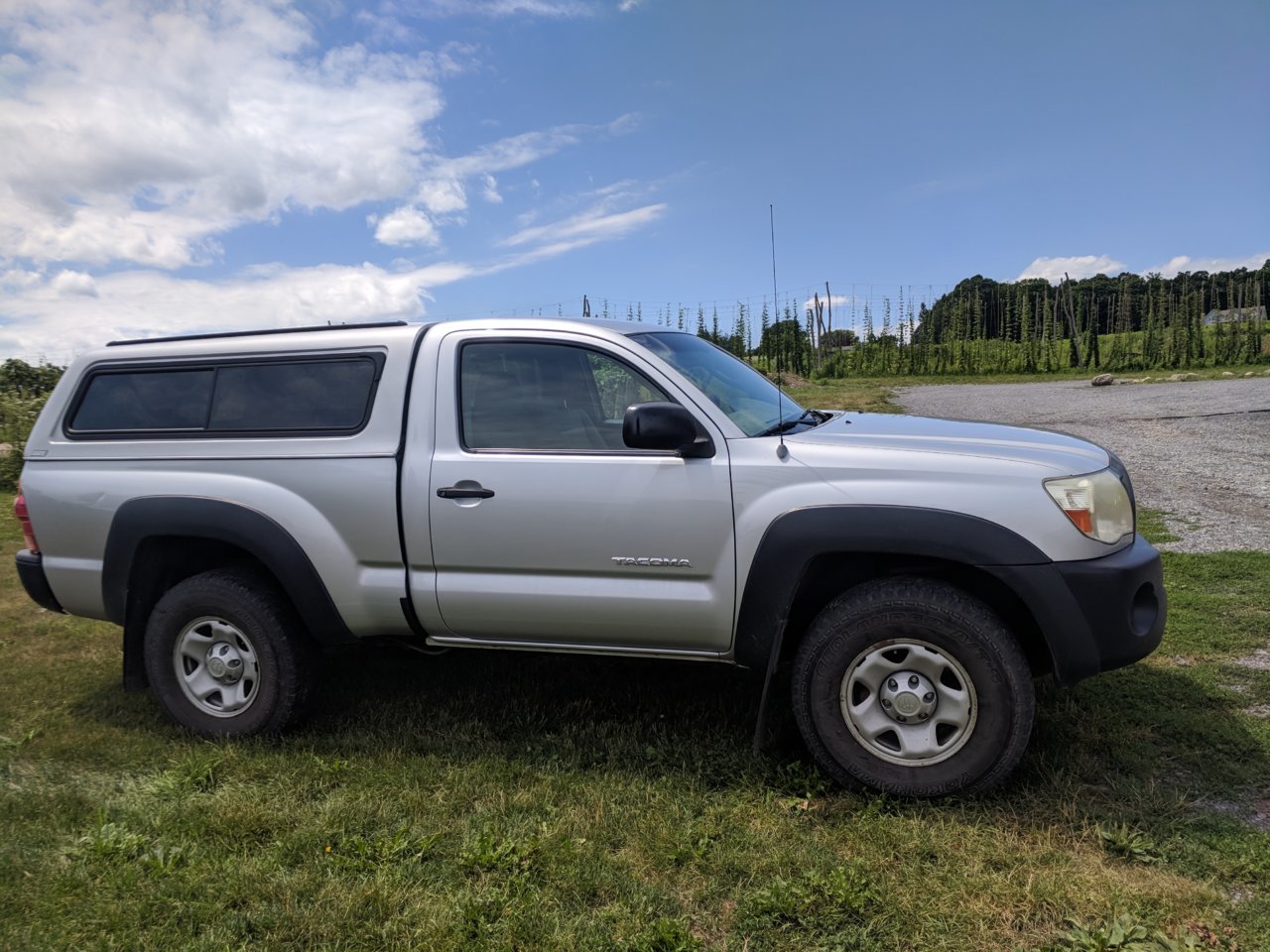

    Today's the 2 year anniversary of when I picked her up! 2008 2.7l MT 4x4 with 124K miles. Up to 154K miles at this point. I went to the Taco from an Impreza because I haul beer kegs for festivals and deliveries and needed something beefier. Hasn't let me down yet! Now I just need this next winter to help me get a 10mm hole so I can get the frame replaced...
