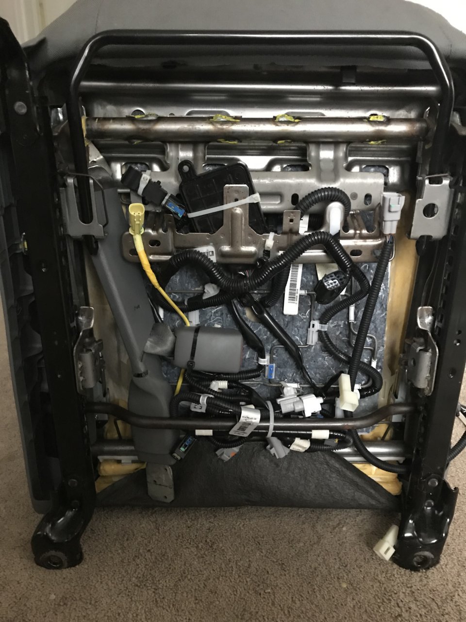

    @stlntaco wish I lived closer! I just got a pair of seats from lkq and finished putting them in today.
    To those that have swapped out for buckets, how did you go about wiring the passenger seat? I got seats from a 2014 and the drivers side was direct bolt and plug in. Passenger not so much. The airbag plug works but the other plug for seatbelt and sensor is totally different. Is there a solution? Or is it just rip out the beeper so I don’t have to listen?

    I pulled the passenger seat weight sensor out of the factory bench seat, and moved it to the bucket. No issues so far. I used the same seatbelts so that all is the same

    Pulled out the sensor and wiring harness from the bench, pulled out the old seat buckle and made a new tongue to trick it into thinking the seatbelt is always buckled. Then used massive amounts of zip ties to get all that crap tucked in under the new seat. Now to plug everything in see if it works...
