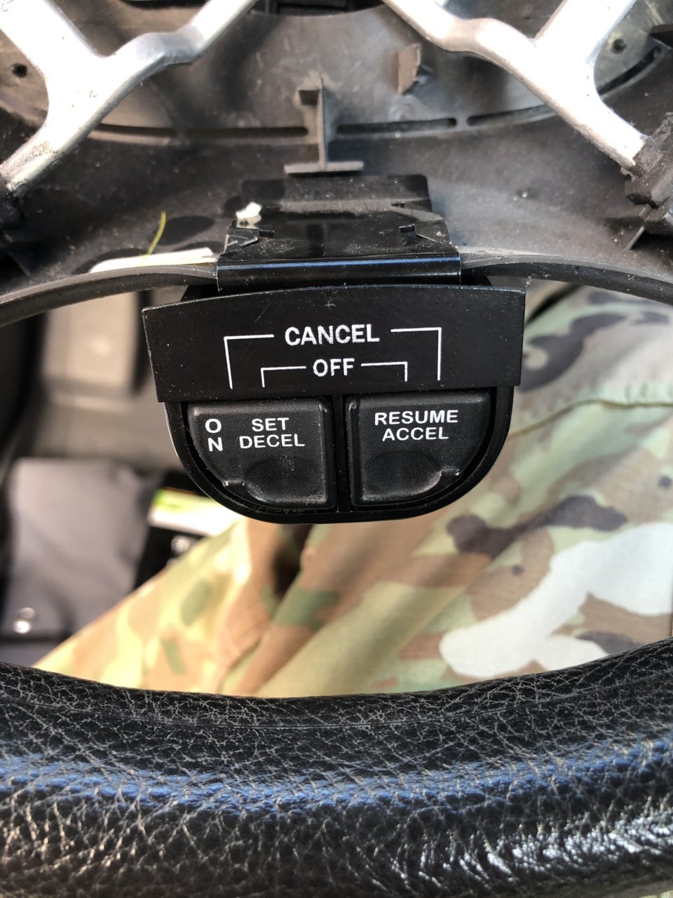

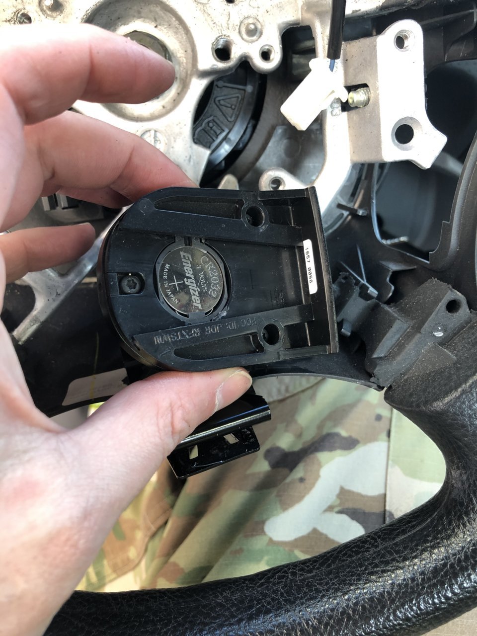

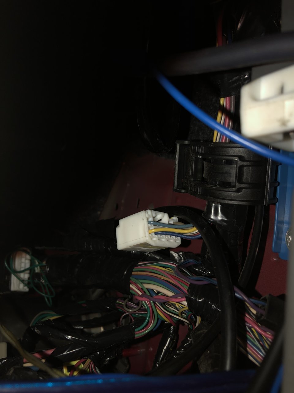

    No joy. Tried to short the pins out and could not get the cruise light to come on. I also found out that there is a Rosetta wireless cruise installed.
    Could not find the receiver. Also found this harness not plugged into anything.
    Debating if I want to drop $200+ on a new clock spring just to have cruise control and steering wheel buttons for my 2013 head unit.

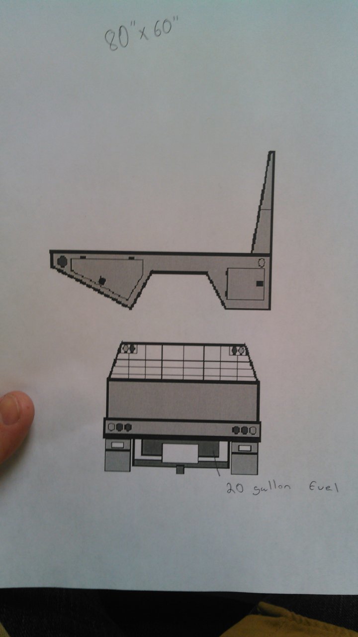

    New flatbed design. Fab shop in Longview gonna do it this summer. 1552489190958-1368205253.jpg

    Did yolu do the design or is it a standard offering?
  15. Mar 13, 2019 at 10:30 AM
    Nomad_Pilot
    Nomad_Pilot I need to pewp
    Feb 2, 2015
    #147763
    3,277
    Clay
    Ft Collins
    I did

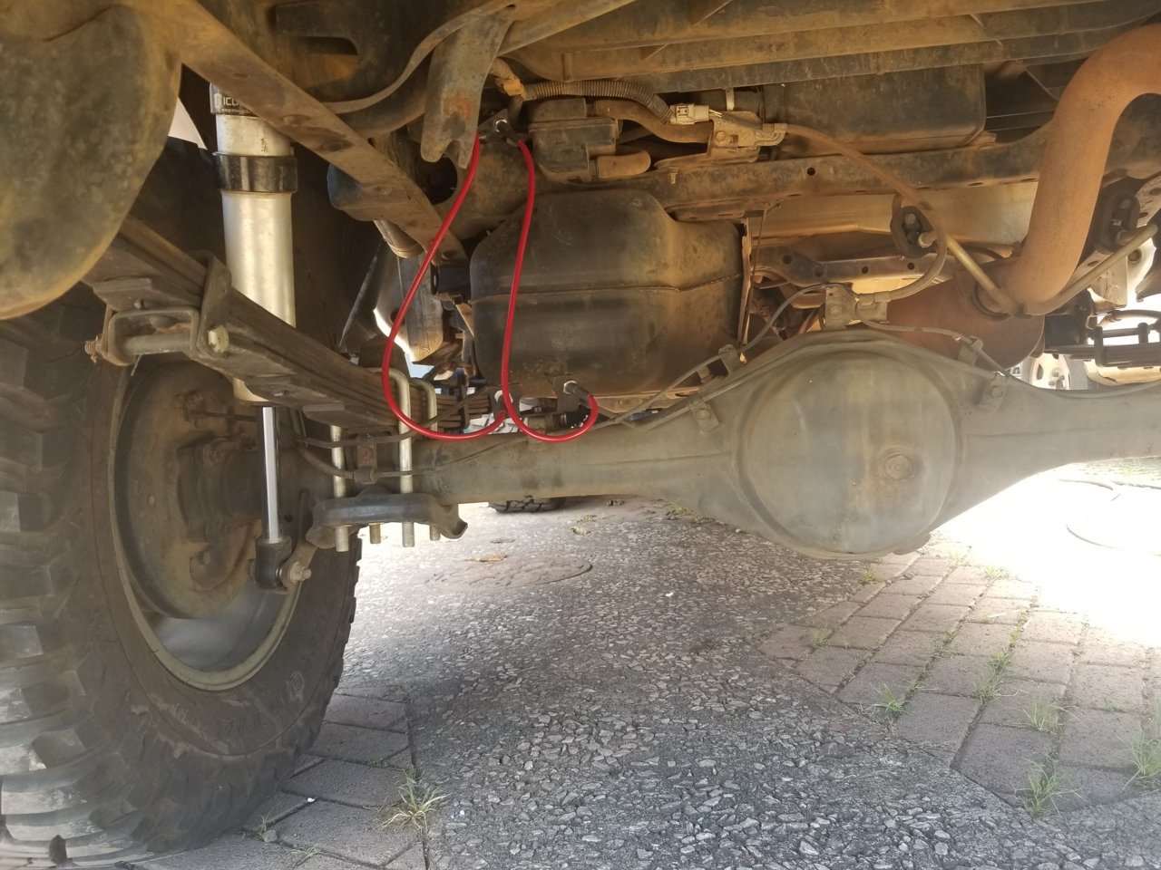

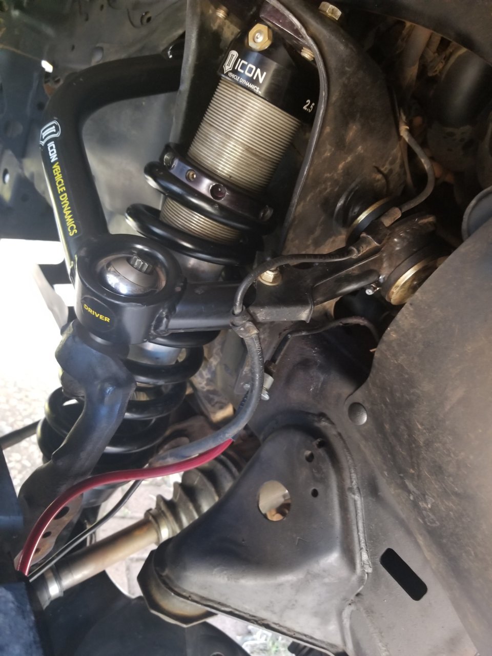

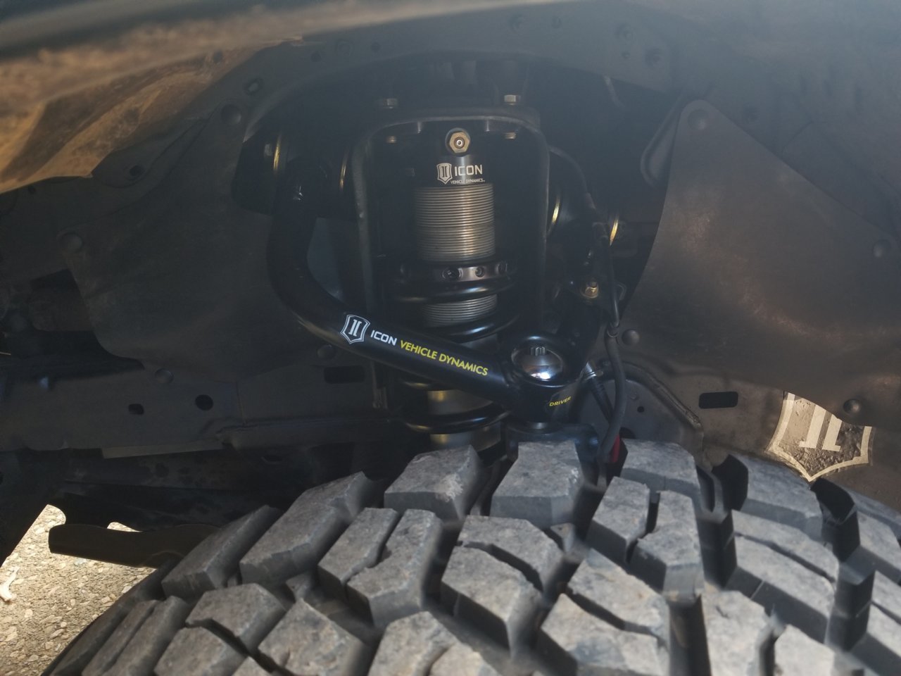

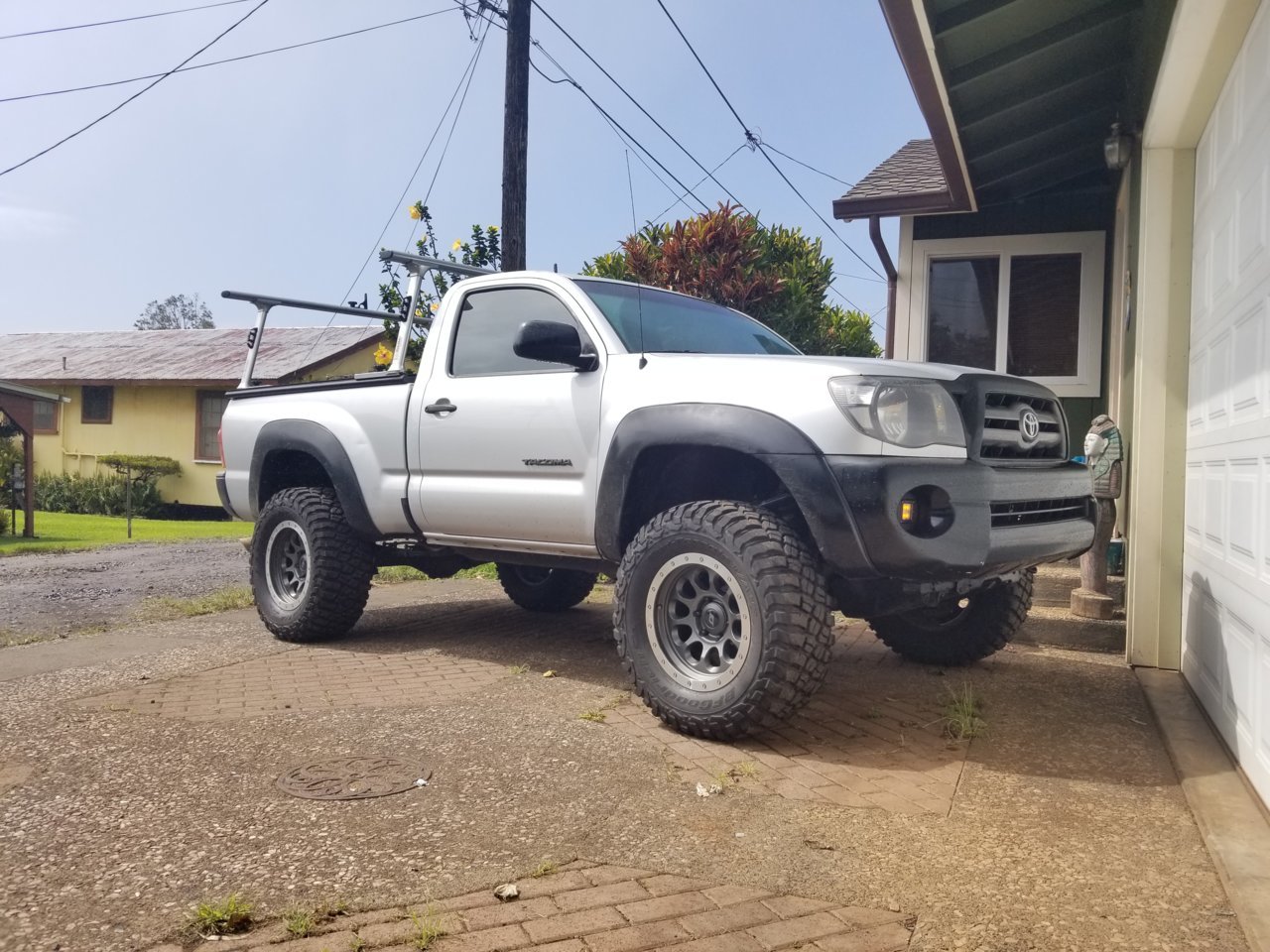

    I got a bit of work done the last week or so. I leveled out the passenger side, did a BMC, some of you might have an aneurism sense in havent welded the plates on yet. Finally tinted the truck, 5% on back glass and 35% up front, kept it legal. Im not sure if I mentiond it earlier or not, but new tie rod ends, spidertrax 1.25" wheel spacers for the front, and I also did wheelers offroad brake lines front and rear, the rear is 4" extra, serviced the truck with royal purple to see if the hype is true, rotated tires and detailed the suspension. Still need to do my wheel bearings, steering shaft and replace my already torn CV boot. but its almost there, soon back to actually doing mods

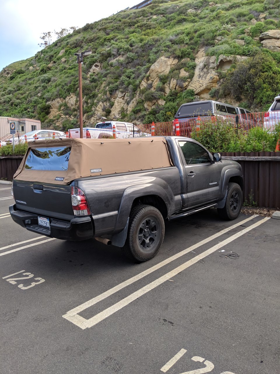

    Got a softopper because I wanted to be able to camp in the bed, but still need the bed when
    I move again in 4 months.
