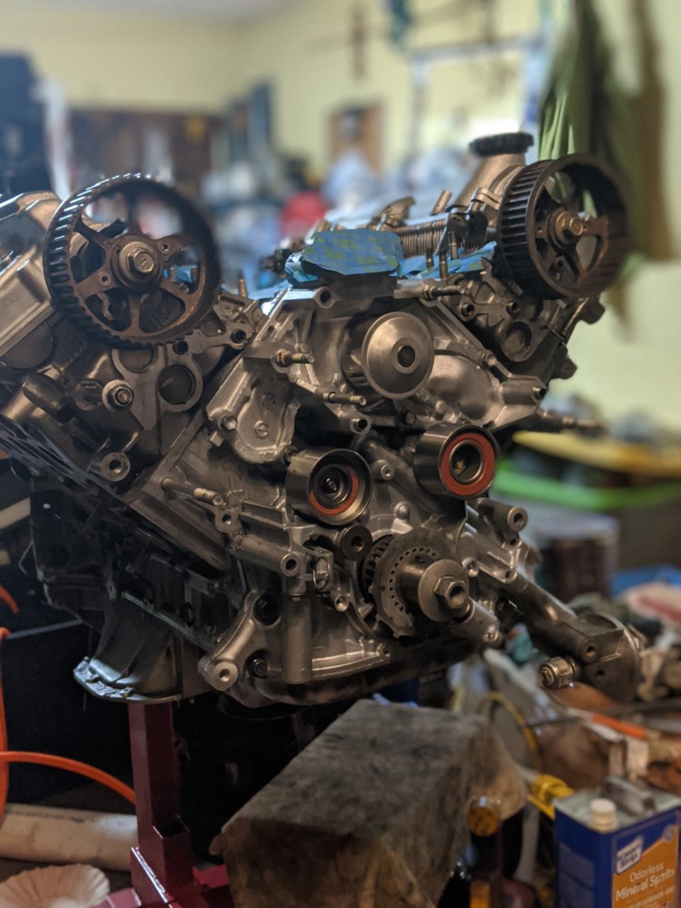

    Went ahead and ordered a slightly higher mileage engine that will for sure fit. I was holding out to install it myself but with me rolling the land cruiser and some family problems, we can’t risk having a vehicle down. It’s a bummer but I am glad to finally get this done.

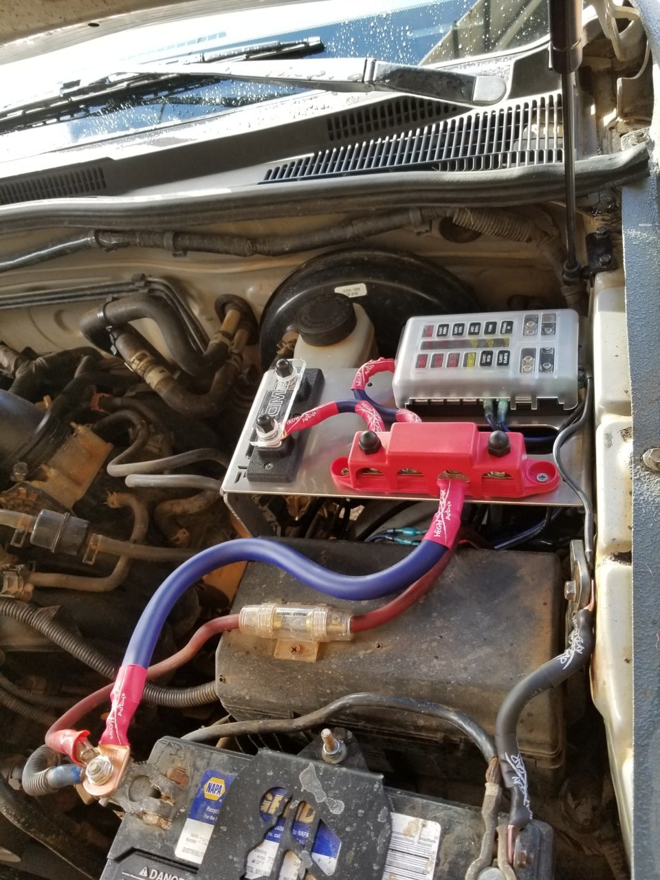

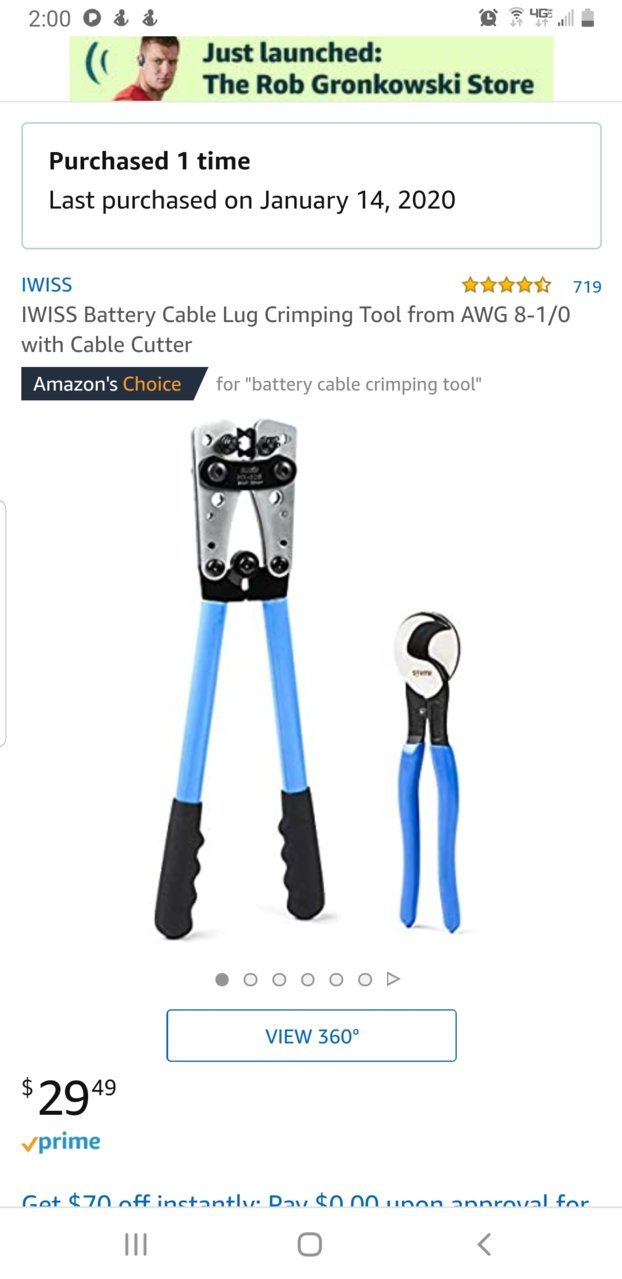

    Put a power trays panel in and started getting wires off the battery. last wire to get replaced is the red one, being moved to the SMD Fuse holder for my amp and new wire ran into the cab. Got everything on Amazon. I used sky high ofc wire and the terminals to match. 2 4 post terminals one for power distribution and the other under the power trays as a relay holder, and a 12 post fused distribution panel for small gauge wires like lights. Clean wiring makes me happy. Get the iwiss cutters and crimpers, it cuts 1/0 like a dream and the crimpers take away the headache that is soldering large gauge wiresScreenshot_20200119-140017_Chrome.jpg
