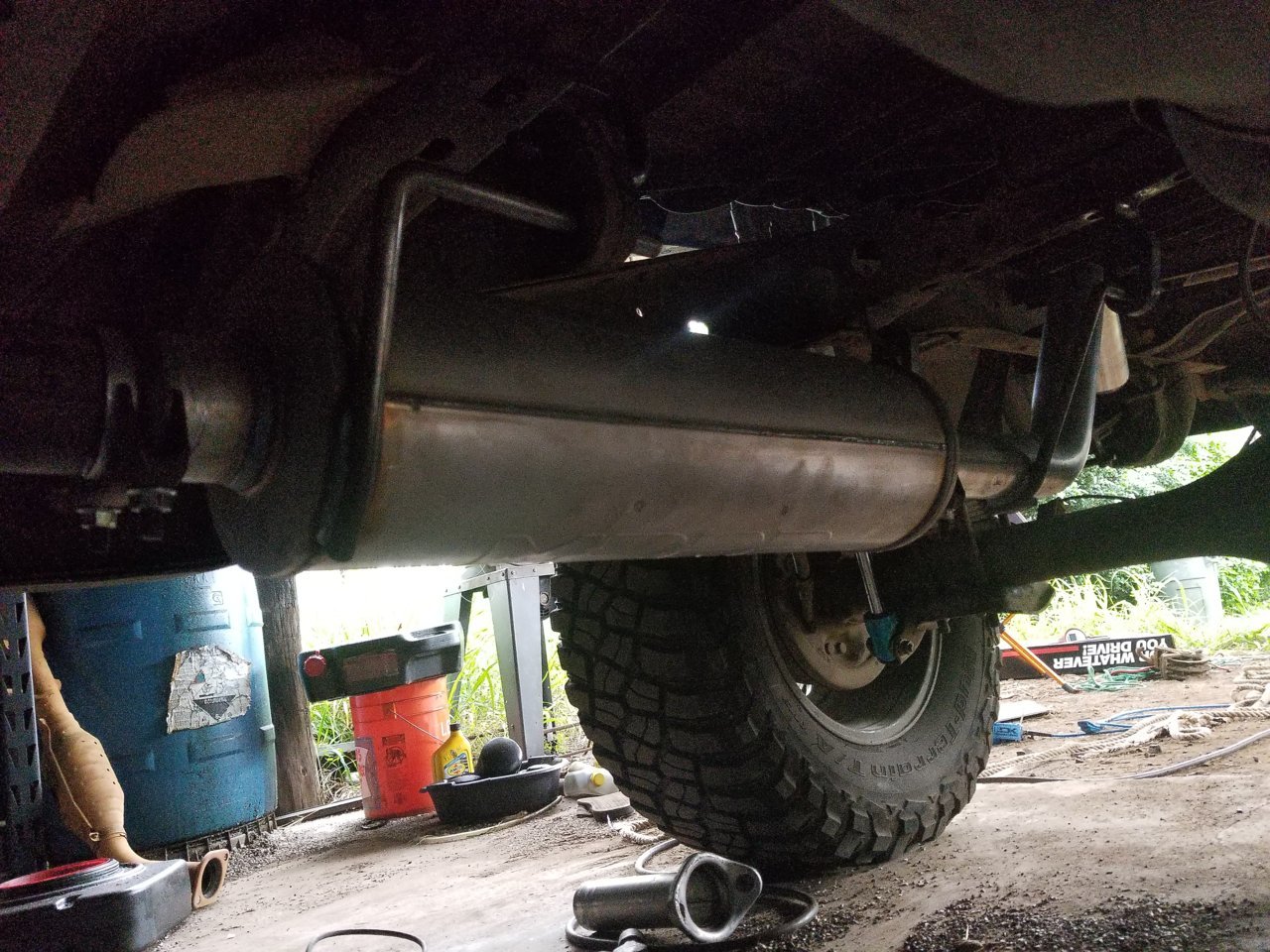

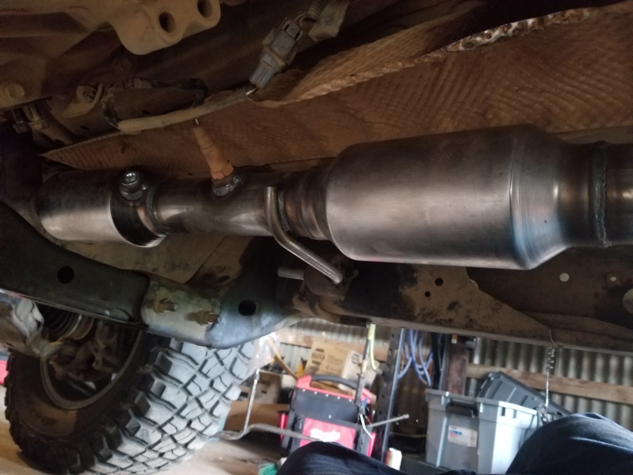

    My truck is down with a mangled clutch, but I the meantime while waiting on parts I got a magnaflow high flow cat and a mbrp exhaust cat back side exit exhaust. It blew my mind how much better it sounds with just the new cat. Unfortunately if you dont have a 2.5" for the 2.7 the flange that mounts to the cat will not work. I had to reuse the one from my old gibson (do not recommend the Gibson, didnt fit right and was nothing but leaks). To finish it off I plan on getting LCE headers. However this will probably be my last post for quite some time. I head to boot camp for the navy on the 24th

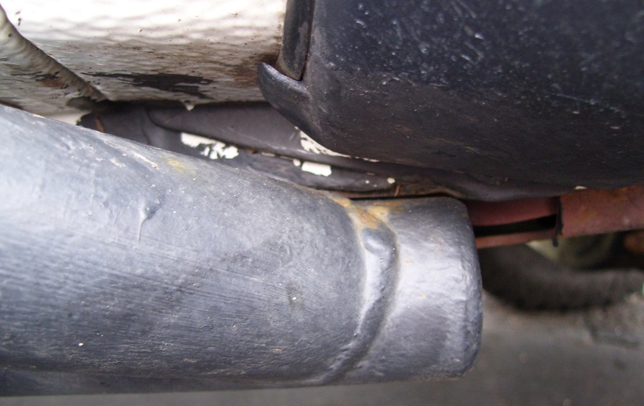

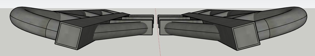

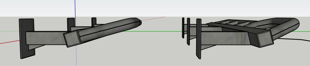

    Hey guys I've got a request from those of you that currently have sliders. I'm currently working on a design at the moment but I want to make sure I've got my measurements correct.
    2"x2" 11ga square tube
    1 3/4" 11ga round tube
    - What is the length? I think my design is a little too long.
    - What is the gap between the main slider and the pinch weld? I want to make sure there is enough wiggle room for deflection.
    - Any pictures would be awesome especially where they are mounted, I plan on welding mine.

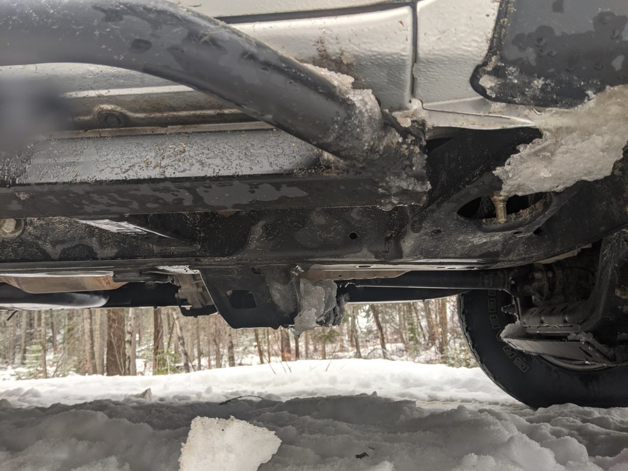

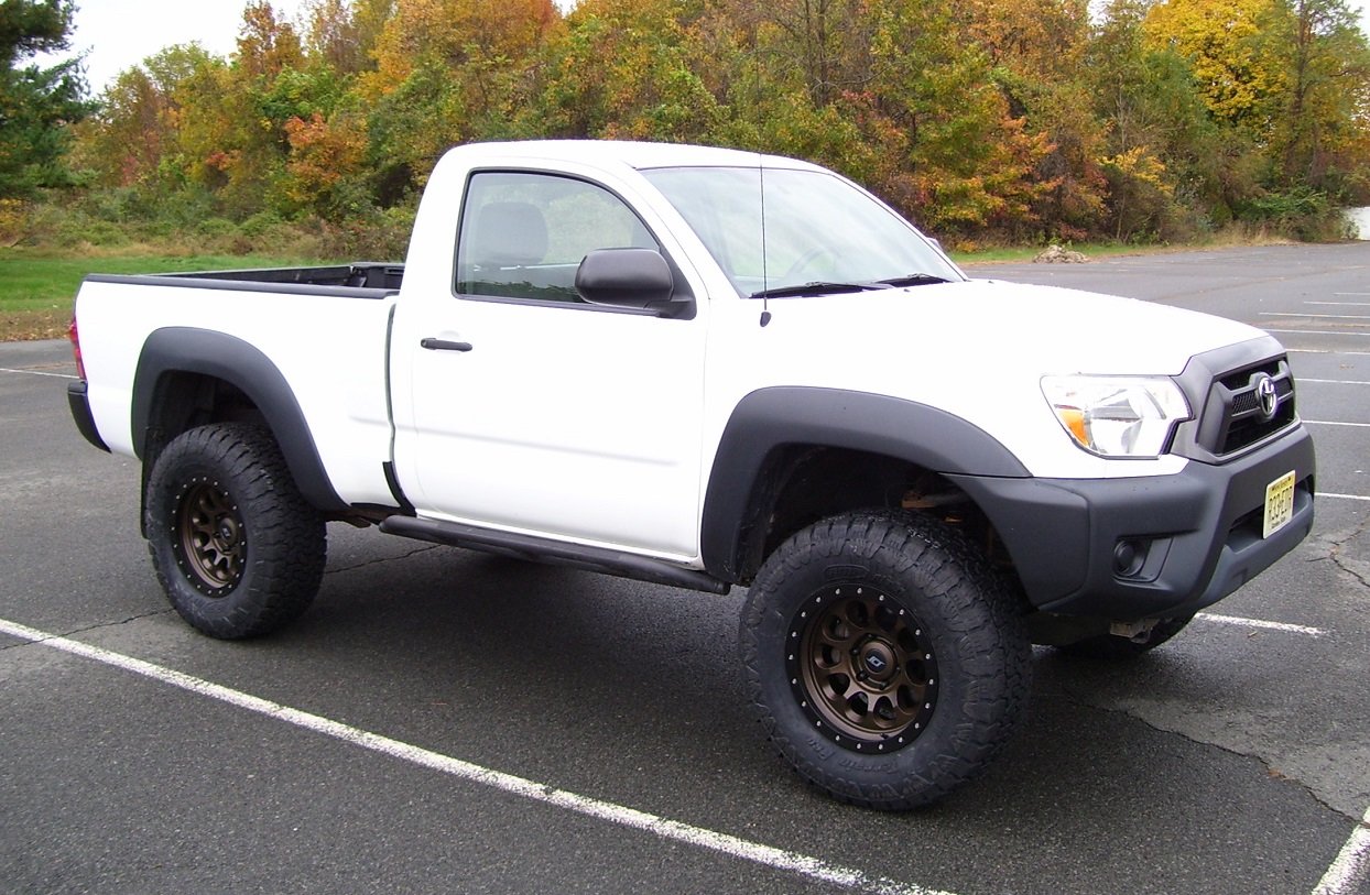

    My truck had the TrailGear sliders already welded on when I bought it. I think they are 58" long. The passenger side was welded too close to the pinch weld (looks like 3/16" or less) and it hits the pinch weld on bumps and potholes. I would shoot for 3/8 to 1/2" at least to avoid the contact. Mine don't have the kickout though.

    awesome I appreciate that, I was planning for about 5/8” of a gap hoping that would be enough.

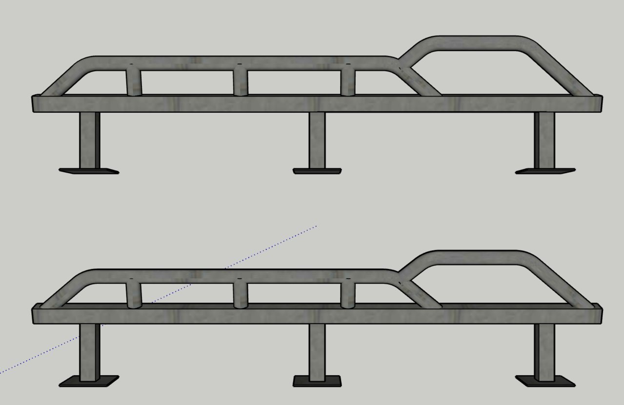

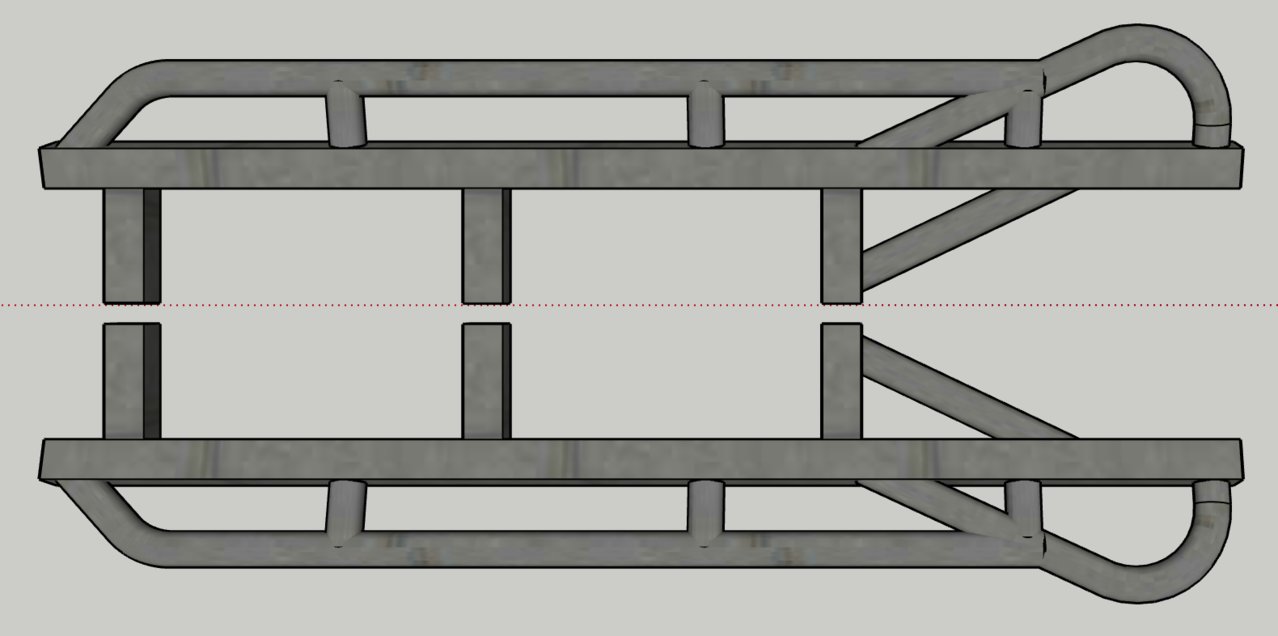

    The drawing is very conceptual right now I need to go back and rework a lot of things. I just wanted a bit of feed back first so I know what I need to correct. With that said I just threw in mounts evenly spaced I understand where that rear mount is there isn’t an actual place for it haha.

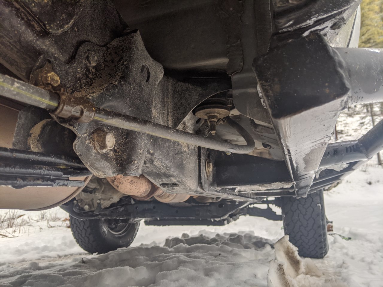

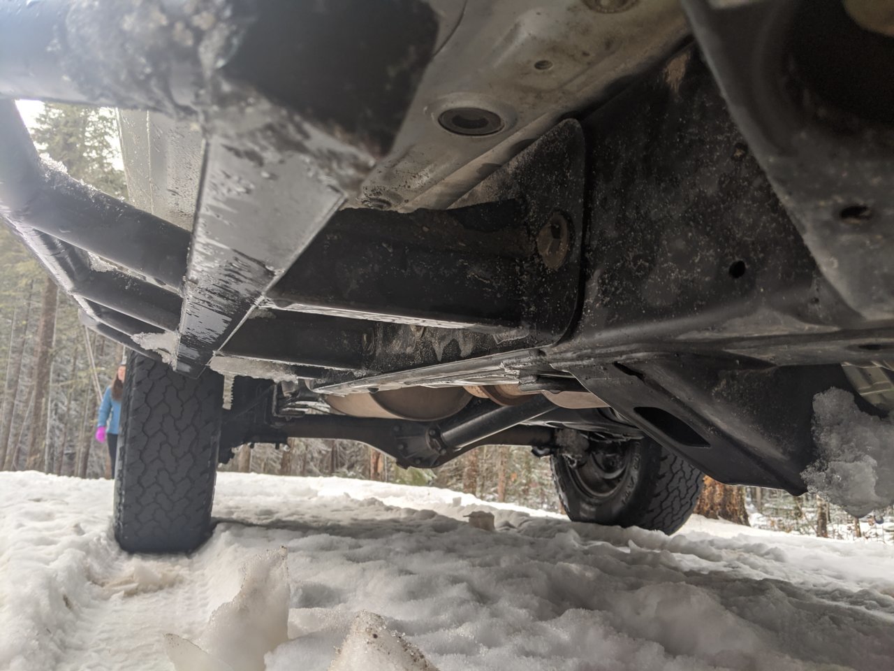

    @Taco505 Here are a couple I snapped of my @SOS CONCEPTS bolt ons. Let me know if you want any other angles.

    Thanks, these are helpful to see what the bolt-on looks like I've thought about the SOS sliders.
    I had originally measured about 71" - 72' inches and figured it would be waaaaay too long and too much to deal with the drop of the fenders, I think 60" might be my number after measuring again and seeing a few other sets. I think I'll copy your idea with the tube supporting a portion with the overhang. I do want to go with a 15° angle though so thats going to make the additional support a little difficult so I may just end up with 90°. From the chassis to the outside of the slider how many inches did you go? I measured about 14.5" to be about flush with the fenders and figured there or a bit in would suffice, the measurements in the 2D image below are at 90°. Anyway, I changed the design a bit and updated with some measurements if you're curious, thanks for your help.

    Agreed I think a bit of angle will be the best option and I'll post progress for sure but I have to say that I am notoriously slow on projects haha. The last thing I need to do is see what dies my buddy has before I finalize the design and purchase the steel, either way I'll keep you all posted and thanks again.
