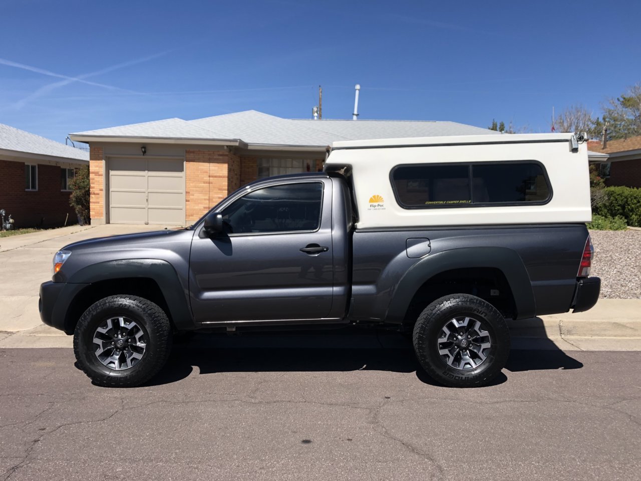

    First time with the truck unloaded since I put the lift on it. Can't decide if I like the amount of rake.

    I think it looks great

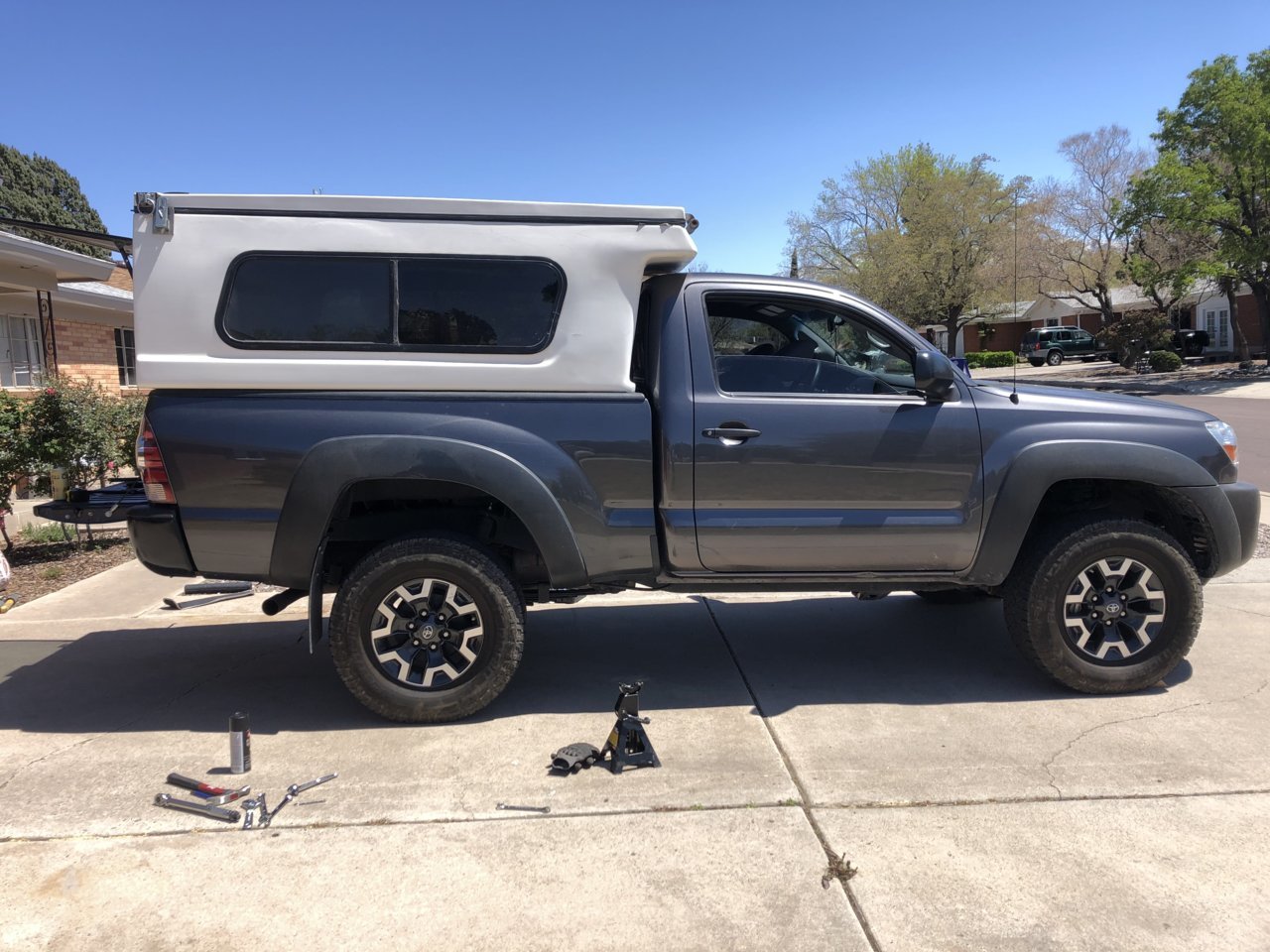

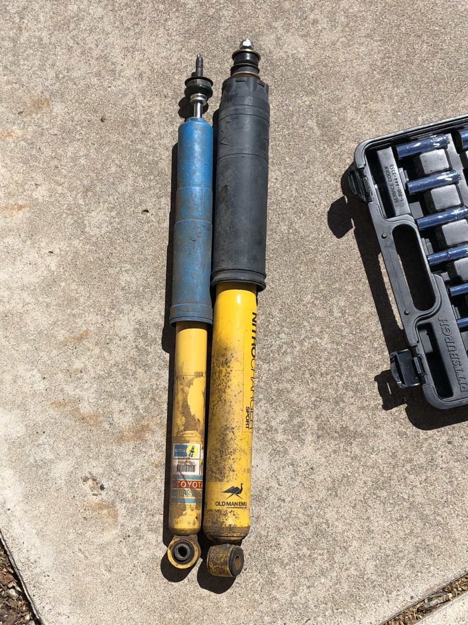

    haha ya stuff that like is difficult when you don’t have the tools/skill set. Wish I had a welder and knew how to use it. Anyway I at least got these nitro chargers on today that I picked up from another user.
    Before -> MD Dekar LS and 3rd gen shocks ~24” from center hub to fender.
    After -> MD Dekar LS and nitro charger shocks ~24 1/2” from center hub to fender. We’ll see what it looks like after settling.
