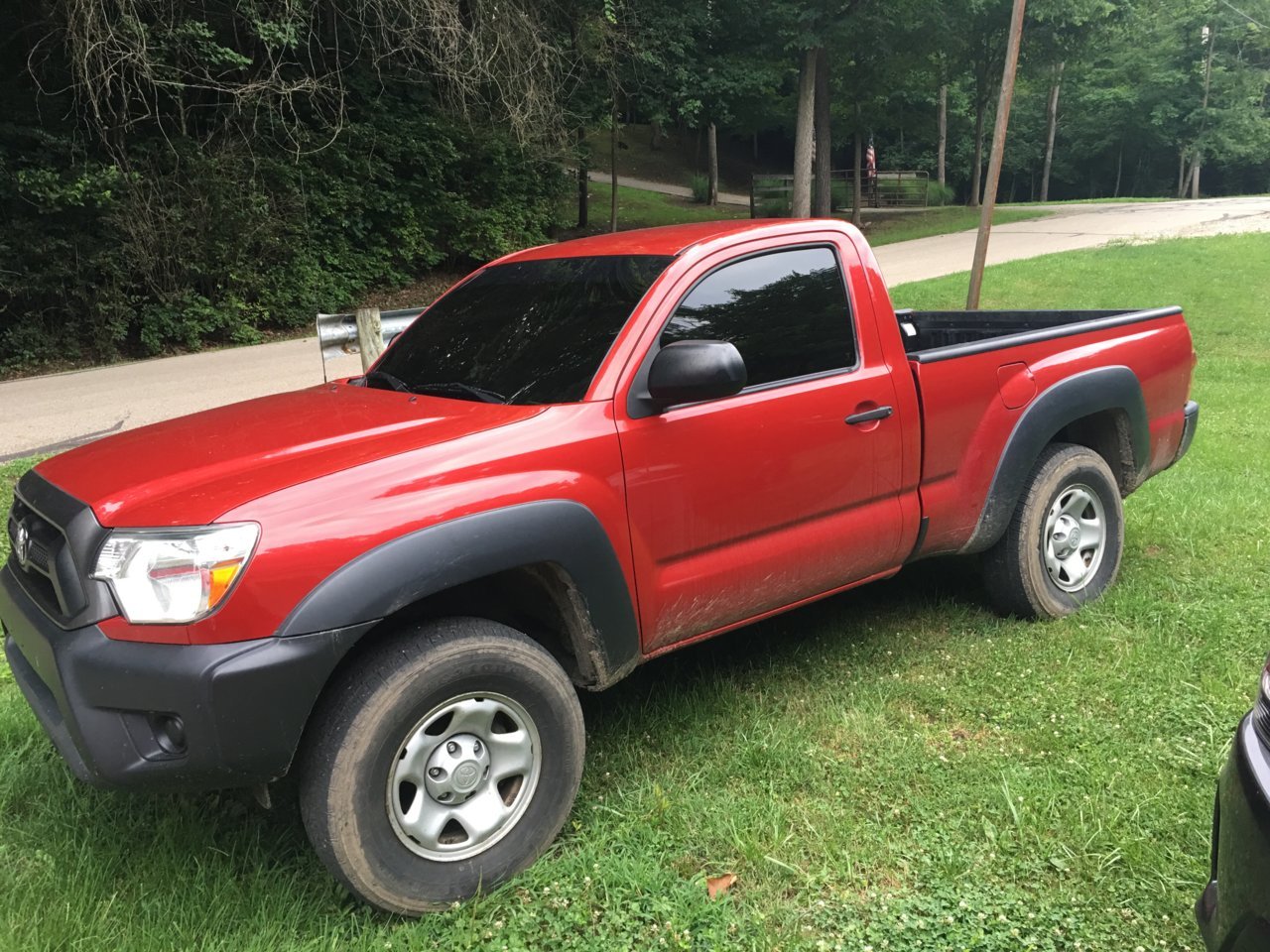

    Driver mod

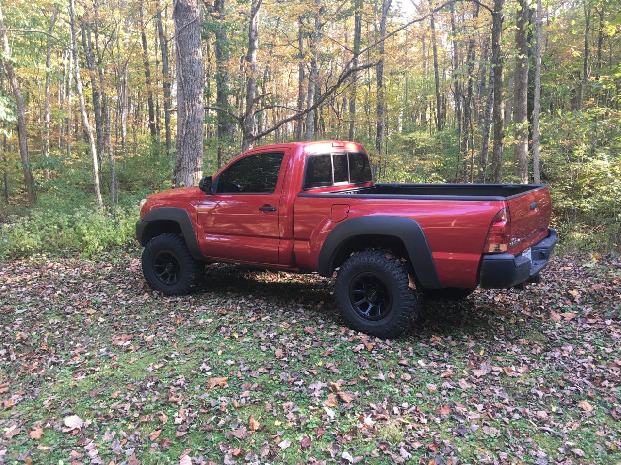

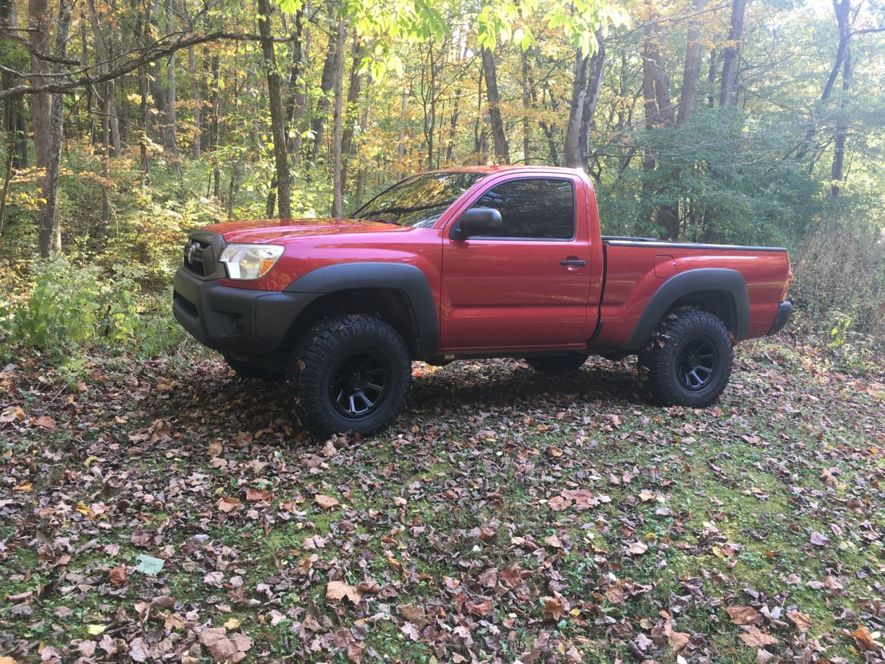

    Finally got my 5100s and AAL installed along with the new wheels and tires. What a difference the wheels make.A83630EC-E70F-4755-9728-7BF3AD30134E.jpg 68E9206D-F339-4B01-8940-EB2A27B1B689.jpg 9C566E97-4FF3-4A09-ACBE-3653A4B89A05.jpg

    Great transformation!

    Beautiful. Did you replace the needle bearing or do you have any plans to?

    I did not replace it when I did the lift, hopefully wont need to. I did the same lift to my 05 reg cab I had and put several thousand miles on it before selling, never had an issue with that one either.

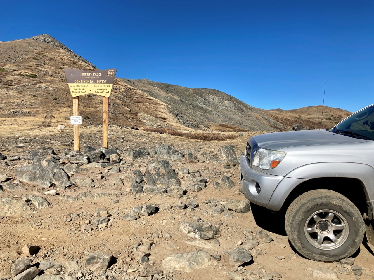

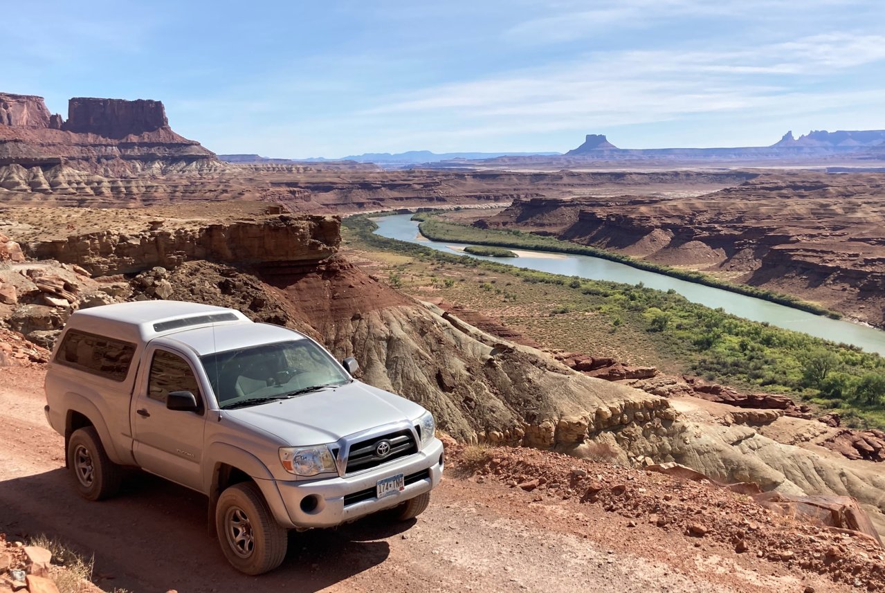

    out for a little drive in all the right places
    210,000 on this little gem.. why will Toyota not make a Gen 3 standard cab with the V6 and manual transmission???? Come on on Toyota,, get with it

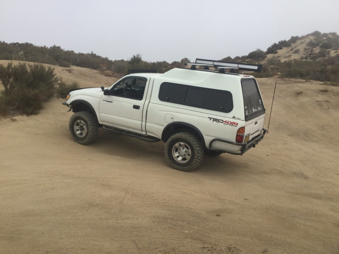

    Anybody know if I can fit a 33BFg A/T tire no problem on my 97 its got a 3” lift thats it oh and a front tube bumper fwiw, currently rocking these 31” m/t bfg after they run out I want to get 33’s but want to know if I need to do anything else, will i rub when offroading? Thx
    wheels are stock 15x7
    current tires 31x10.5
    want 33x10.5

    I don't know a whole lot about first gens but I had to cut out a lot to make my 285s fit. I'd suspect the same for you. Might also rub on the UCA with a stock wheel

    Skinny 33's rubbed slightly on my truck, once the pinch weld was folded back they only contacted the frame at full lock.

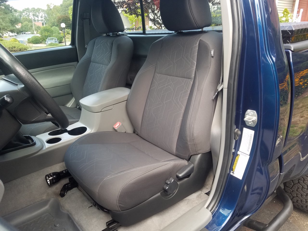

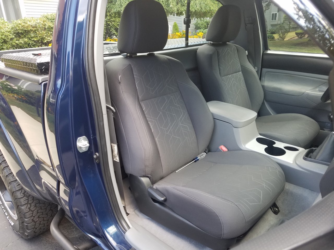

    I put 3rd gen seats in my truck, they are a straight bolt in deal, as the rails are the same from 2nd to 3rd gen. The electronics are close, but I had to take out some of the electricals from my stock buckets so the seat harness on the 3rd gen seat would plug right into my truck.
    The only other thing I would recommend is if you are taller, and have the seat almost all the way back, I would look for 2nd gen bucket seats. Since the 3rd gen seats are much thicker, and I had to do a lot of hacking so I could get the seat back far enough and not hit the back of the cab, while also being comfortable enough to drive.
    One thing I also didn't have to worry about was seat airbags, since my truck didn't have them stock, so I didn't have to bother with any of the wiring, but is something you would have to worry about, since you have a 2013.
    Here is a pic of them installed:
