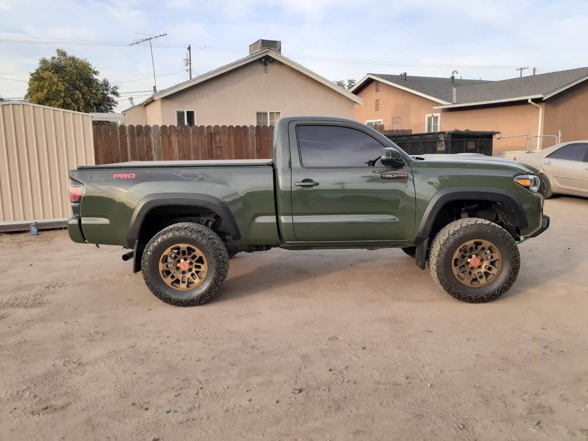

    That's my truck but I put a Trutrac limited slip in the rear, sorry no locker

    How do you like it?

    Looks nice but good luck for that price
