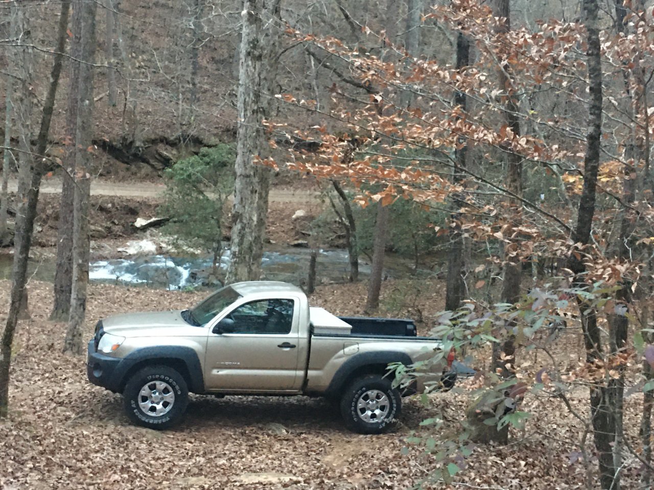

    upload_2020-11-24_23-46-59.jpg First time post. Here’s my regular cab 2006 with 252,000 miles

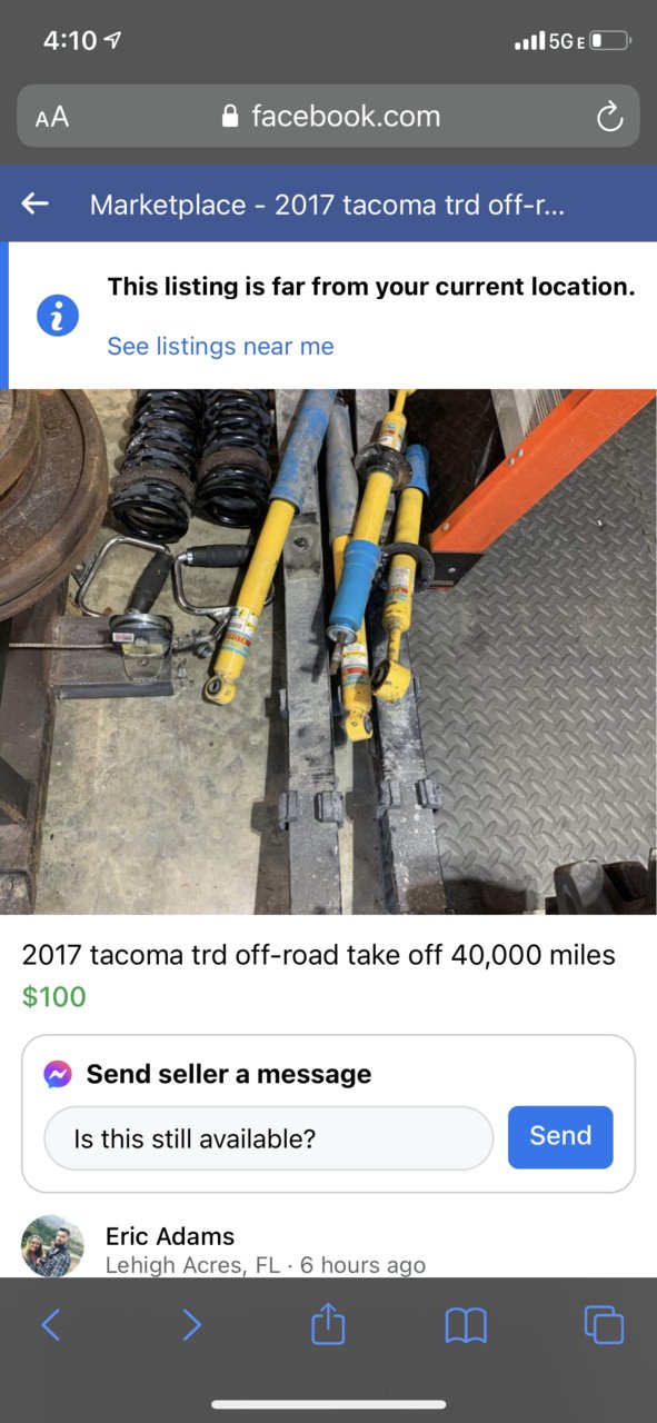

    The suspension on my 2012 RC 4x4 feels pretty worn out. Looking for a replacement on the cheap. Would this be a decent replacement? The details say it’s missing strut mounts some bushings. Any idea what kind of cost I’m looking at to purchase those?
    Thanks!

    You should be able to get all the rubber replaced for under 50 bucks. You can usually buy the parts on eBay or wheelers. You'll get a small 1-inch lift or so in the front. 40k seems a bit steep. If your hardware is worn out. I'd go full 5100s and never look back. Costs a bit more but your not gonna be looking for shocks in the next year or two.

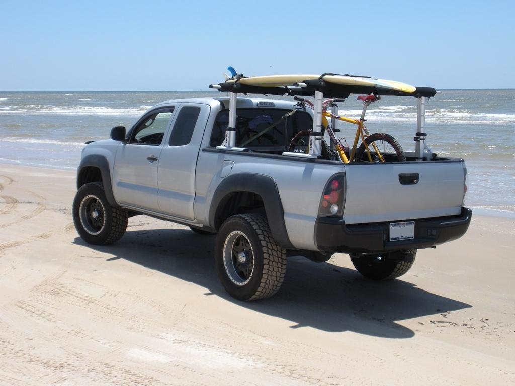

    Mine is 5100 at 3rd notch (0, .85, 1.75) with 1/2" top plate spacer on each with stock sr5 springs. Ride is just right. Probably close to 2" lift. Rear is just oem 4 leafs and 5100s. Much better than 3 leaf, no more wheel hop, about 1" higher than before. Overall ride is nice, way less body roll and rear is 1.25" higher than the front.
    My old 05 AC was set at 4th notch 2.5" on oem springs and it was harsh compared to the RC on 3rd notch. It had 1.5 AAL with 3 leafs and was still tail high about an inch.......and fit 18" 285s with minor plastic trimming ....................
    Would think most aftermarket springs up front will make RC stiff ride without plate bumper and or winch to compensate. Out back with 4 leaf and 1.5" aal should be good for shell and a bit more weight full time on RC. If not go multiple leaf AAL if more full time weight is required. Still ride ok and have longer lasting carrying capacity longevity.
