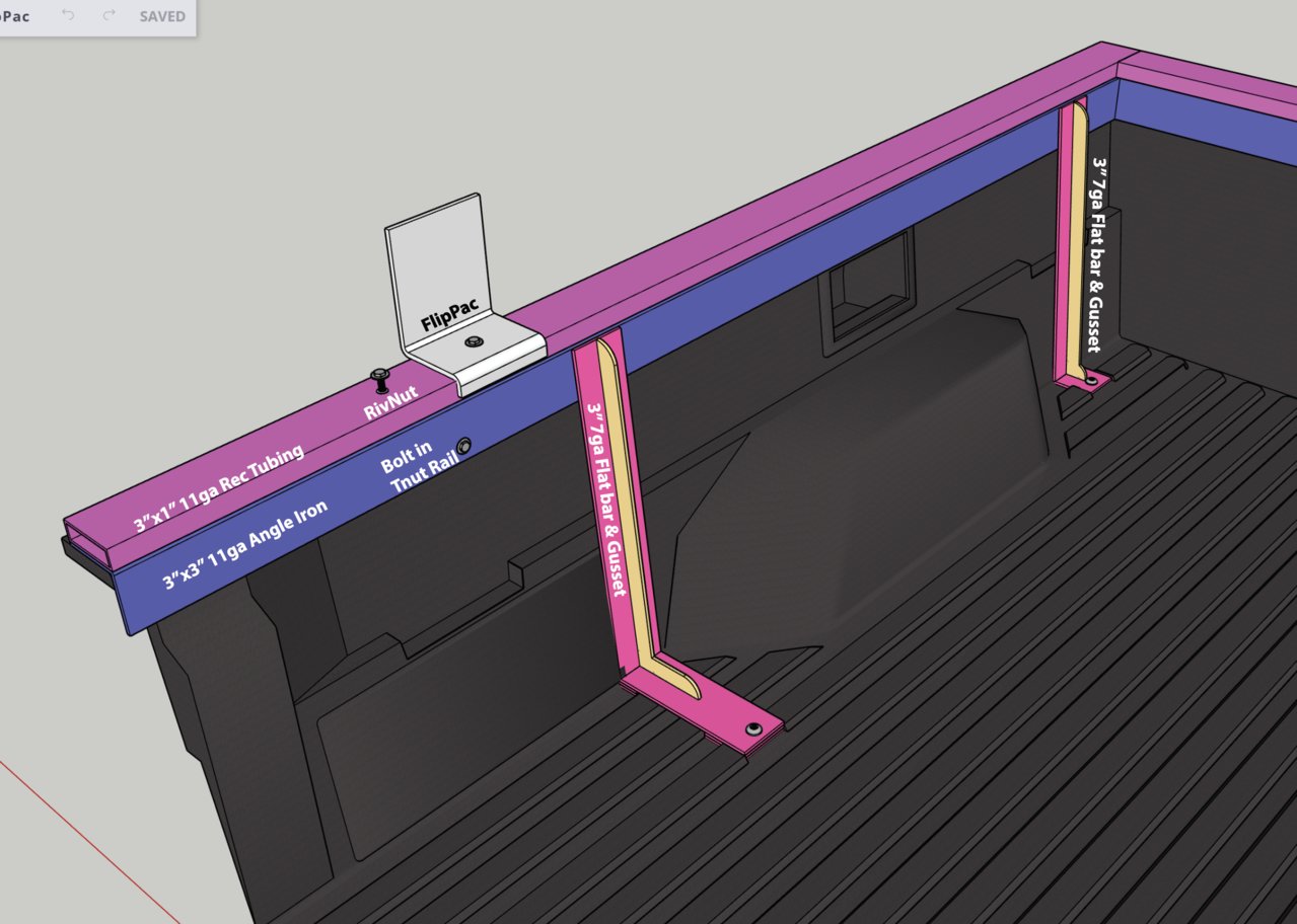

    Ya I've been working on something kinda like that. I'm not an engineer by any means but figured this might take some of the load off the bed rails and transfer it to the bed/bed mounts. If anyone has any thoughts I'm open to input.
    All of the adjoining metal would be welded together.

    Looks nice! I know how people prefer to not have anything going across the bed, yet making a couple easily removeable turn buckle / tie rod / cross member thingys with some T nuts probably will stiffen things up on uneven terrain and then remove them for camp.

    Ya I was planning on something like that, maybe adding in a couple eye bolts toward the tailgate and use some sort of strap to stop it from spreading.
    I’m planning on using those Tnuts to help hold the angle iron to the bed rail. So idk we’ll see if it all works I’m hoping to go get the steel this week and try the experiment out.

    Ya that rear crossmember is expensive but shoot dang free 99 is always great I think that might even be worth shipping haha Fastenal maybe?
    That corner gusset up top is a good idea. I do have the total chaos bed stiffeners now so definitely good on that front at least. I appreciate the input for sure!

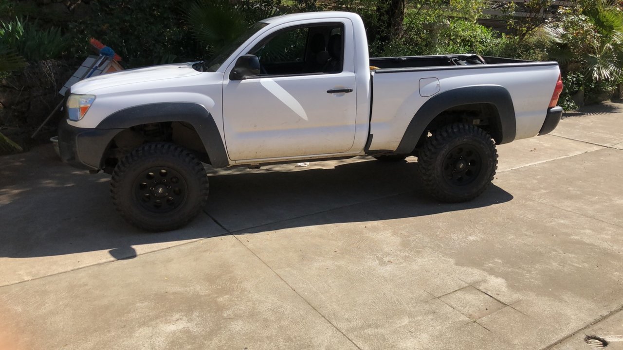

    I’ll join the party. I decided to upgrade from the stock 245/75/16 to 265/70/16. Since the diameter is the same, I haven’t noticed any difference in drive ability, and now it looks like the 4x4 it is. I still need to get out and get the tires dirty though...

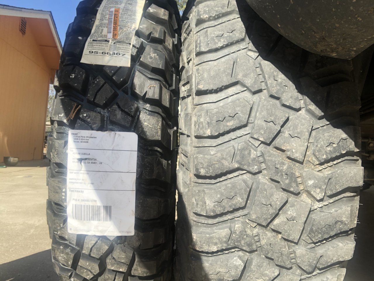

    New tires talk about pizza cutters:
    7.5 r16 bfg km3 on procomp 7069 16x8’s
