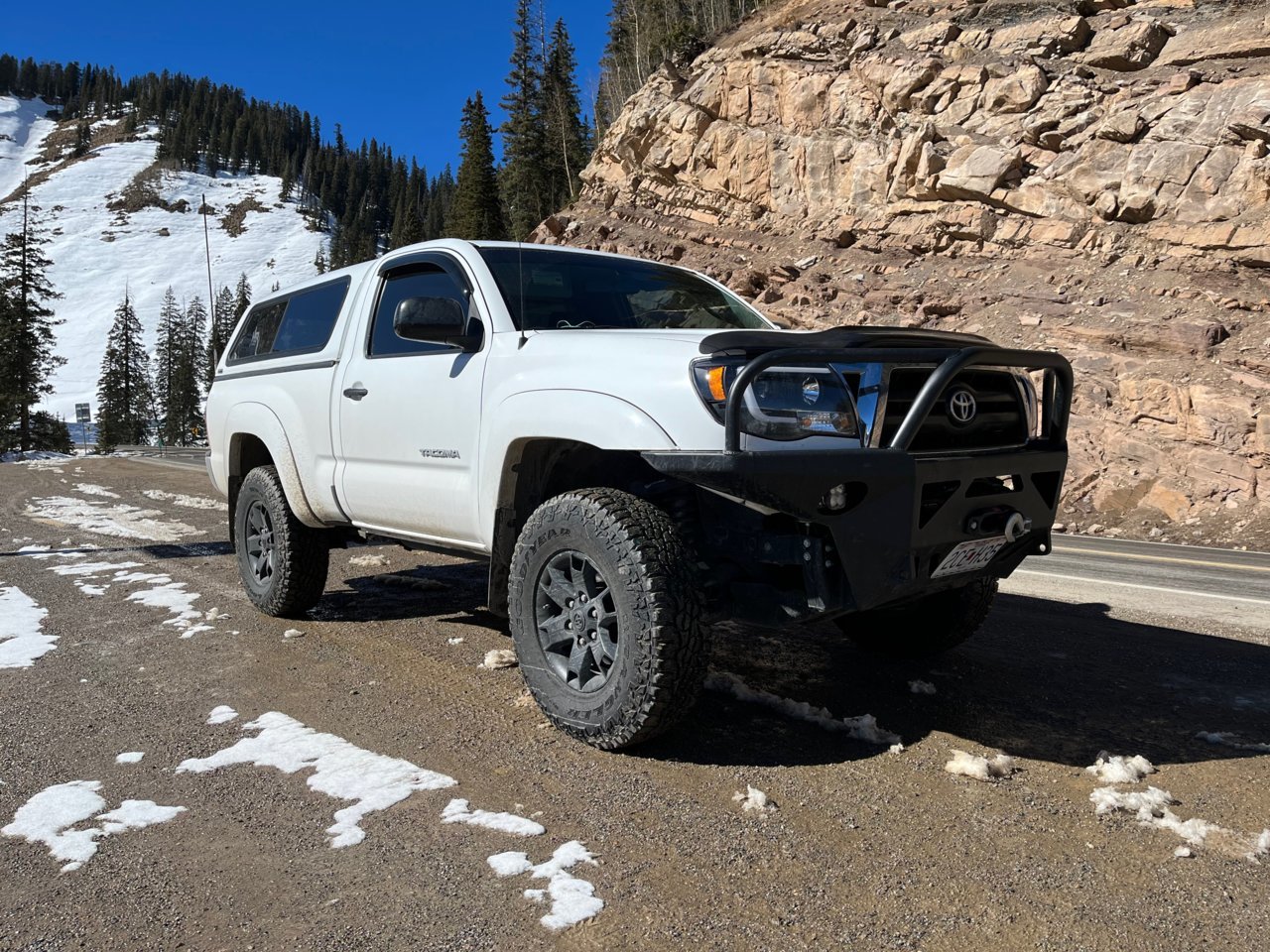

    I have also had the KO2 and I won’t run anything now but KM3’s. I am on set number 6 on 4 different trucks without a single issue.

    What size are these? 235/85r16?

    They are a weird size it’s just 7.5 R16, they are fantastic

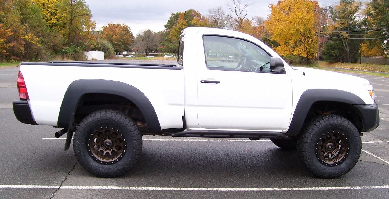

    Speaking from personal experience, I would definitely not go bigger than 885. I went 884 because I did a deaver AAL and wanted less rake, a little more level. I ended up with probably about 2.5 inches or more in the front and I don't think it settled much. Its about a half inch higher on the passenger side because I didn't compensate for the notorious "taco lean". The ride is pretty smooth and I ended up adding an aluminum full front bumper and a warn 8k winch. probably around 120 lbs or so added to the front end and I don't really think it settled at all, maybe a quarter inch? I still have at least two inches up front so if you're wanting a solid 3 or close to it I would do 885. 887 would be way too stiff for our trucks from my understanding.
    Here's a picture of my baby, I was honestly hoping the front end would settle to 2 inches but idk if it will. I have had the coils for about 1.5years and added the bumper and winch in November. It's got about 3/4 to an inch of rake in the rear which isn't much and when I add much of a load it starts to look kinda squatty. Don't go AAL on these trucks folks! I would do a full leaf pack if I had to do it again!IMG_2373.jpg
