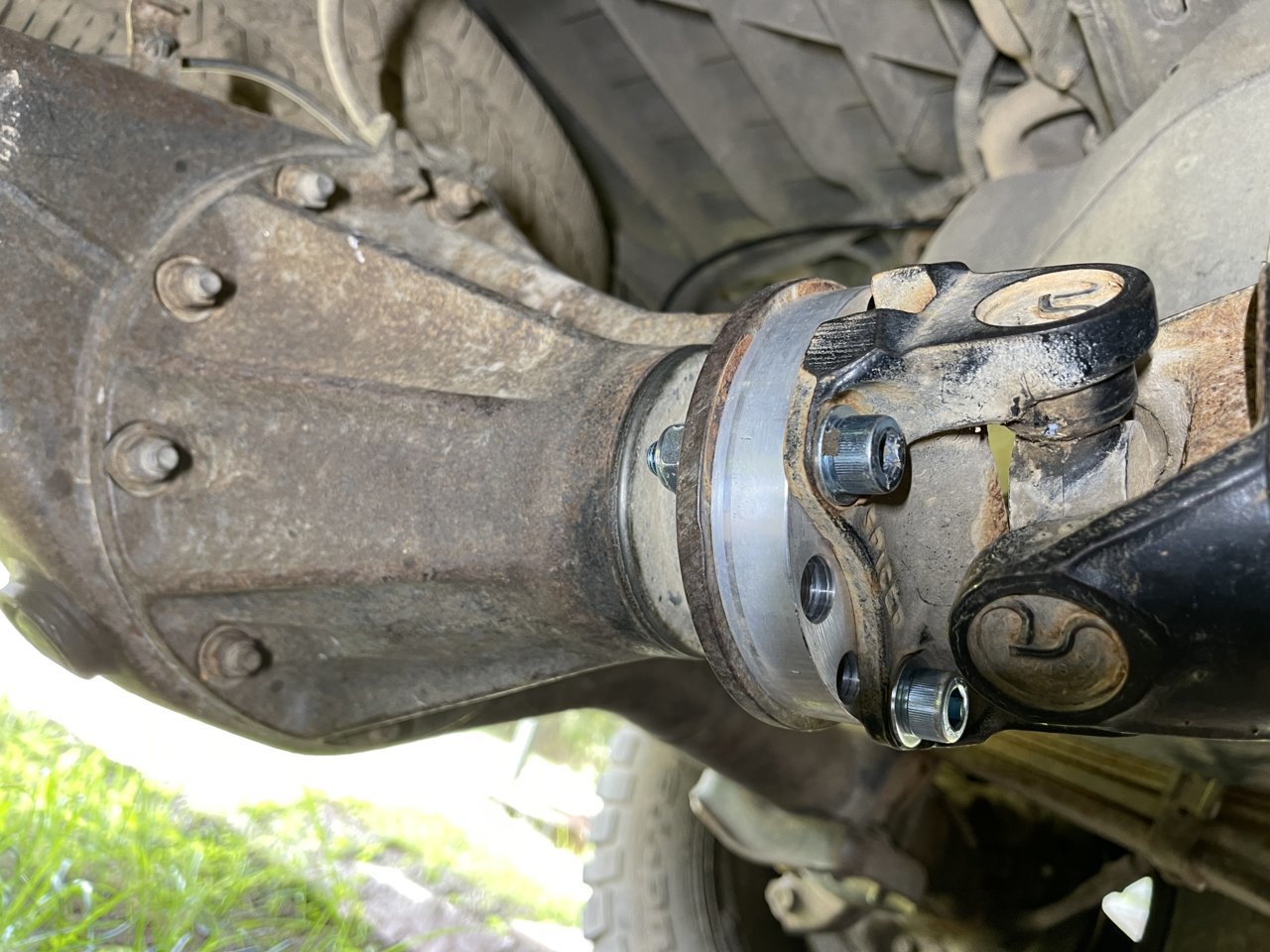

    I went back through some of my posts and I had forgotten that I did have a slight vibration in a specific mph range (I forget the exact spot, but I think it was around 68-70 mph). So I would either keep it around 65-66 (which is the best mpg range with the auto) or slightly above 70.
    The 5 speed issue was that the lift would pull the slip yoke out from the trans resulting in vibration or grinding. One solution was to put a spacer between the driveshaft and diff which would push the slip yoke back in. Try a search on that regarding regular cabs and see what pops up. 4Crawler used to sell custom spacers which helped quite a few people. Here's a link to his page with info on measuring what thickness you would need but I'm not sure if he is still selling/making them.
    4Crawler Offroad Products - Driveshaft Spacers for Toyota, Ford, Dodge & Chevy Vehicles

    I installed a 3/4 spacer on my rc it’s a 5speed and really couldn’t tell much of a difference, still get grinding and vibes at 70ish. One thing to note is that either the indent on the nut that holds the flange to the tcase was either never staked or someone had replaced a seal but mine was very loose torqued it to speck and restaked it may want to check that.

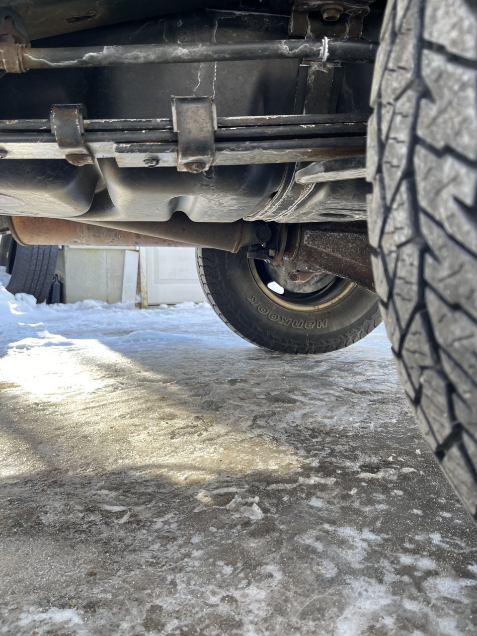

    You're stock height? I don't remember what my pinion angle looked like when my truck was stock but yours points straight at the driveshaft, it looks like in the picture. I think with a short wheel bas 4x4 truck, it should be pointed down a little bit more, maybe your suspension is worn. When under load, your pinion will point up even more and that may be causing your vibes.

    That’s kind of my train of thought as well, though i just climbed underneath and noticed I could get a little play in the slip joint. Tiny amount but enough to hear it. Could that be the issue or is a tiny bit of slip joint play normal? I’m not a trained mechanic, just basic stuff like power steering lines and springs and motorcycles and shit

    Yeah I’m stock height but with a leaf pack from an access cab to get the extra leafs. I installed myself. Don’t think there’s any way I could’ve changed the pinion angle by bolting the u bolts on wrong right? Axle sits on the springs with a square portion so I don’t think a leaf spring swap (with no lift gain) would mess up the angles. At first I thought “oh maybe I overtightened 2 of the 4 u bolt nuts but I don’t think that would change anything really?
