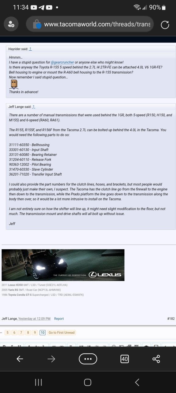

    Well @daveeasa there you go. Apparently I was giving the wrong info‼️ What’s F-ing new⁉️ :frusty:
    4.0L and a few bolt on’s should really go in the lighter reg. cab.
    Sadly I don’t *think* there are any aftermarket cams like the gutless 2.7L but I don’t really know!
    @Torspd Im sure you would know. Sadly the aftermarket support is nowhere near as strong as it is for the LS platform! I purchased the new cam from Summit for the 5.3 for $269 shipped.

    Yeah, I was surprised to find this out. I am quite a fan of the Toyota 4.0. I just need a donor truck though so the search is on.

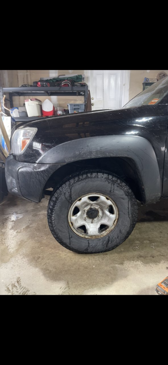

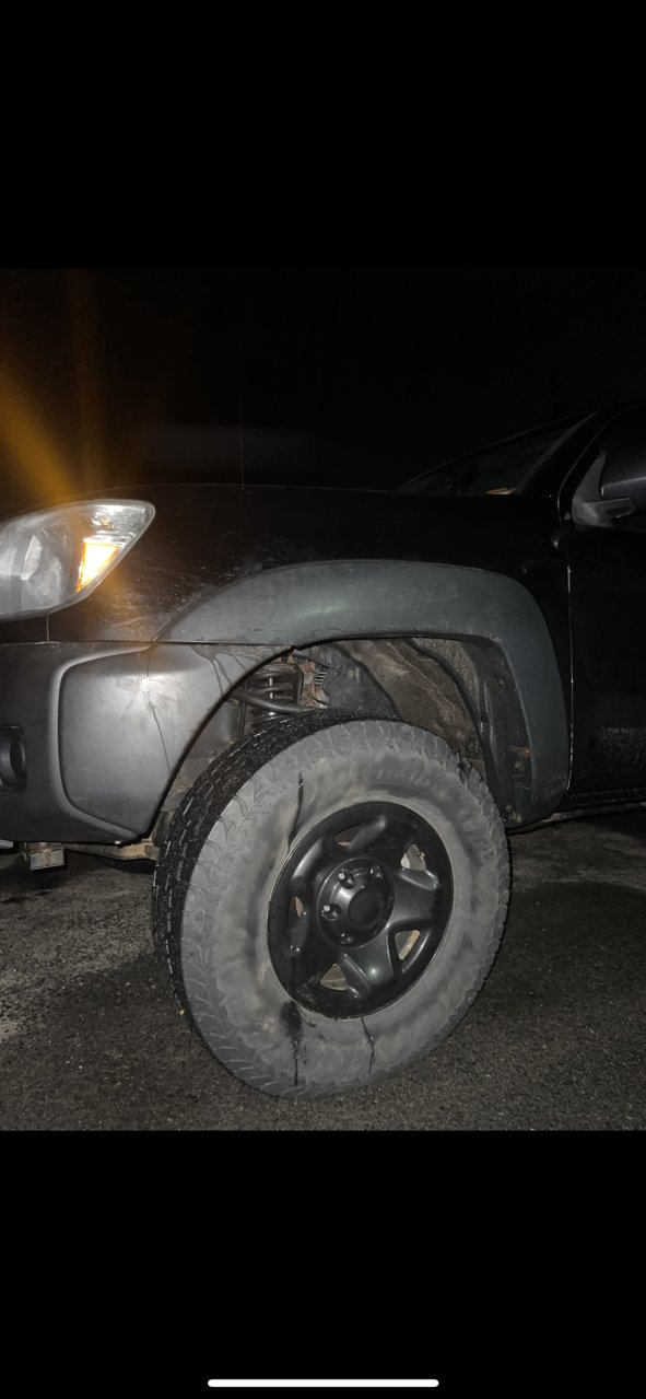

    I did it, y’all! I got the upper strut mount off. I had to literally hand-saw in half the stud on the inner side AND drill holes in the flare of the nut and hit the holes with the corner of a chisel until it spun, but I finally did it! 5-6 hours on the drivers side getting the lay of the land, would’ve been a couple hours passenger side but the strut mount bolt AND the ball joint castle nut stripped. Cut off the ball joint, then decided I might as well replace the whole UCA. So probably 10-15 hours on the passenger side including runs to the parts store.
    Kit was an Eibach Pro Truck strut (stock coils) and I set it to second highest perch (1.6” est on the instructions). Rides about the same as stock if not better. I specifically chose the Eibachs as I heard rumor that they’re valved better for potholes and things than the 5100s. Could also be that I was on original shocks from 2012 in the pothole-infested rust nest we call New England.
    Had it up to 50 mph and If there are any new vibes, I don’t feel em but my tires are cupped and I have been chasing various other vibes too. I turned on 4x4 and no difference so I don’t think I got any new vibes!
    Got 1.5-2” add a leafs on order, I’m on a 4 leaf oem pack but they’re a little sagged. AALs should be here sometime by Sunday. I figure they’ll be fine with the bilstein shocks I have in the rear, expecting to net 1.5”-2” over stock initially due to low weight of reg cab, but then settle to 1-1.5” over stock due to worn out rear leaf packs. My goal was a lift with no crazy cost or vibes, and still have slight rake (I think reg cabs look tough and sporty with the rear a bit high, plus I don’t wanna be dragging when the bed is loaded down). If the leafs go in smoothly, I think I’ll have what I set out to do suspension-wise! It’s been a long time coming as I’ve wanted a lift ever since I bought the truck in 2017! Here’s a little before and after teaser!

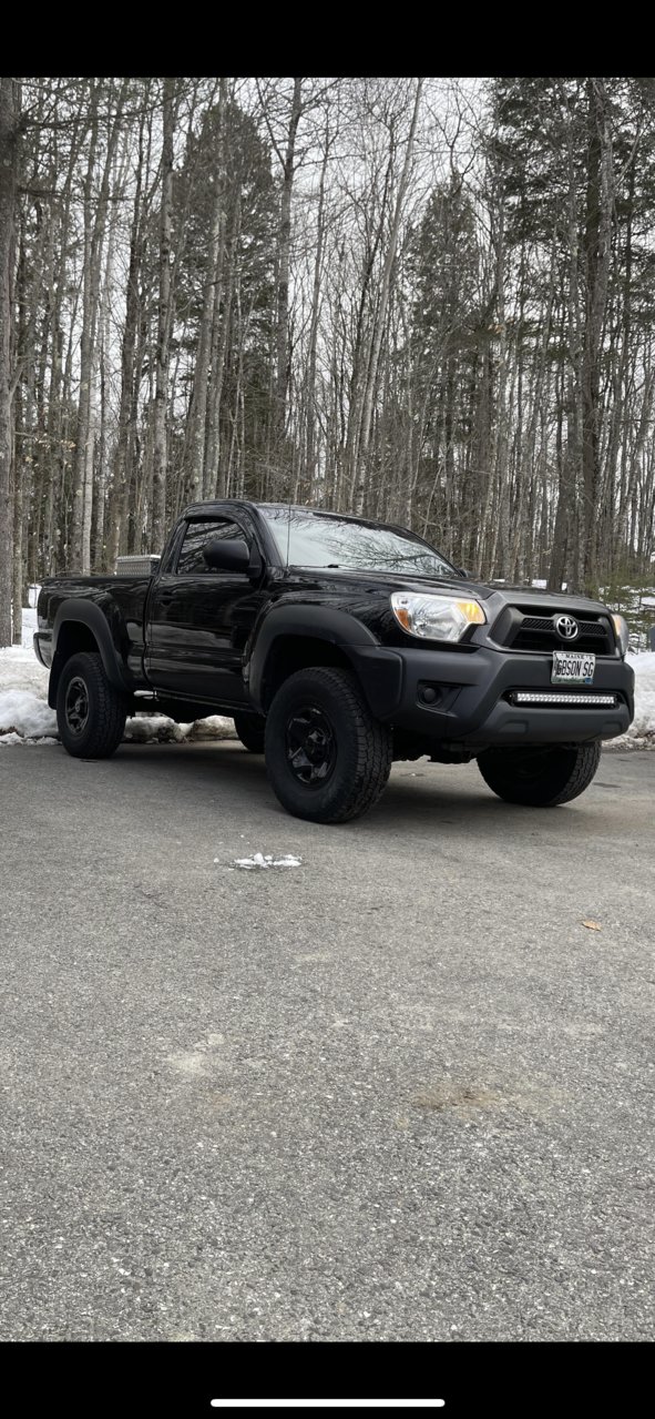

    How she’s sitting now. Add a leaf should be here today

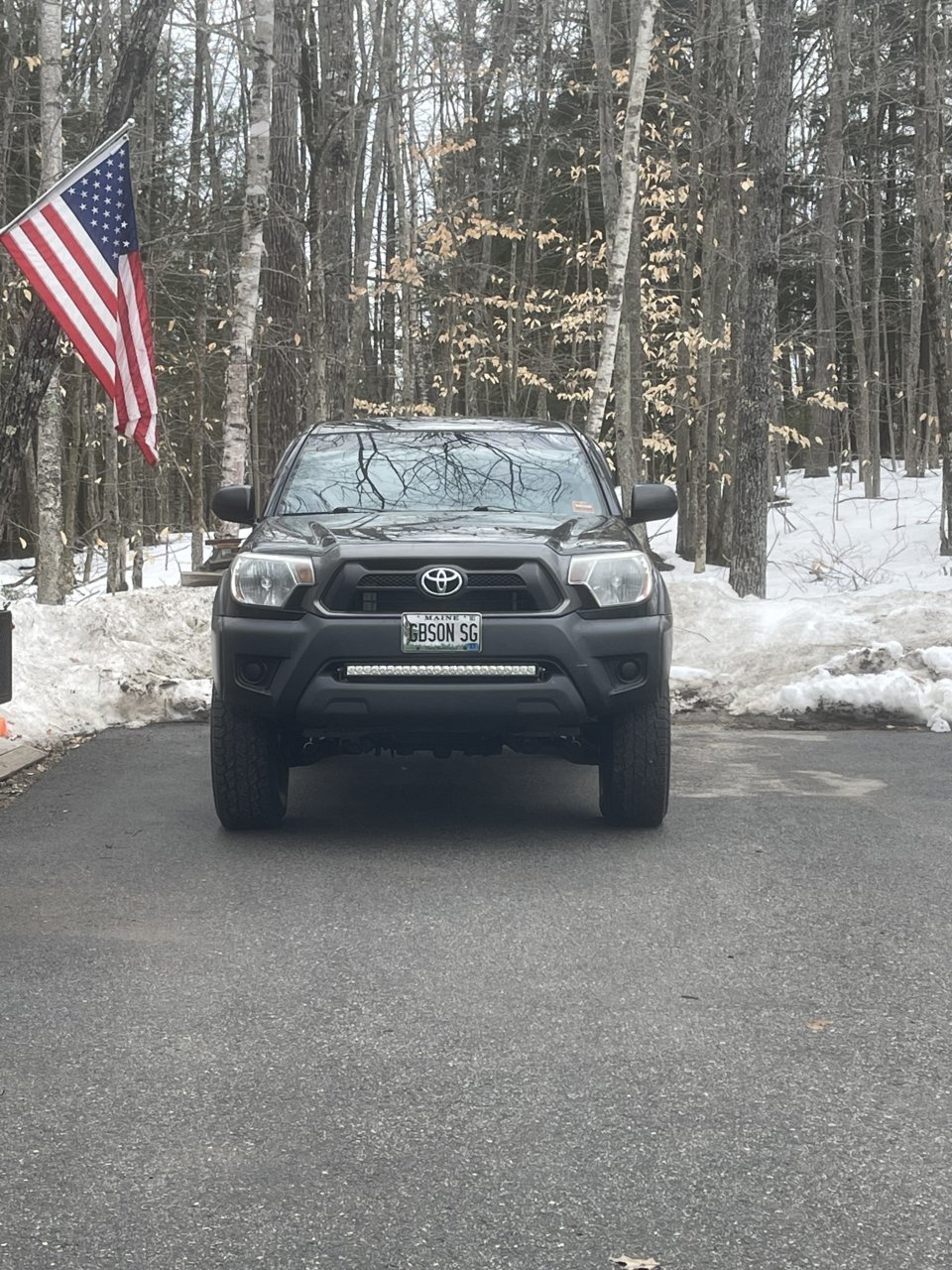

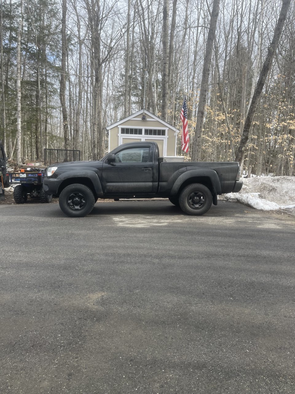

    She’s done! AAL is in! Extremely slight vibe at 25-30 but not enough to bother me, and as the AAL settles down it’ll only get less noticeable. Got what I was hoping for! Bout slight lift all around (haven’t measured) and keeping some rake for dump runs and whatnot! Now I don’t worry about slamming my bumpstops either lol
