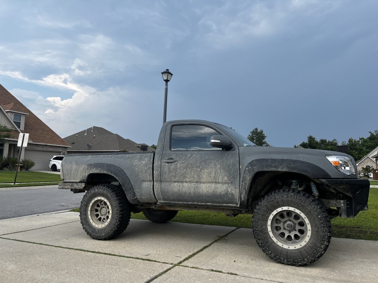

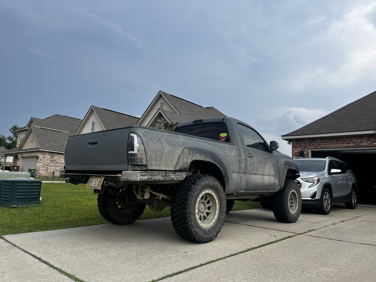

    I threw together a high clearance rear bumper and threw the truck down some trails, being in the south it’s nothing but deep mud. Truck blew me away pulled out of every hole, 35’s and a locker we’re definitely game changers for that

    Hows the 2.7 with those tires? And the ride with the kings? I think my Fox 2.0s are oversprung for the regular cab, and an contemplating swapping out to lower spring rate coils and/or adding a front bumper for more weight.

    The ride is awesome. But the ride comes from the shock valving mostly, I had mine tuned by AccuTune, 600lbs springs and it feels amazing. I re-geared the axles to 5.29’s, so it pushes the 35’s just fine. Id do 4.88’s if I could do it over

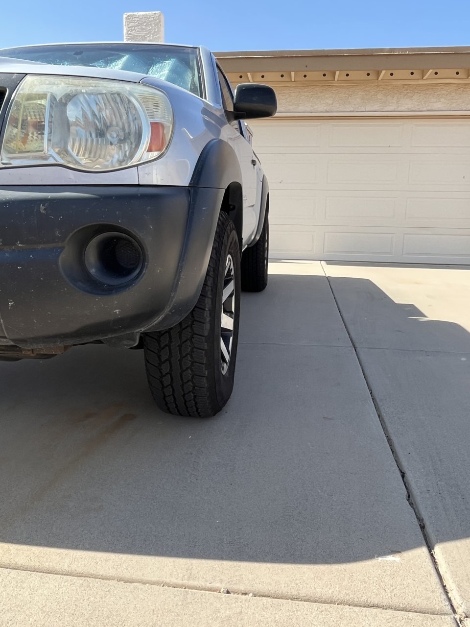

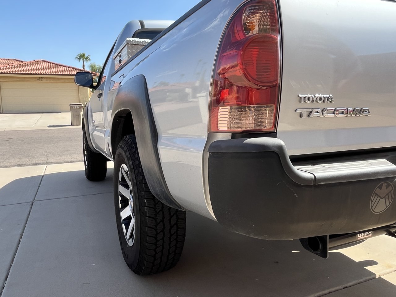

    2005 silver Tacoma 4x4 std cab
    Toolbox, late model 4Runner TRD wheels; Firestone 255/75x17 AT2s
    Multi-year lurker
    Great site!

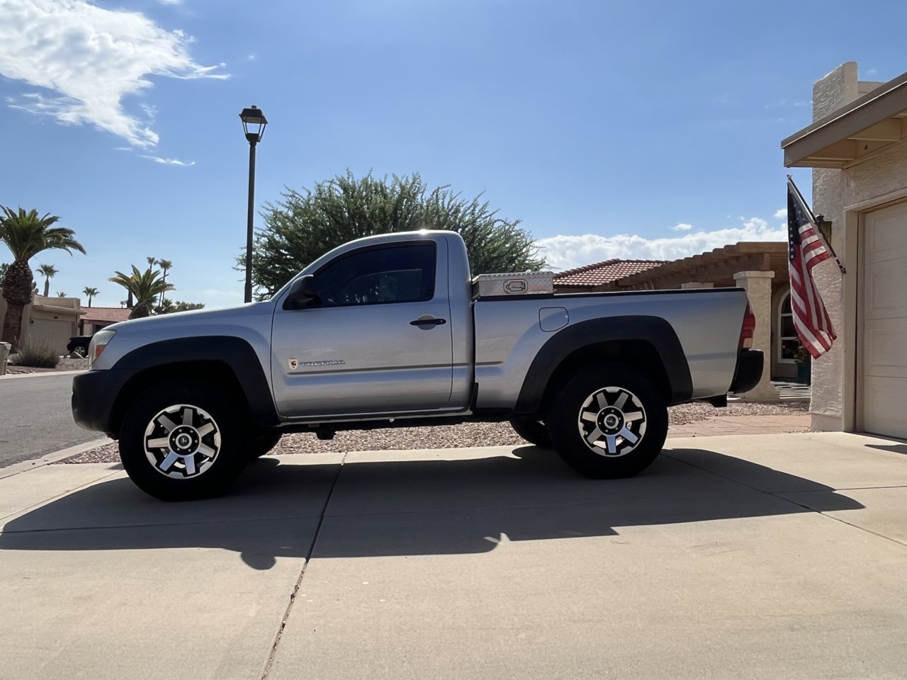

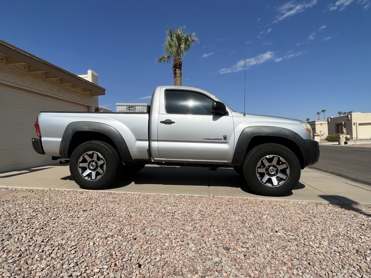

    Got my reg cab in 2019. Had 119k miles. Has 146k now.
    All stock except for the wheels/tires which are 32s AT2 255x75 stones on late model 4Runner TRD 17s. No rubbing so far on lock2lock turns. I don’t rock crawl but the places I’ve taken it I don’t see rubbing anyplace. Got the wheels for a great price and just wanted to see if they would run on a stock setup. The look is growing on me and of course I’m a reg cab fanboy and despite the lack of power loaded down on the hwy in the mountains I love the 2.7.
    Keep the rubber side down and be safe.

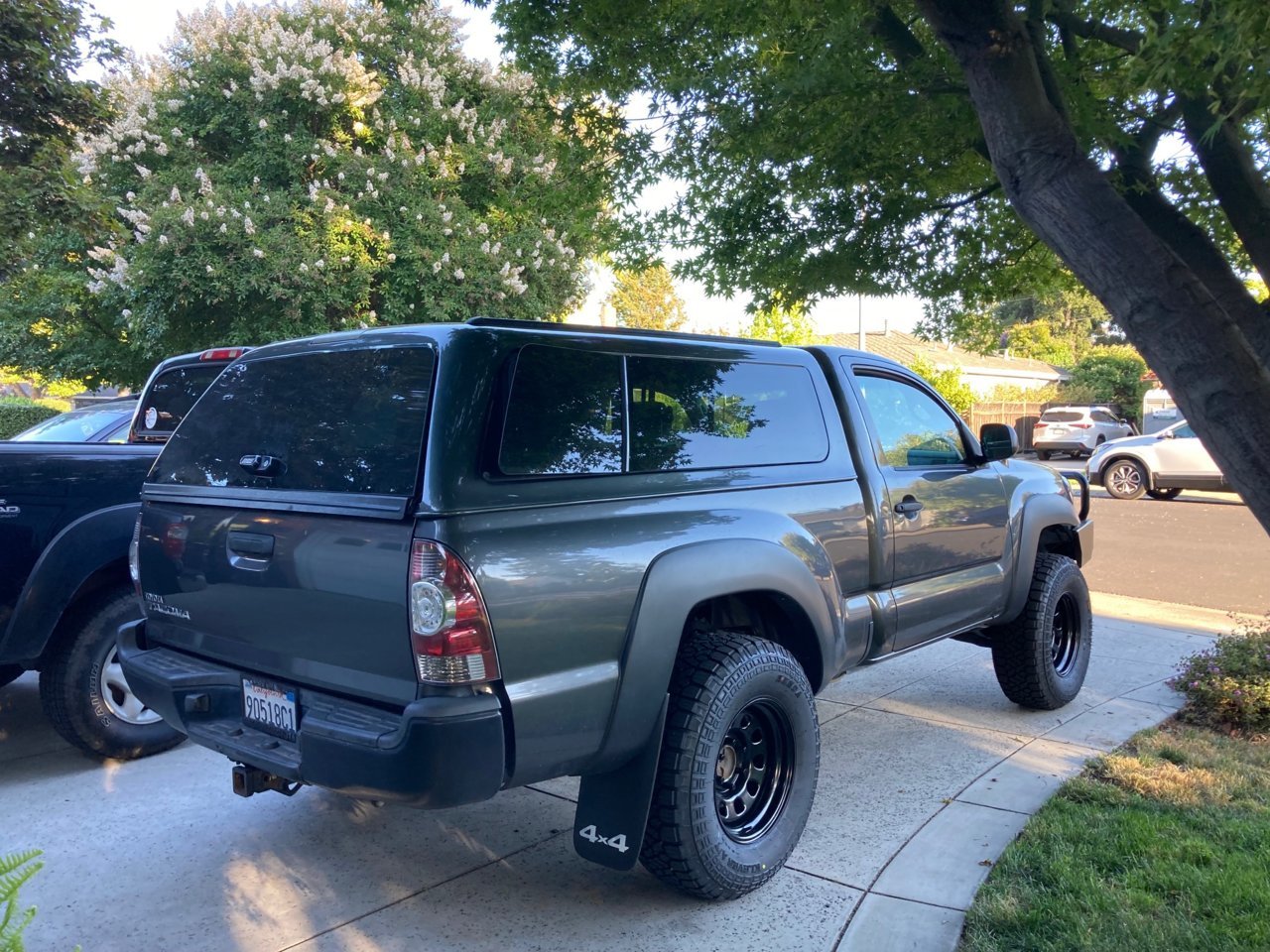

    My rig

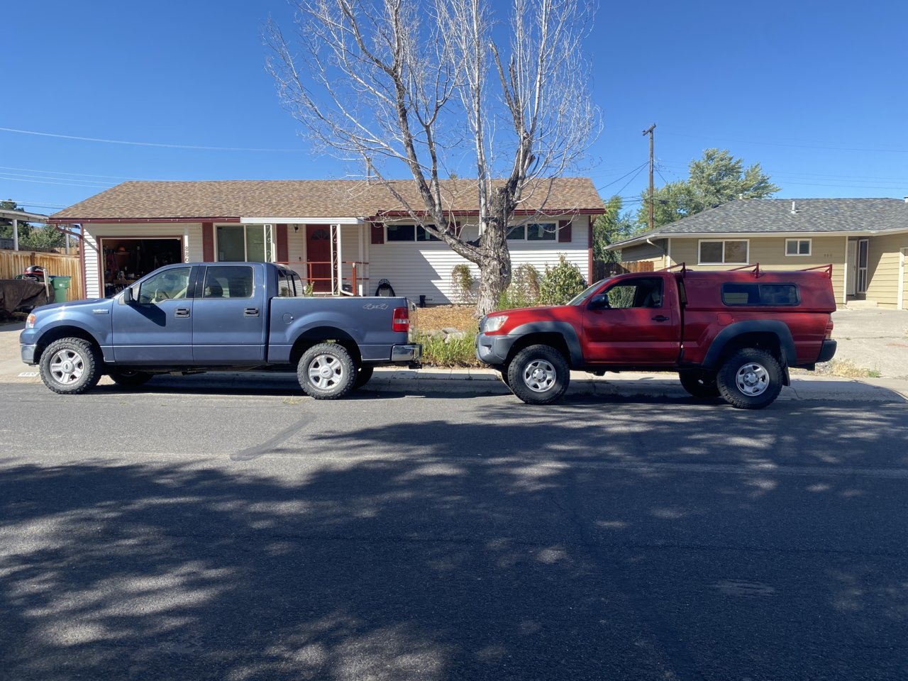

    A better picture of the lift compared to a stock F150.
