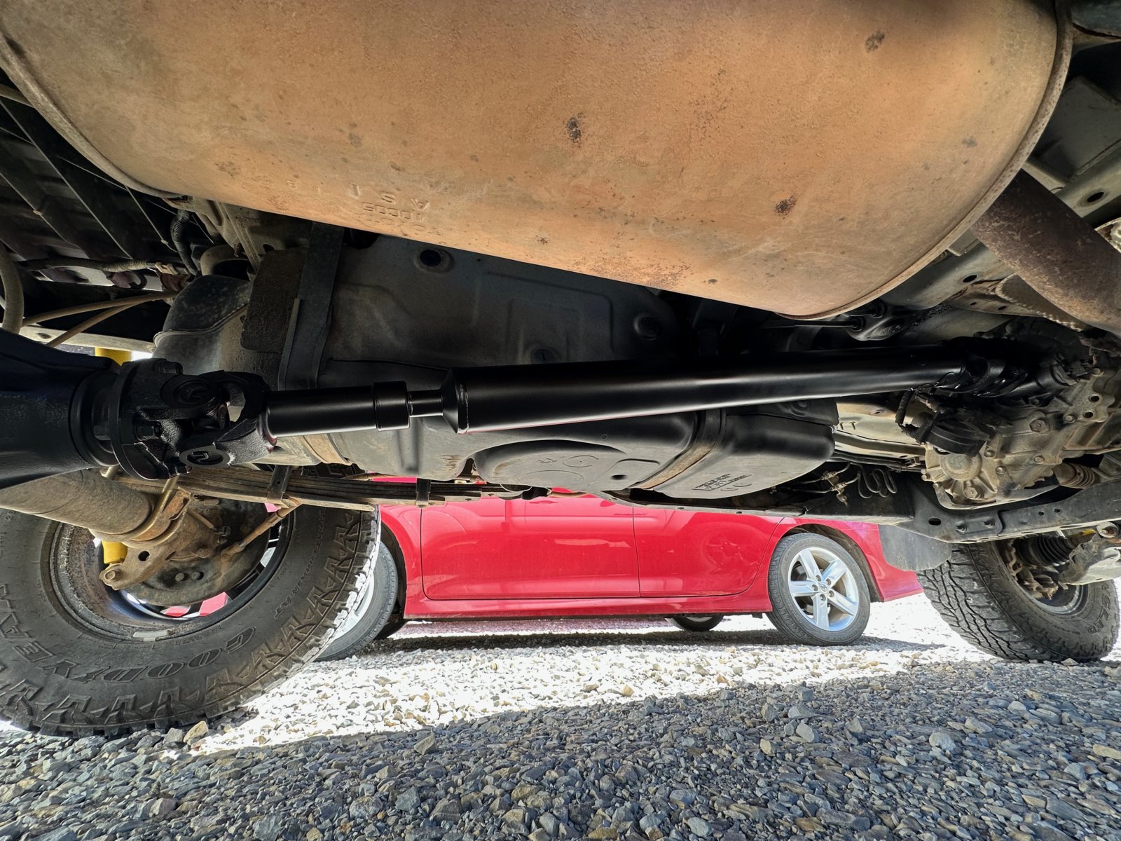

    Local Driveline shop. A good shop should be able to make you a nice custom double-cardan shaft; they'll just need to measure the distance between the output on the T-case and the pinion. Lots of people recommend Tom Woods, but I have heard their U-joints are junk if you actually go off-road.
    Mine's got quality Spicer U-joints (sealed) However, the slip yoke and double-cardan joint are greasable. It was right around $600 and well worth it in my opinion. I refused to live with the vibes. I guess people do, but honestly, who really wants a truck that has a noisy driveline and vibrations?
    It should solve your problems but only if you set it up correctly. If you don't know, research how a double-cardan works. https://4xshaft.com/blogs/general-tech-info-articles/driveshaft-angles You want the pinion pointed up a bit. In a regular 2 joint driveshaft (OEM Toyota) you want the input angles to be the same degree of operating angle so they cancel each other out. With a DC you want the pinion pointing up a bit, almost straight at the shaft. For my 3> inch lift, 2 degrees achieved this. There needs to be a slight degree of operating angle on the pinion end.
    It may be difficult to see in the picture but notice how there is a very very slight (maybe 1 degree) of angle at the pinion end while the double-cardan at the the transfer case is what takes up all the angle.

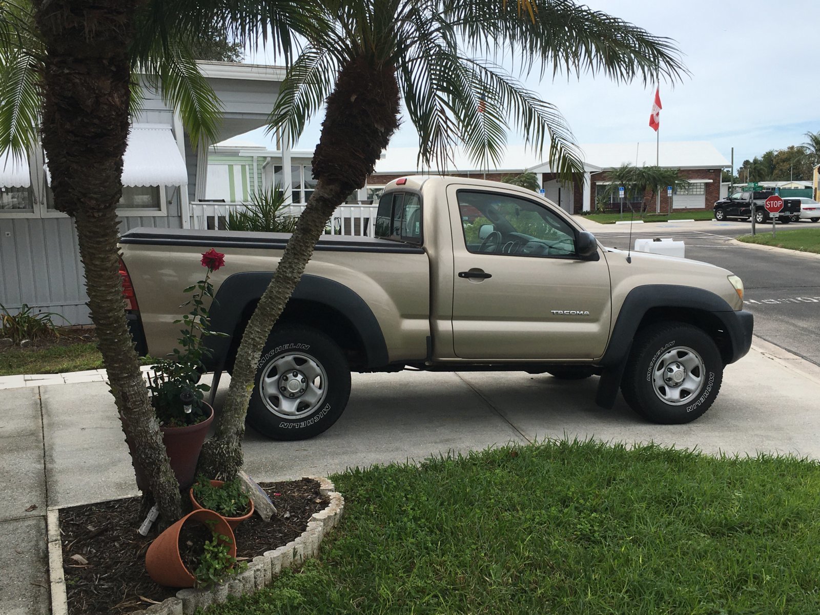

    I have posted mine up before in other threads but I guess I will post it up here as well.
    2012
    Black
    2.7
    5 speed
    Completely stock but want to add scheel-mann seats.
    I run scheel-mann seats in my other rides but not sure how to do it in this Tacoma with the occupant sensor, seat belt sensor, and air bag sensor issue.

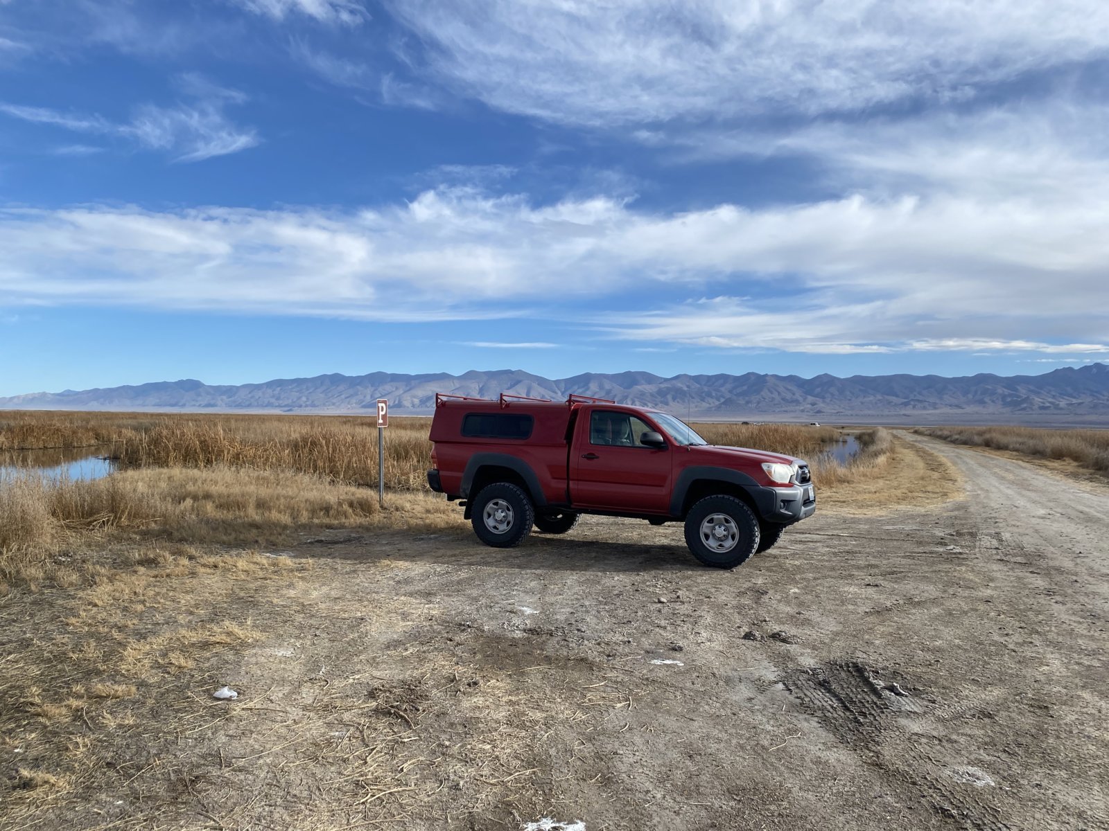

    2014 Taco Reg Cab 2.7, auto, 4x4, 4.88’s
    2.5” 5100's Icon delta UCA, Icon RXT leafs 255/85r16, 4.88’s
    Thank you for your fix on this!!! Very interesting.
    My truck makes the same noise - typically 65-75 mph. Haven’t had any noticeable to me vibrations yet, plus I grease up the zerk fittings when I can so I don’t worry too much about it (although perhaps I should a little more concerned…)
    Truck performed well in the snow during our snow storm this past week.

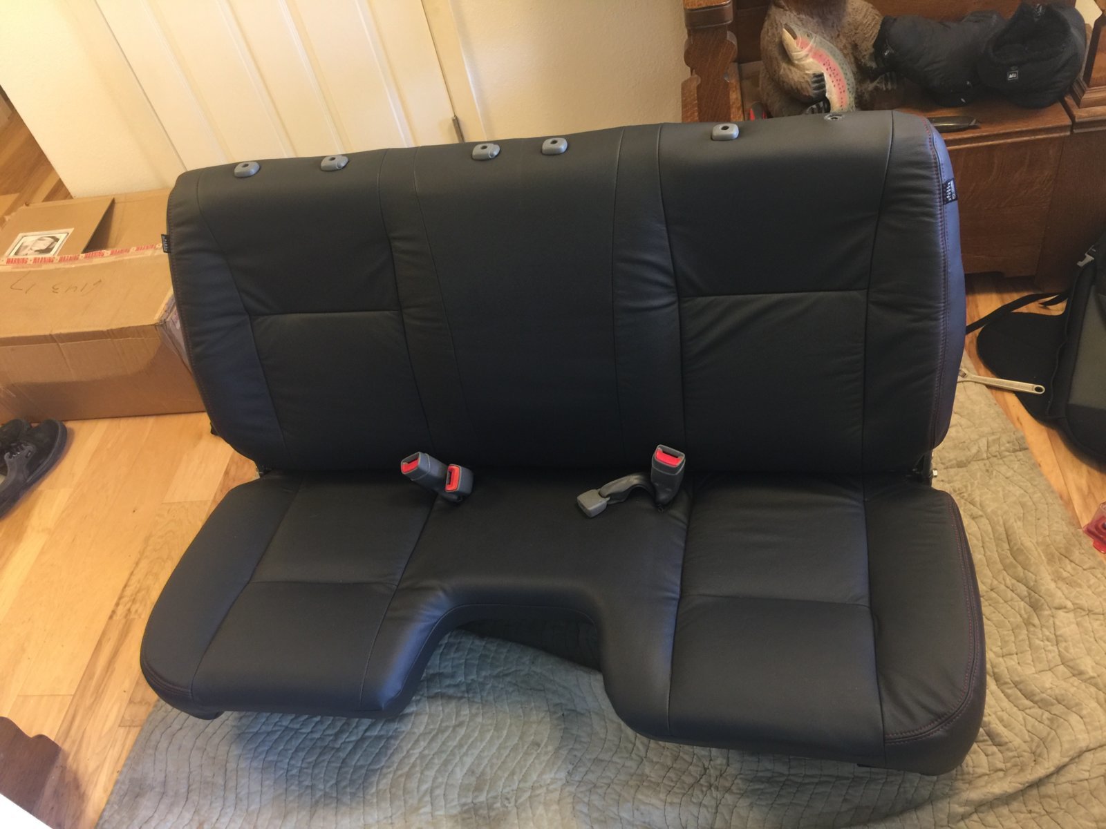

    Here was my 2014! Bought new from Toyota. Unfortunately I wound up selling it to a family friend back in 2018. I will most likely buy this truck back by the end of the month!
    5 spd manual
    OME Lift
    Dakar Leaf Pack
    Leer Canopy
    Bench seat mod
    255s
    Katzkin Leather with heated seats

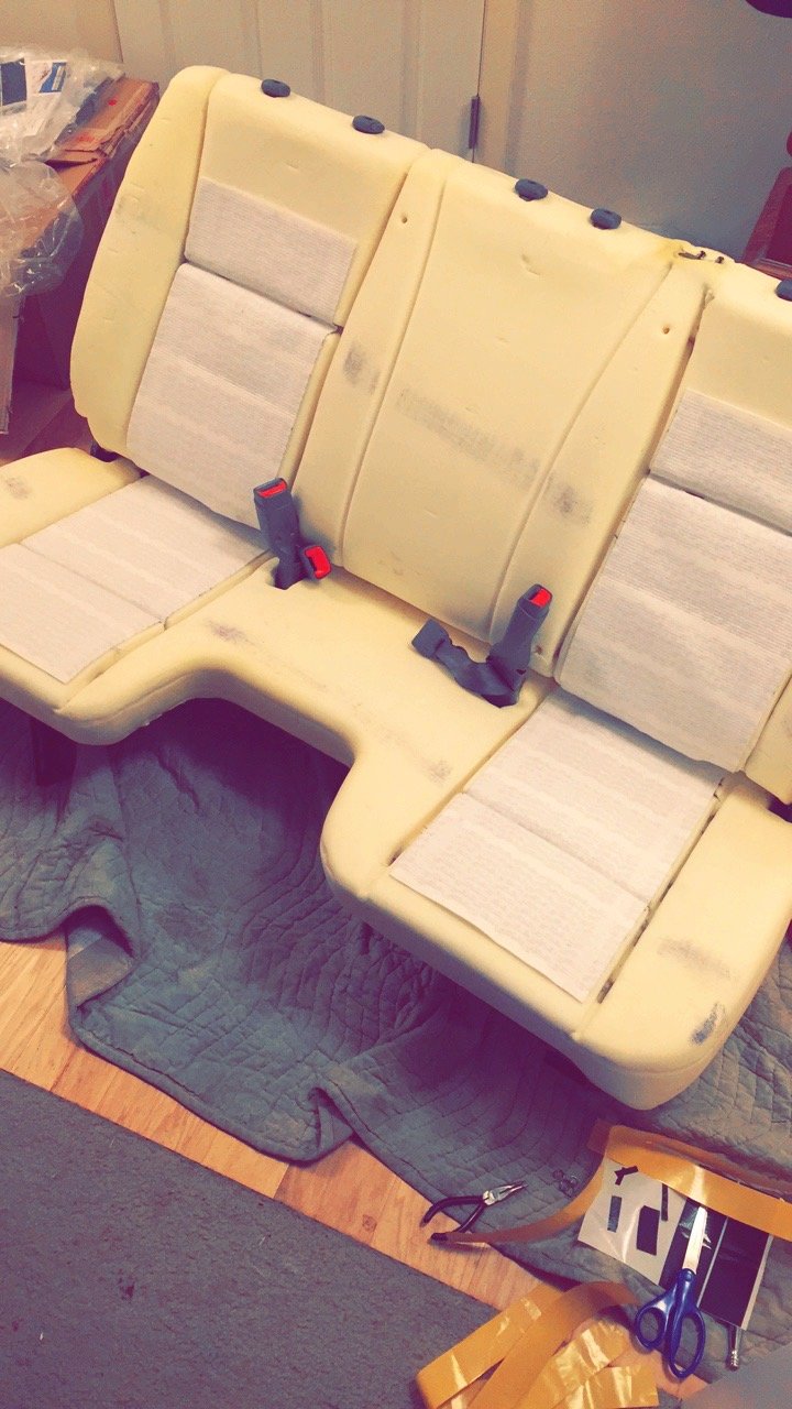

    I've been thinking about the Katzkins since I bought my truck 6 years ago and this is the first picture I've ever seen on a regular cab. Got anymore?
  19. Feb 8, 2024 at 5:30 AM
    mkhawks44
    mkhawks44 Well-Known Member
    Jan 20, 2011
    #49608
    86
    Oregon / Kansas
    2014 Barcelona Red Reg Cab
    I did the install myself, both the heated seats and the leather install. It is a time consuming process, but was able to knock it all out in one day. It was totally worth it. Just take your time and don’t rush it. The hardest part for me was getting the leather around the headrest without tearing the leather (recommend two people for this part). A steamer to heat up the leather is a must to allow it to have some stretch to it. These are the only photos I have at this time. All the “wrinkles” worked themselves out in about a week of having the leather installed. IMG_1556.jpgIMG_1557.jpg
