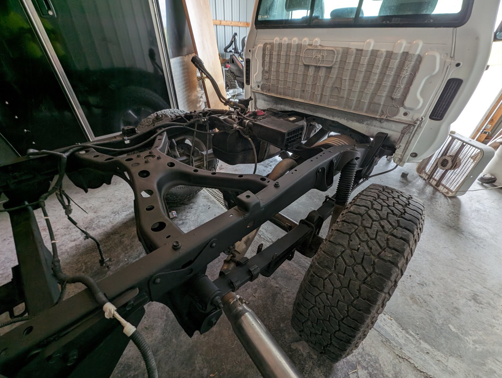

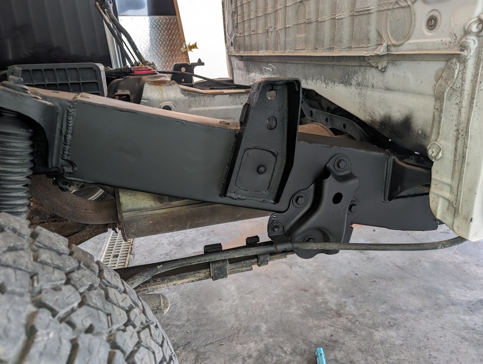

    Speaking of frames here a controversial one for you all. I had a small hole start to form on my frame. Instead of junking a good working truck I got to work on repairing it. Safetcap makes a good product. Cut out the rust that was in the inner portion of the frame, had a welder add the sleeve, then used rustoleum to paint the whole rear. One of my body mounts had a hole forming in it also so that was replaced with one from Alpine Designs. May not stop it but it'll at least put it at bay for the time being. Can't afford a new truck but I believe this is the next best thing.

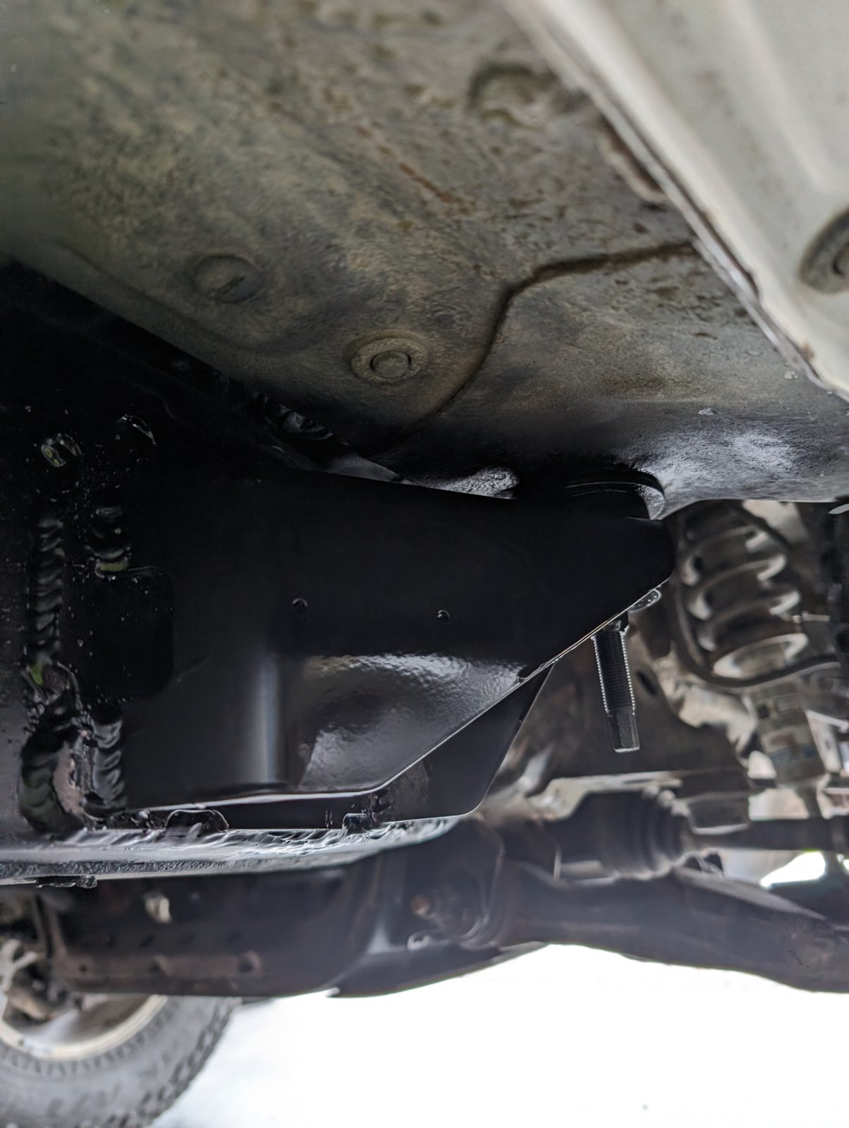

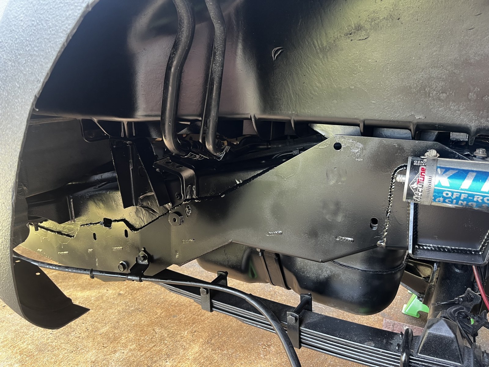

    JD fab frame brace is on, and works good. Chose to weld it on instead of bolting on, lots of work but I think it’s worth it. Truck is freshly detailed and about to go on marketplace

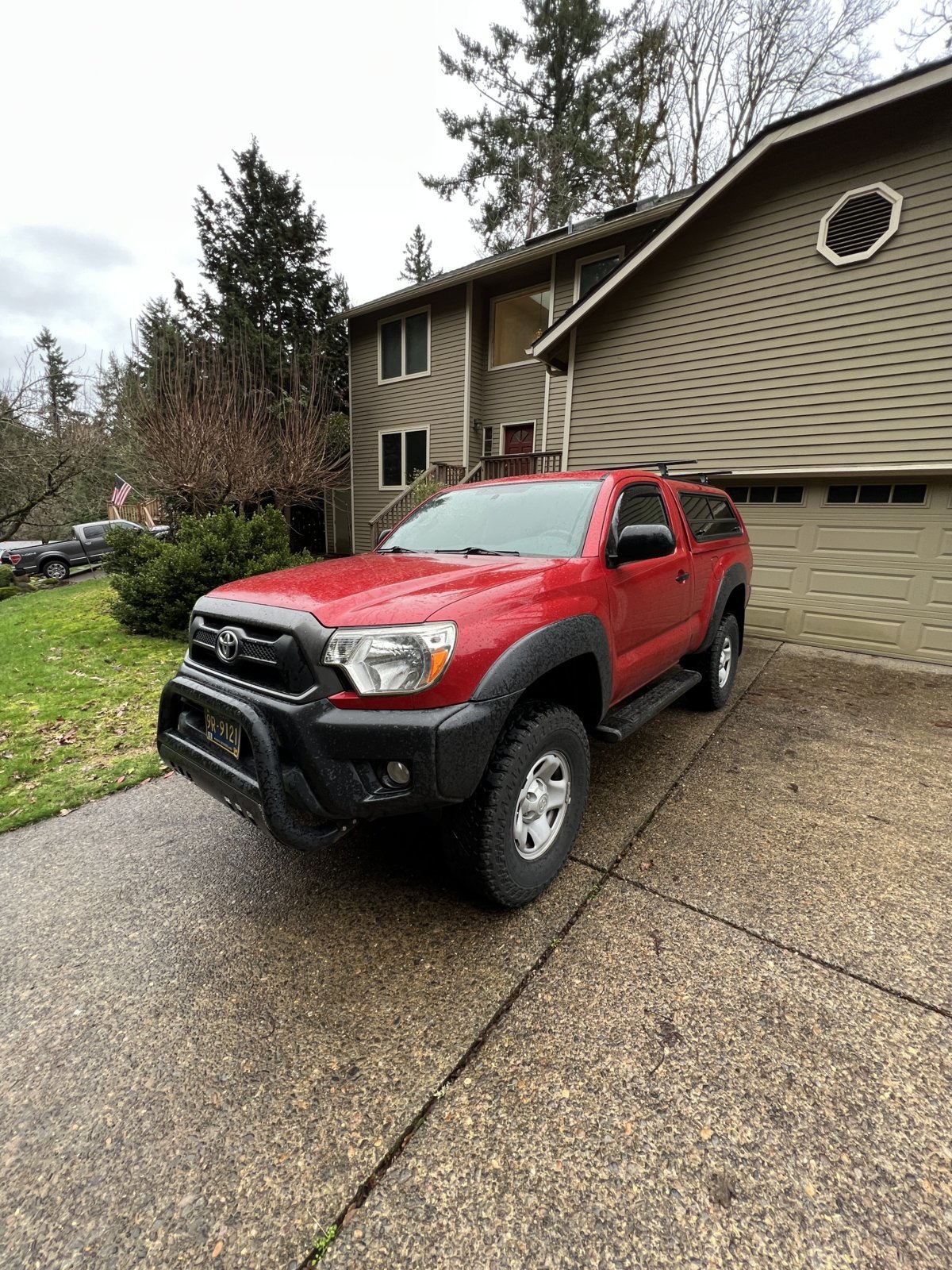

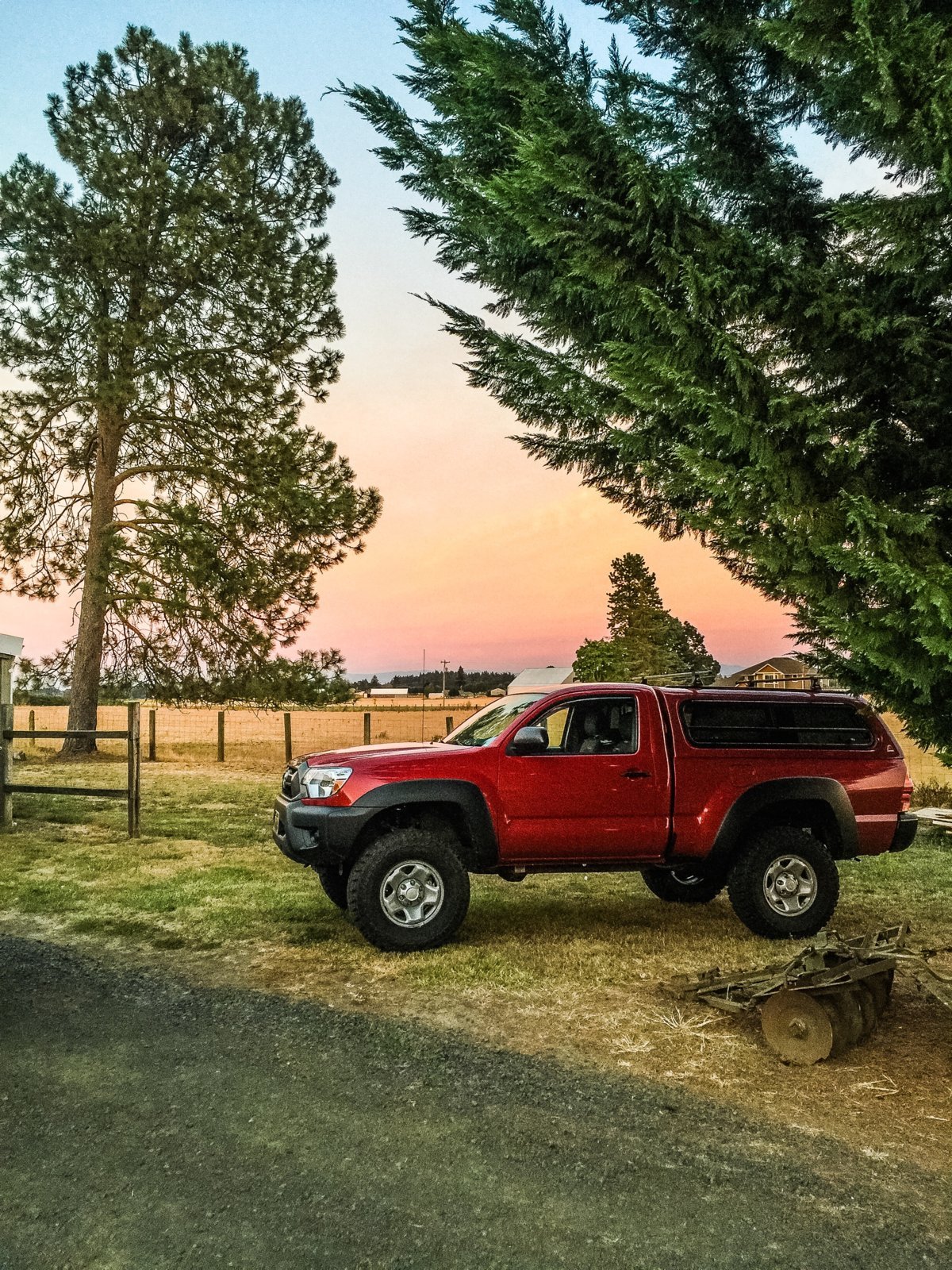

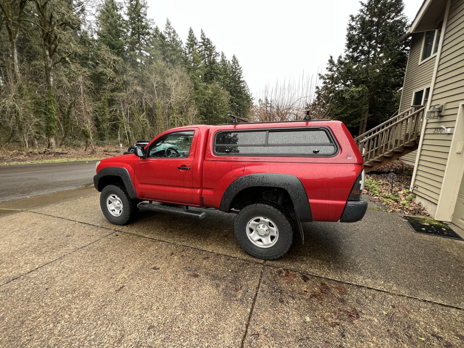

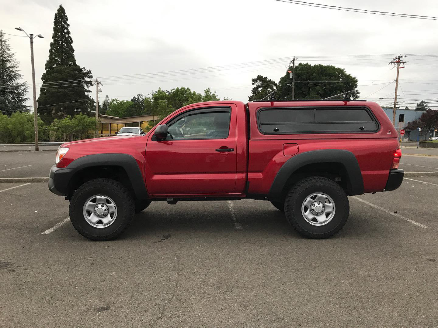

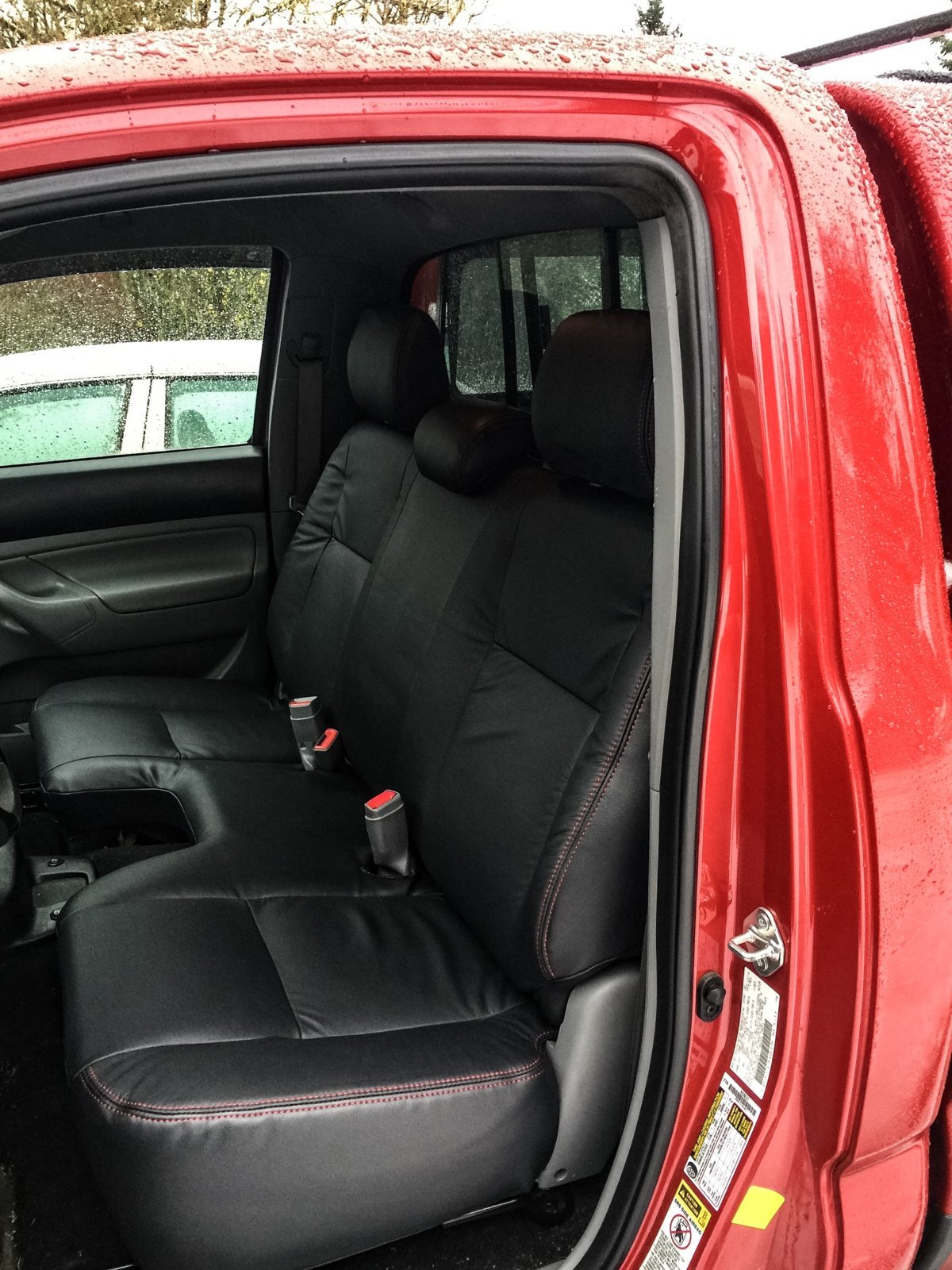

    Current update. Was able to purchase it back. Overall nothing has changed on the truck (same modifications I had originally installed on it) with the addition of the front bull bar and side steps which I will be taking off. Also, some cheap led taillights were added. I have some OEM Led ones that I need to put it. I will most likely make a build thread documenting the “rebuild”. Truck currently sits at 80k miles, I had sold it with 49k back in 2018. Needs some tlc but overall still in good condition.

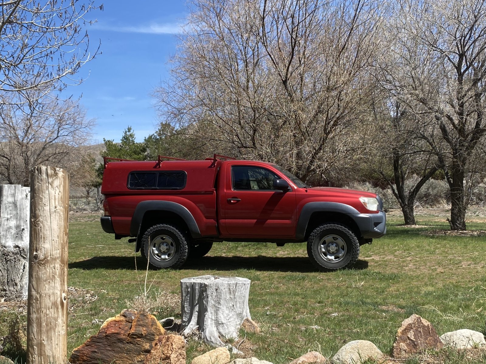

    Just helping out on the ranch. Just re-geared to 4.88’s. Love it so far, haven’t done any long trips, only 45 minute drives at the longest until I get some miles in before doing any long highway drives.
