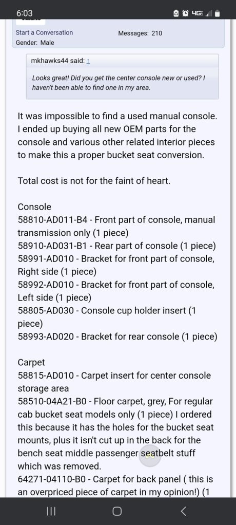

    Here is the part numbers for the manual trucks.

    I have the part numbers but looking at used parts on ebay all the ones I find say automatic and they’re a lot cheaper than a new manual one

    I had a hard time finding used manual consoles as well. So just bit the bullet and ordered all new.

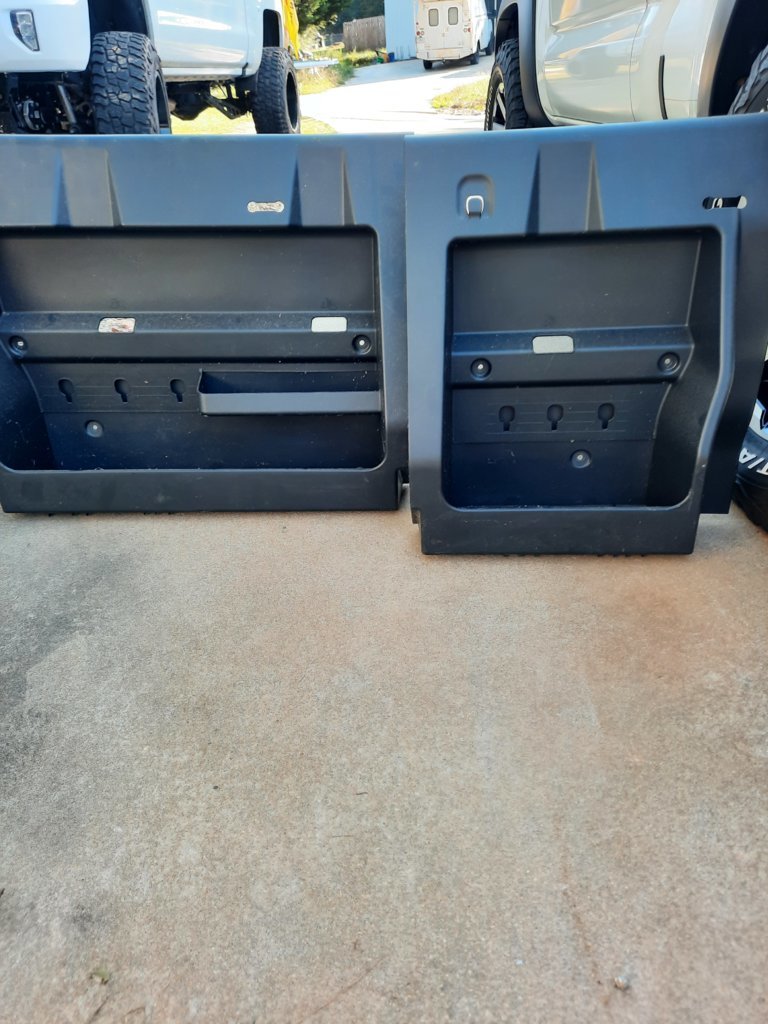

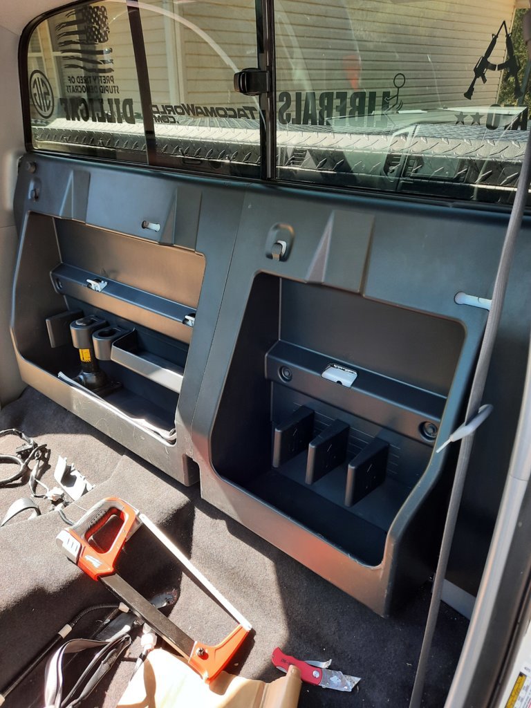

    Yesterday I took a 8 hour round trip to Murrells Inlet to pick up a set of double cab behind the seat storage bins and met TW member @MKW. Super nice guy and a Veteran. Well today I cleaned them up and got them installed. Happy with how it turned out, had to do a little trimming on some plastic so they would fit better. Also did some sound deadening on the back wall.

    3,272
    Murrells Inlet, SC
    2014 RC 4x4
    OME 3" lift MK6 wheels 285 Fierce MTs & 4.88s!!
    Looks great! Nice to meet you as well.

    looks great, I see you trimmed the vertical panels so the bins sit flush against the wall. One of the things that bugged me when I installed mine. I thought about trimming those pieces too but wan’t sure if I was gonna keep the bins or not. I had a hard enough time undoing the spot welds to remove the bottle jack bracket. I don’t like hacking stuff on my sweet truck but you did a great job. I might just cut mine

    Appreciate it. Yeah I had to trim it, I cut a little more than I probably should have, but it fits alot better. I just wiggled the jack bracket back and forth and it popped the spot welds right out.
