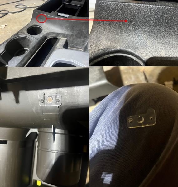

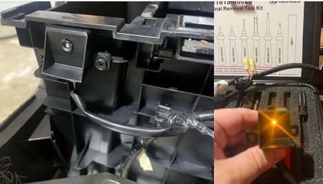

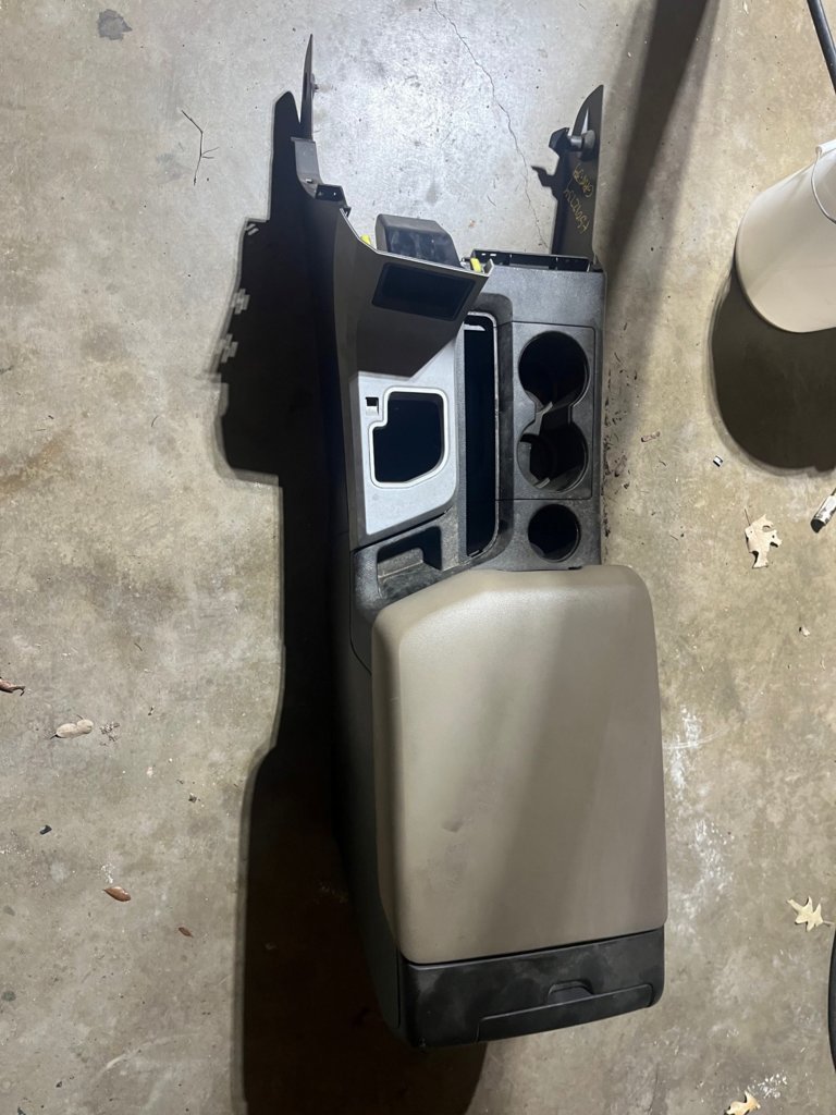

    I made some progress since I was able to pick up a used 2008 Tundra console from a scrapyard near work. There are a lot of these scrapyards around my work area but never been to them until now, was like a kid in a candy store.
    Before I found the 2008 console, I looked at some 2009 to 2013 Tundras and while they all had the consoles, none of those had the light I was seeking.
    I took it home and disassembled it.
    The console before I took it apart:
    Some disassembly photos and testing of the light. It looks like it will be pretty easy to adapt. I will post up a seperate thread with some part numbers when completed.

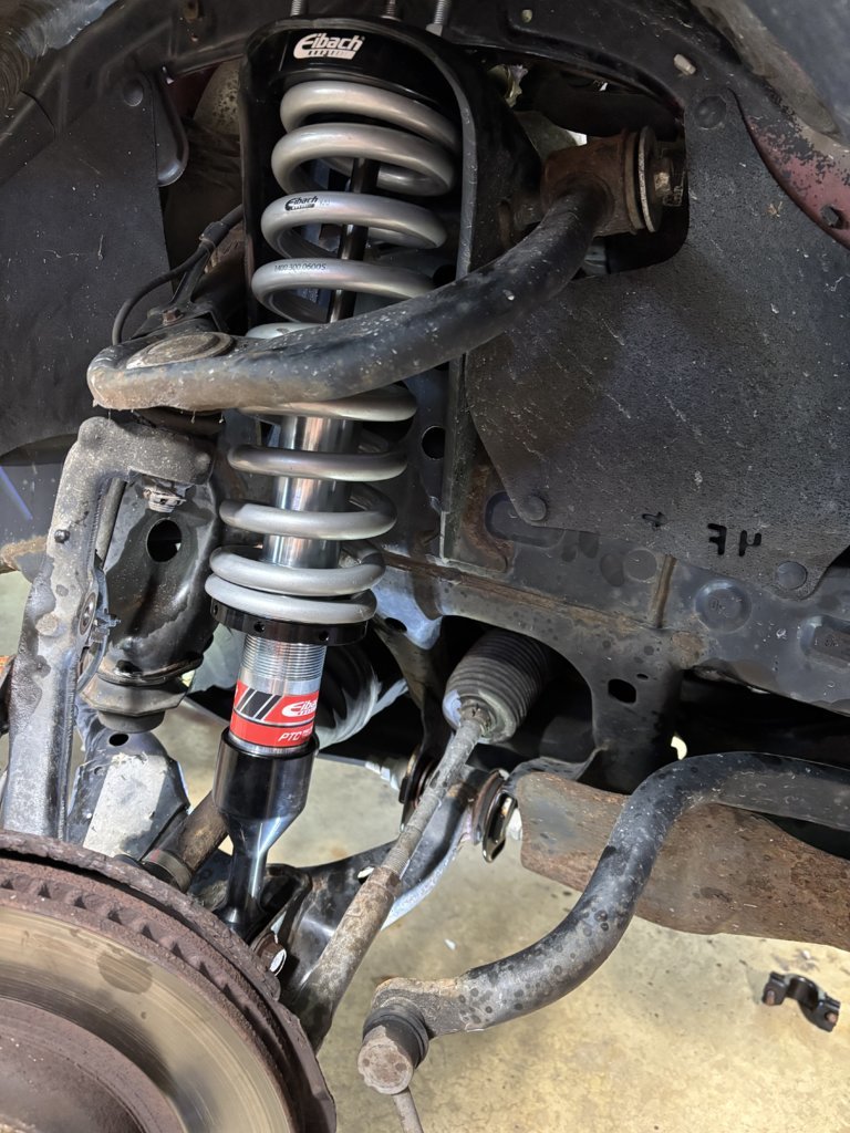

    The Eibach's and AAL are on and I'm afraid she's a little too tall for CV angles and whatnot. I don't have my exact measurements in front of me but I know I'm at 24" + hub to fender on the front. I can adjust the fronts down but I'm afraid I'll have crazy rake (I believe a truck should have rake but maybe not inches of rake). Also hoping everything will settle a little bit.

    Keep an eye on those add a leafs. Mine cracked after a year or two.

    Nice. Maybe I can find one at my local pull-a-aparts. Wonder if there is a part number for the light.

    I am pretty sure the light itself is 81080-48010 per diagram lookup but oddly, it doesn't show the bezel it clips into.

    I searched it, that is the correct number, just wish it had the wiring pigtail.

    The wiring harness that I removed from the console has a part number on it. It has a connector that goes into the light but it also comes with two other connectors which are for the two DC car charging ports in the Tundra console. I just unpinned and removed the specific wiring for the light only. P/N for the harness is 82166-0C110.
