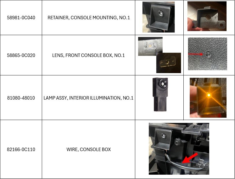

    I am thinking I will just tap it into the one of the lights connected to the dimmer switch. I think it is green / green-white wire.
    Anyways, here are all the parts I salvaged and am using.

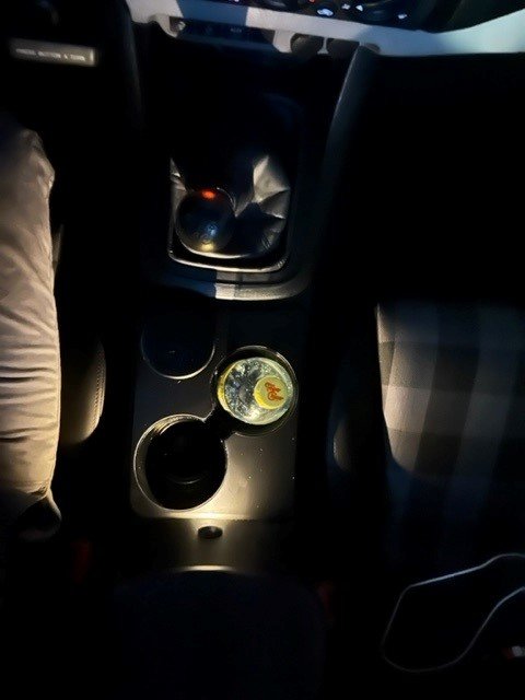

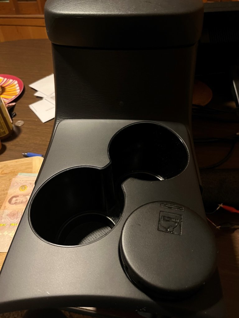

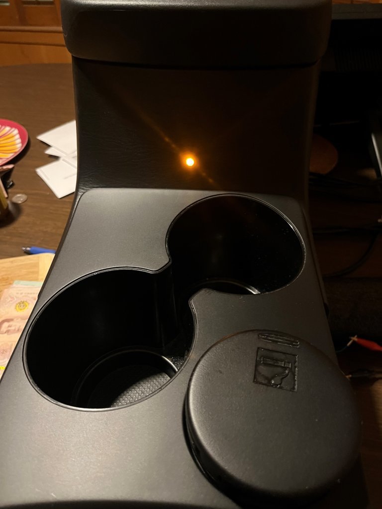

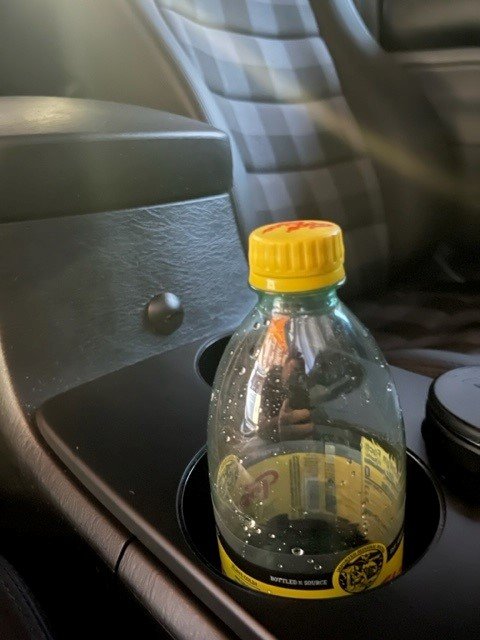

    I installed the lens and mounted the light. It is kinda hard to capture the full effect with the console in the house currently but here are the best pics I could take currently. I probably should have mounted it just a tad higher but oh well.
    It is barely noticable with it off just like it was in my old 2007 Tundra. No one knows it is there until the light is on.
    Tip: I used a 7/32 drill bit for a perfect fit for the lens.

    Nice. I assume it's only 2 wires? How are you planning on wiring it in the truck?

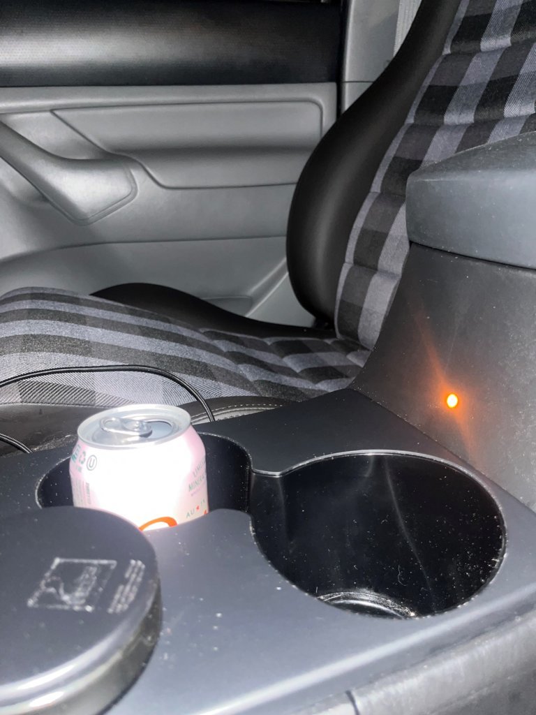

    The final result. I have mixed feelings about it because I felt I should have mounted it just a little higher but oh well. It works for me because I wanted a soft light that isn't overpowering for the small cabin of the regular cab.
    The cup holders being black is probably just part of the problem. I may try a little brighter LED down the road but I will swing with this for now.

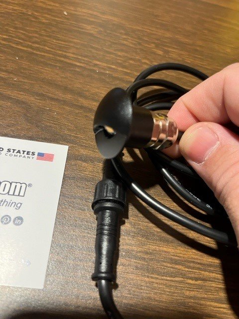

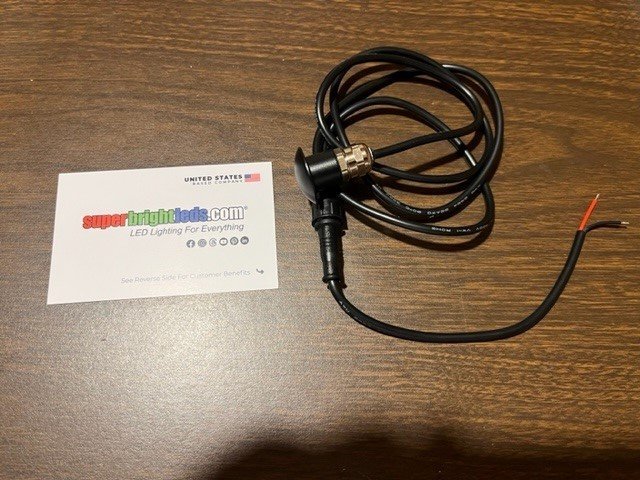

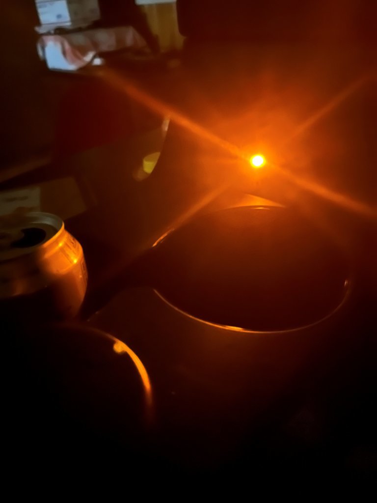

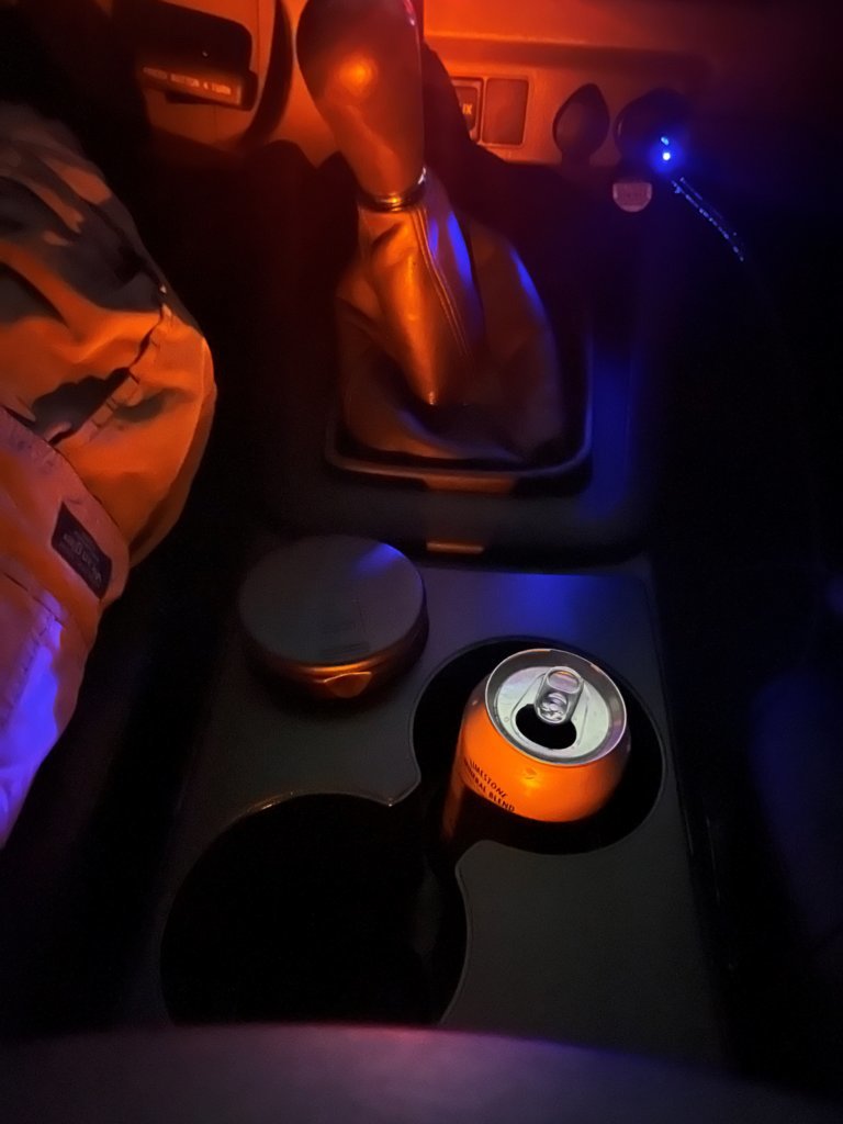

    I wasn't too thrilled with the initial OEM light that I adopted into my Tacoma console but it did work ok. I just wanted it to point downward more to the cupholders and not the cabin itself. It worked great in my Tundra though for some reason. I guess it was pointed more downward but I haven't had that Tundra for some time now so I can't really see what made the difference.
    I decided to order an non-OEM light. I am pretty big on keeping things OEM but in this case I had to make an exception since I couldn't go back unless I wanted to buy a new console box. The end result is much much better for me personally and it looks pretty OEM'ish to me as well. This light did require some further modification to make it fit as I had to remove the silver part of the back end of it or it would interfere with the console box. I used hot glue to hold all of the internals and wiring inside the housing after removing that silver part.
    I got the warm 2700K version here (I didn't want it to be too bright). https://www.superbrightleds.com/rec...000k-6500k+color-Natural~4000K+packamt-Single
    These lights are dimmable also which works with dimmer control.
    End result:

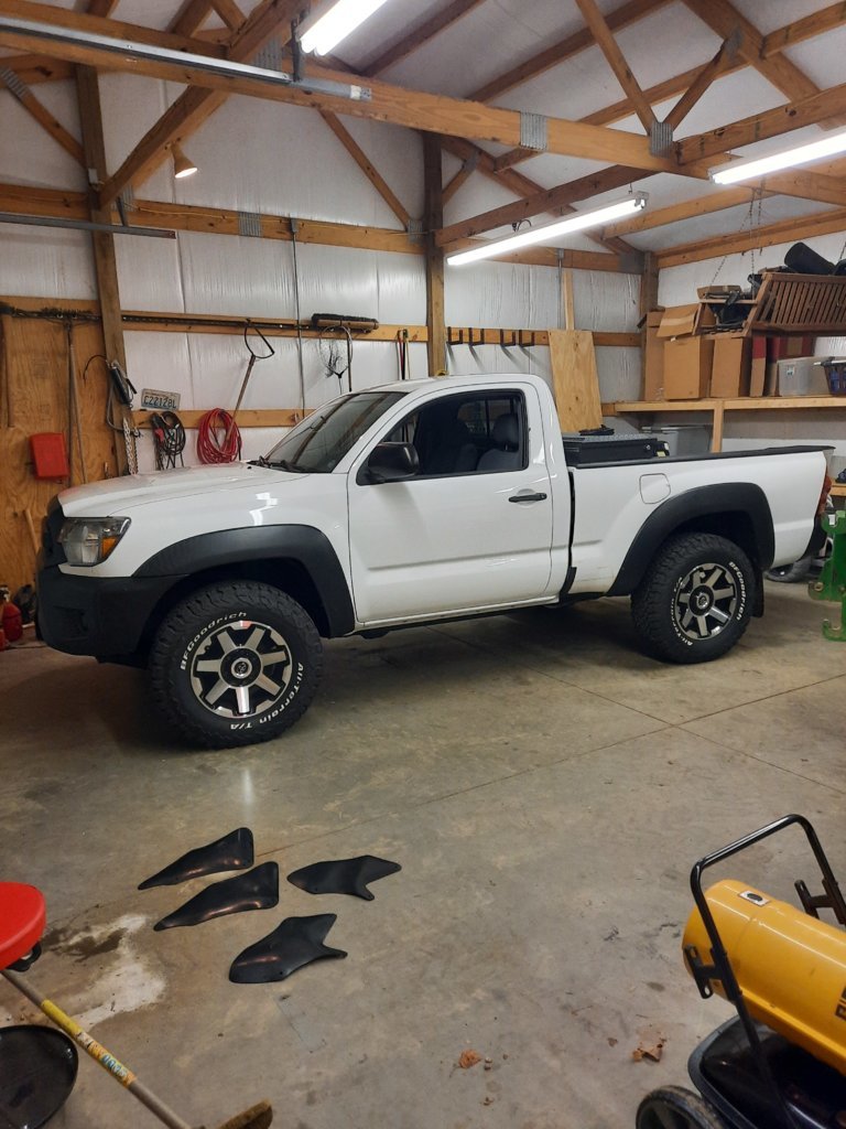

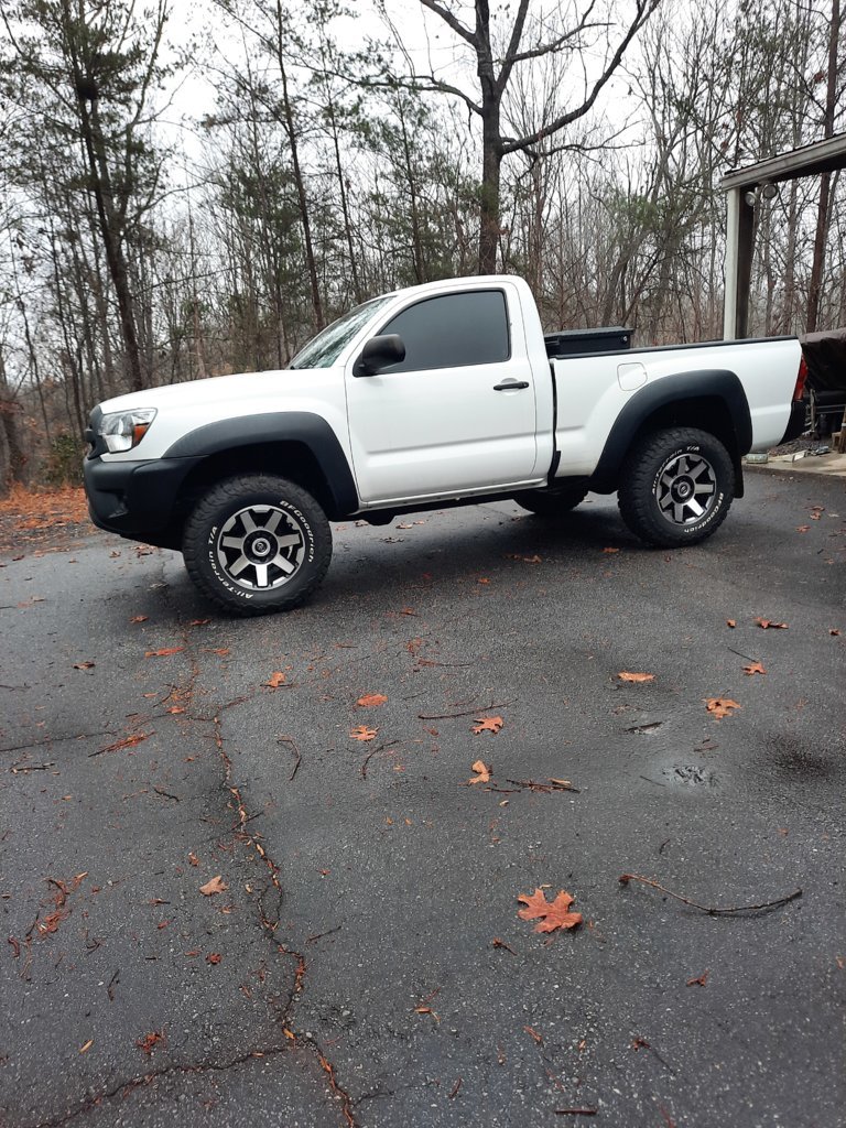

    3rd gen trd offroad suspension swap is completed. Added headstrong 1/4" spacers both sides and 1" block in the rear with archive garage ubolt flip kit. The ride is day and night better. Also installed the upper control arms and Radesigns inner splash guards in the front.
    Before.
    After.

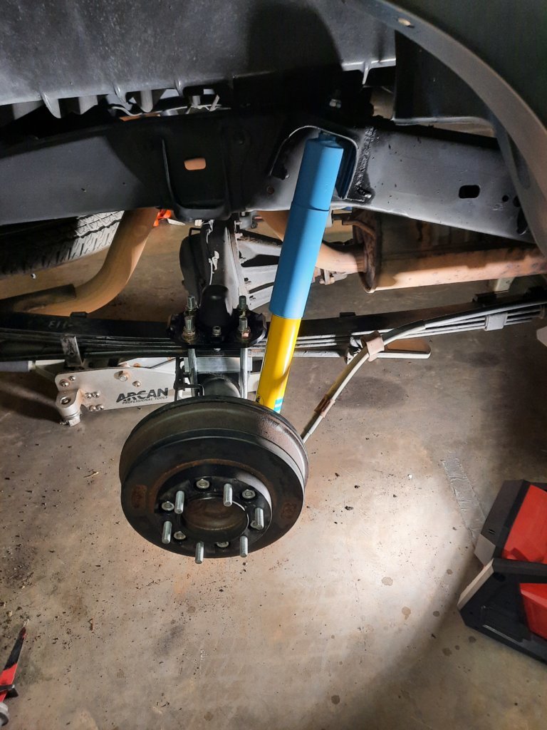

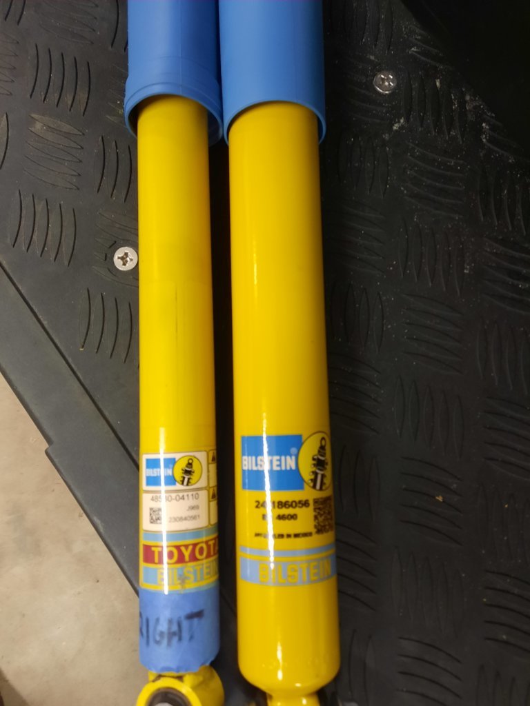

    Pic of the rear and trd offroad suspension rear shock comparison with a true bilstein 4600.
