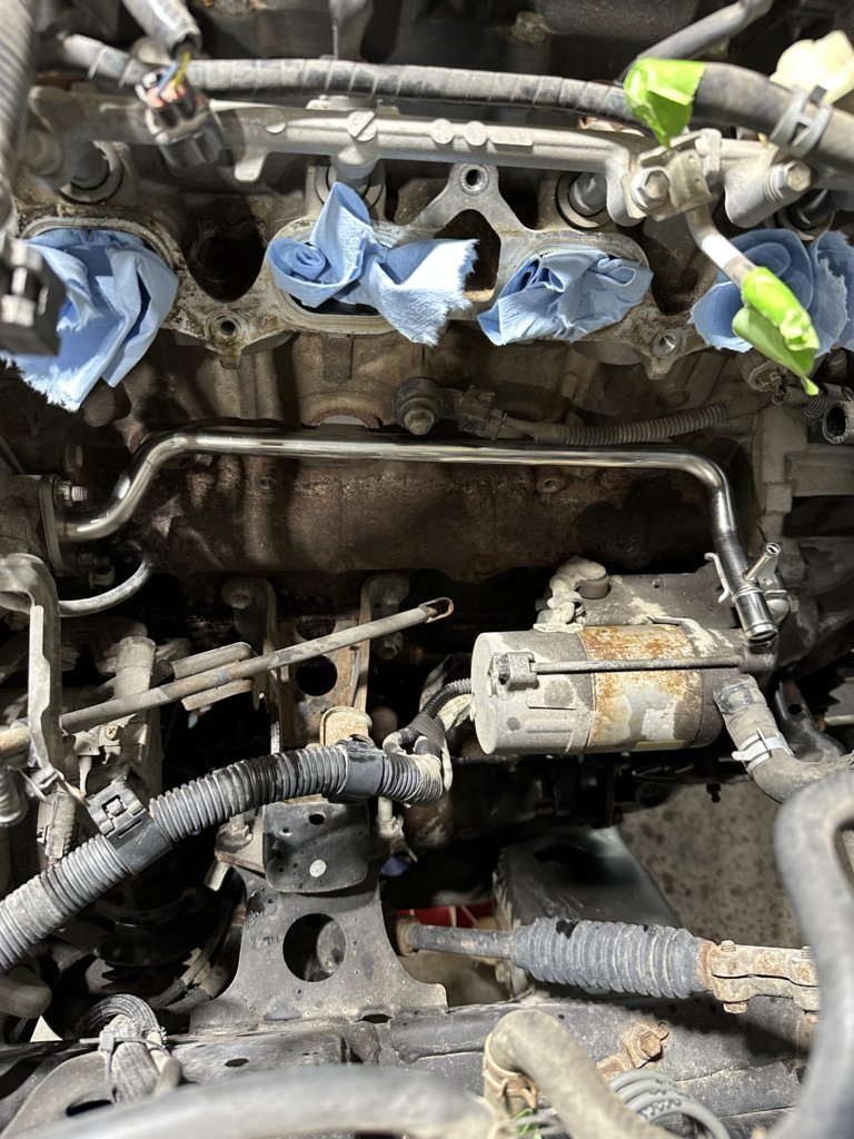

    After 210k I finally had to tackle this beast…
    Shiny new pipe:
    When I pulled the old pipe with the leak, I expected it to fall apart like others have stated. It did not.
    This was a total bear to do. Mainly the ventilation hose on the back of the manifold. It does not like to go on. I also did the radiator hoses and fought the clamps on those for a while lol.
    Bottom manifold bolts were very tricky to thread also, having to use a series of extensions to reach and hope the bolt doesn’t fall into the abyss somewhere.
    rcn, Nickkos taco, 69 Jim and 3 others like this.

    210k miles that’s got to be a or close to a record!
    While I did the pipe I replace every hose that antifreeze flows through! Also did the belt, thermostat with a stuck open safety and I believe 15 degrees lower temp and housing. The water pump, cleaned out at least a half quart of motor oil from the intake hosing. I found a really good small catch can to let the crank case vent so it wouldn’t keep filling the intake manifold with bypass oil. Replaced the gasket for the manifold & valve cover. And did a few other vacuum lines. Couple cans of engine cleaner and a bottle brush with a mix of Dawn and Simple Green. Then busted my knuckles for about a half a day.
    Steves104x4 likes this.

    I'm at about that same mileage....not relishing this project but will knock it out when it comes to it.

    Don't wait, just do it. It's a lot easier when you decide when the coolant's going to explode out of your system. I had a lot of coolant leak out after not driving for a few days and I luckily noticed the big dried pink spot - otherwise you could overheat your engine really easily.
    I know things are difficult on a relative scale for different people, but honestly it's not too bad. Zip tie stuff like cables out of the way and I unbolted the fuse box to give myself more room to work with.
    I remember watching a couple videos and this helped:
    https://www.youtube.com/watch?v=XHT7JlICgLE&ab_channel=mjSchmidtMedia
    Although I only changed out the pipe and nothing else (will do other stuff with a water pump in the near future though).
    Jacob99 and Steves104x4 like this.

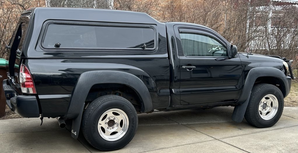

  20. Apr 1, 2025 at 4:35 PM
    Yotabilly
    Yotabilly Well-Known Member
    Oct 28, 2012
    #89984
    3,141
    The Bluegrass
    2013 4cyl,5spd.4x4 Reg Cab
    UWS low profile toolbox, tint, rainguards, color matched grill surround 265/75r16 Goodyear Duratracs Ultra-Guage XB fogs, Weathertech Floor Liners, OME 884s, 2"AAL, Bilstein 5100s, FJ Trail Team wheels, Matt123 skid plate, 30" light bar, Rigid Duallys, Bed extender
    I got mine out and washed it yesterday. It’s about to turn over 29k miles. Older pic IMG_6976.jpg
    It has a new sibling now. I hope it doesn’t get jealous. 2024 Ford F150 with Whipple gen6 stage 2 supercharger (785 hp). I hate that it’s an automatic (my first). The other day a Camaro reved up going by me. I went to push in the clutch to do the same then I remembered “Oh, I’m gray now”.
    Don’t get me wrong I like it, but if I had to let one go it wouldn’t be the Taco. The Taco is like my emergency vehicle. No matter the weather or terrain the Taco will go, maybe not quickly or comfortably, but it will. IMG_9213.jpg
    rcn, 69 Jim, Bikinaz and 3 others like this.
