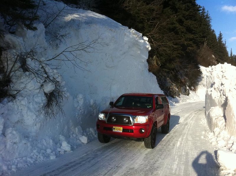

    here is a pic of my truck i took a few days ago

    This is the only pic I have of my '10, it has 13K and my mpg is staring to drop. Have been getting 20 in town but last 3 months it's been dropping to around 16-17. Any ideas as to what to look for? Oh...it is a 4x.

    Hmmm... Let's park next to where the avalance got dug out and see if it'll fall on it, lol:p
