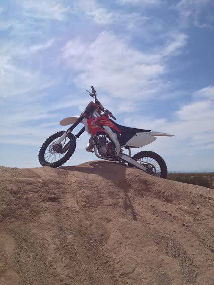

    ^^sex, i love the white fenders, i wish i had gone with white sometimes.
