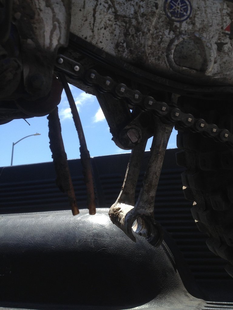

    well this happened yesterday.. Overshot a tabletop to flat yesterday at a track and thankfully i broke the linkage not my ankles.. Haha

    That 5hundy power :) what year/make is the chassis?

    noooo it was the 125 lol. the 500 is sitting till someone buys it :oops:
    this is a 2002 yz125
