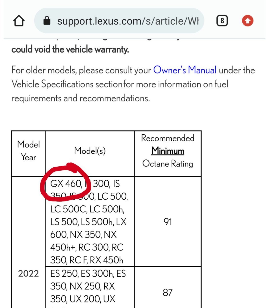

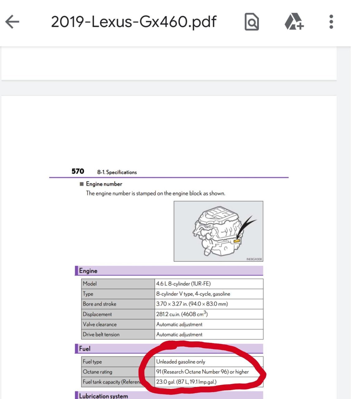

    Weird.. someone should tell Lexus to quit putting this stuff in their manuals and on their website..
    My comment earlier was based solely on octane requirements. I'd take the 4.6 in a heartbeat if I thought it would run fine on 87.
    Edit:. And, maybe it would run fine. I just don't know that for sure. And, I have fond memories of my 4.7. :)

    Doesn’t mean it’s necessary. The newer ECUs may just have a different tune to take advantage of it but you still have knock sensors so the ECU will pull timing enough to run fine on 87. Like stated before, maybe slightly worse MPG. But it’s still a low compression NA motor so I don’t know why you keep harping on it.

    Not harping on anything. I stated in my text above that my remarks were based on the required octane. If the manufacturer recommends 91, that is what I would use.
    Just because you say it will run "fine" doesn't change what the manual says, or how the engine is tuned.

    Same 4.6L v8 in the 2nd gen tundra is speced for 87....

    recommended, not required. And in the Tundras (same engine) the recommended fuel type is 87.

    I totally forgot that they used that in the Tundra also. :anonymous:
    I stand corrected.

    Its definitely possible that the Lexus tune is a slightly more aggressive tune that "requires" 91 to meet its claimed HP numbers. That stated, it seems like there are uh, typos in the manual for the gx460 as others on the web have noted the same discrepancy even though the tundra motor and GX 460 motor are the same.
